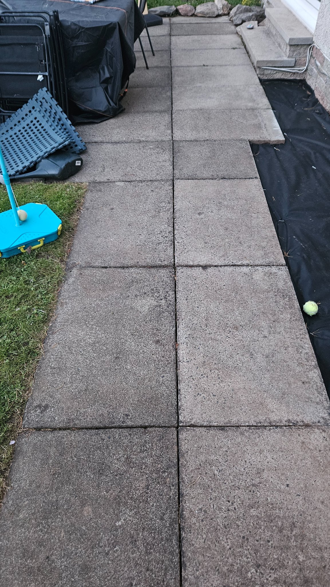

Can anyone suggest something I can do with the gaps in my patio with to stop weeds coming up between the slabs?
I had considered filling the gaps with mortar but there's not that much of a gap, if any in some places. Just enough for weeds!
Would a brushed in dry mix cement stop them?
Cheers

Weed killer, brush in kiln dried sand and seal with a patio/stone sealer fluid?

The gaps look big enough to me. Weed killer scrape out - I use a DIY wet and dry vacuum as well. Or a jet wash. Then - dont laugh but I use bodge tape and mask off either side of the gap and fill with WET sand and cement with added waterproofer, masking makes for a clean job when using wet and you can really trowel it in. I also add fibreglass choppings to the mix and then go over everything with a grout waterproofing sealer when its dry.
Yes a lot of work but I have found that a dry mix does not completely fill the gap - gets washed out and weeds actually take hold from above not from below. Mine lasts years when done as described.
