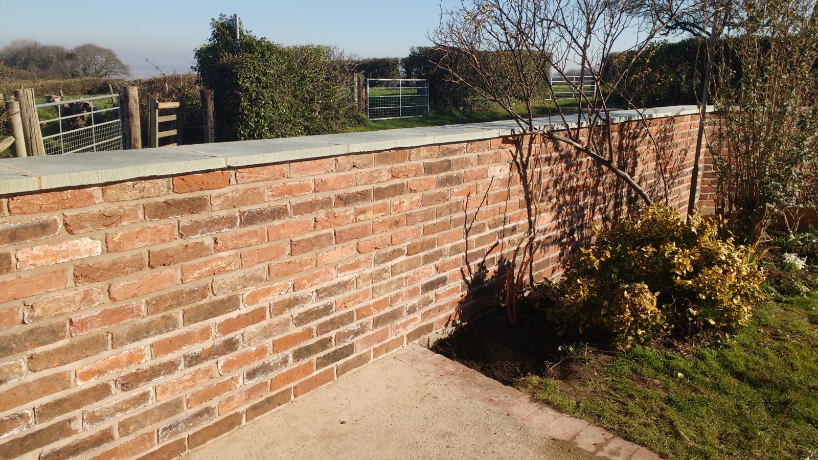

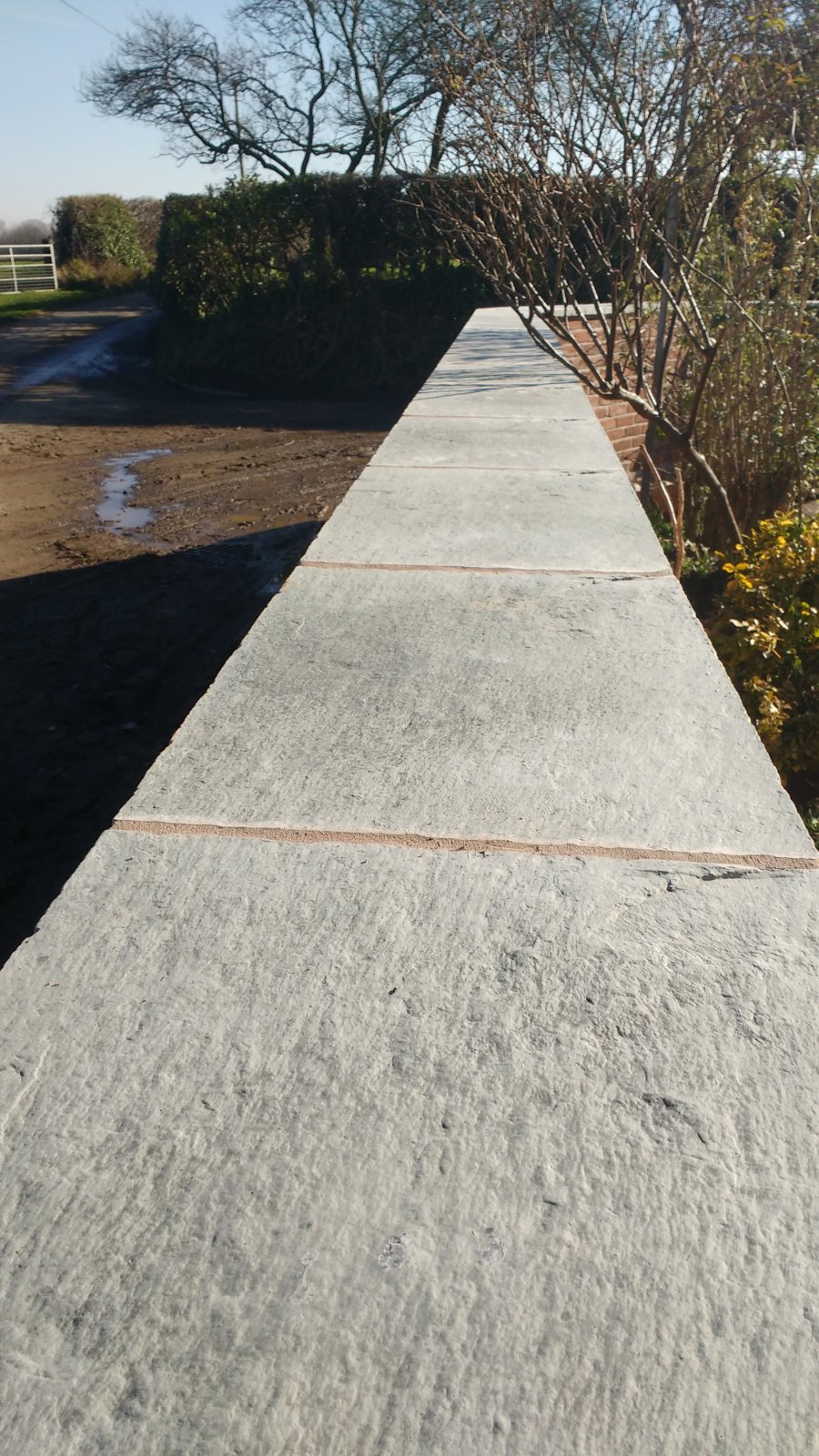

I'm back with the finished result, in case someone else asks the same question.
In the end I got paving slabs. And I think they look good. As I drove around for a month obsessively looking at walls, I realised that lots of people have used paving as coping.
These are Bowland, Lakeland - Cumbrian Slate colour. 600 x 400. They also do 400 x 400 and 200 x 400.
Looks splendid! Did you do it all yourself, including building the wall?
Don't think you will need to do anything to that for many a year, so money well spent.
Ha ha, I wish. No, we did the digging out of the old hedge and did the footings. And I had all the materials delivered here ready. Then 2 local lads came with mixer, plasticiser and barrow and did the excellent brickwork you can see in the photo.They did exactly what I wanted. All I had to do was brew tea. I couldn't be more pleased with the result.
