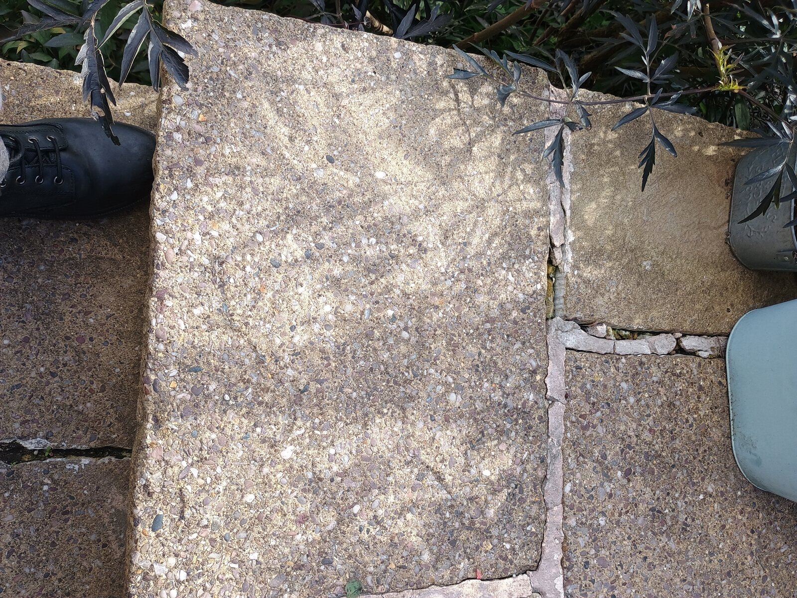

Hi all.
I need to reset a garden flagstone and also point between few gaps. I need a tough mortar and someone suggested using SBR. As this stuff is only available in 5 litre tubs - which I just don't need - I'm looking instead for any alternative ideas?
Use the tile primer as that comes in small bottle for about £7.50
Mix with cement and brush on the back.
Sand and cement at 4-1 ish.
Set slab on a full bed.
Is that what you are thinking?
Tile primer? Does that have adhesive qualities? Could you post a link to the correct stuff please?
