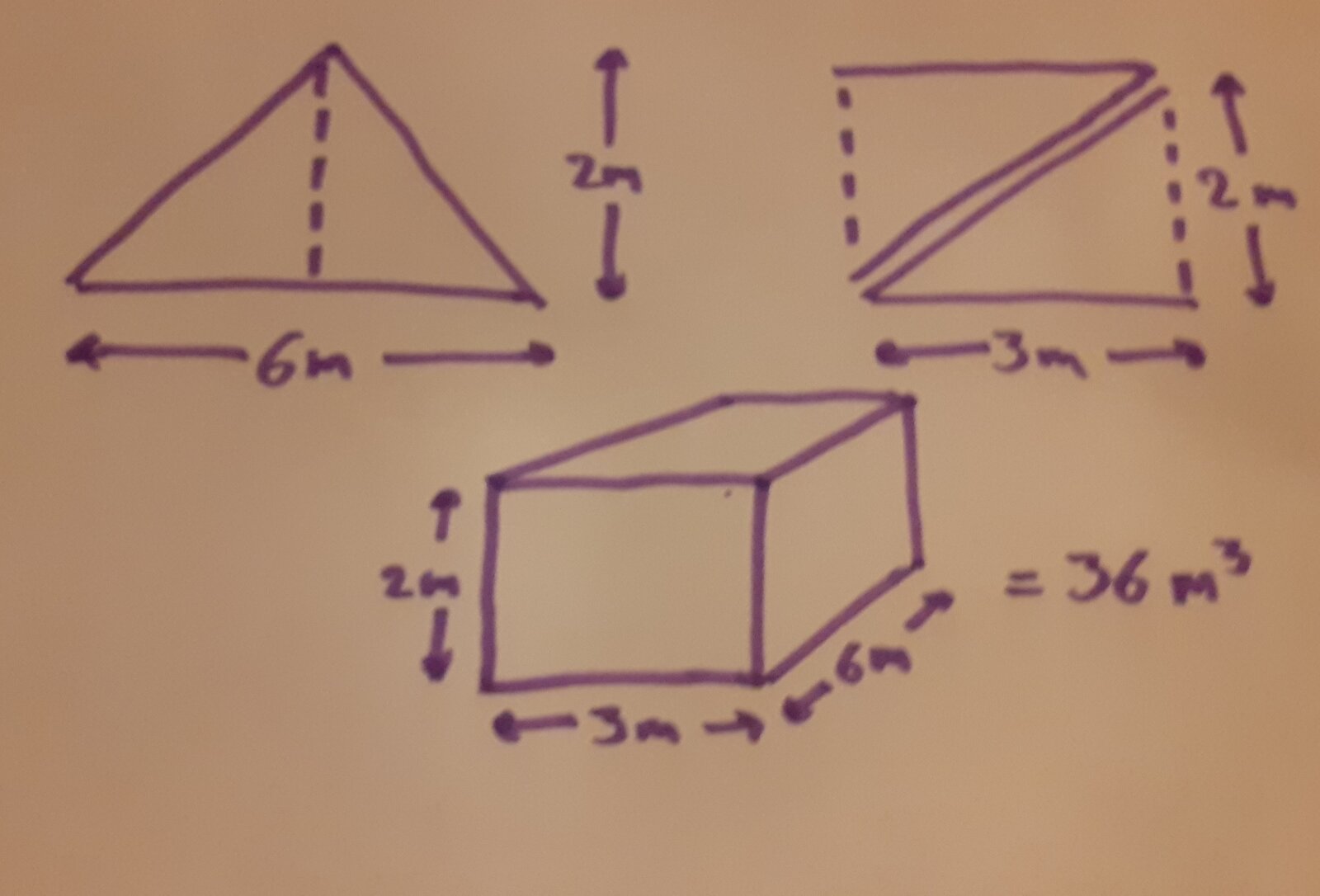

My next question is this...in building/planning terms are square metres and cubic metres the same?
My GCSE maths tells me that square metres is a measure of area (2 dimensional) and cubic metres is a measure of volume (3 dimensional) but our 'plan drawing friend' and 'Random Grinch' seem to imply that they are the same. I assumed that the height of the roof space would need to be included in the measurements, so our current loft would have a floor space of 6 x 6 m = 36 square metres, but would be 6 x 6 x the height in cubic metres.
Please explain if you can!
Many thanks.
Gotcha! Half base X height.
It's all coming back to me now.

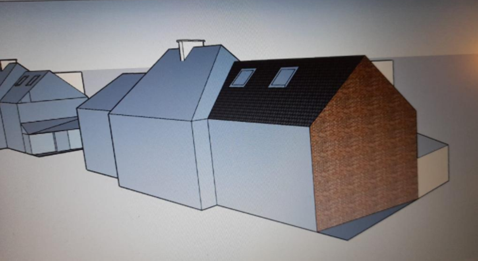

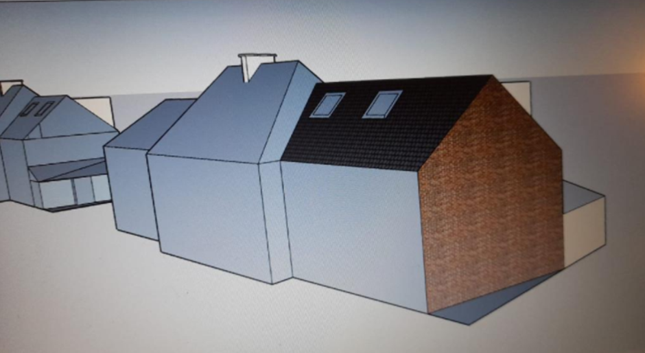

The planning officer from our local council has been quite generous with her time and has spoken to us directly to explain why our original plans were rejected. (We now know that they were never in a million years going to be accepted and we should have been advised of this prior). We currently have someone else discussing plans with us. He has done a couple of rough pictures on his computer software which we have sent to the planning officer who has indicated that this looks more likely and that she would like to see elevational plans for this option. What she did point out is that :
"The rear dormer is concerning due to the size. We have a policy (Policy 17 of the Part 2 Local Plan) which states that dormers should not dominate the roof slope and this would contravene this. It could be reduced (but significantly) and could be broken into two to reduce its size but if you think this would not give you the floor space required then I wouldn’t recommend exploring this option."

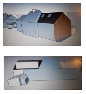

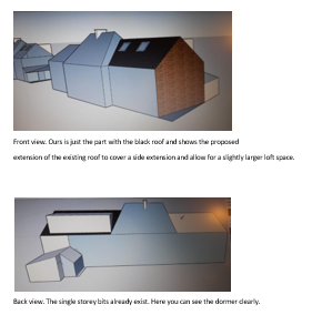

These are the pictures she saw:
Top is a front view (just the bit with the black roof is ours) and bottom is a back view where you can see the dormer clearly. It is pretty big, I can see that and it could be divided into 2 as there will hopefully be 2 bedrooms up there. My question is, will there be any kind of 'formula' or measure of size that will determine what constitutes "domination" of the roof slope? I'd rather make changes now before paying for elevational plans.
I have spent a number of happy hours simply googling images of Dormer loft conversions, and this kind of size looks fairly usual. In some of them the Dormers are just massive! And isn't it likely to dominate the roof slope anyway? Hope someone can make some sense of this!

Our local planning officer has indicated that the rear dormer on our proposed loft conversion would need to be reduced in size 'significantly' in order to get planning permission following the guidance in the Borough Council 'Local Plan'.
Is it the case, that if we were to do a more 'standard' loft conversion under permitted development, we could have whatever sized dormer we liked? I have been to view a friend's loft that was completed December 2019/ January 2020 in the same local area as us. The Dormer is similar in size to our proposal and this wasn't any problem. Do building control make recommendations around deign, or just about quality and safety compliance?
I'm really confused. Still.
If you can comply with the rules and restrictions of permitted development, the planning department will not get involved.
Building Control will only be interested in compliance with the building regulations.
Why does your dormer contravene the local plan?

Just seems so stupid that we could keep the Dormer as per the drawings if we don't involve the planning dept. but they won't allow it if they are involved. Pointless legislation, and so completely subjective.
There are dormers similar to our proposed one all over the area. And it is rear facing anyway, so won't even be visible from the street.
Thank you for clearing that up - it is as I suspected.
Think we'll reduce the size of the Dormer and split it into two, and submit it. See what happens.
We probably stand to gain more room by extending to the side before converting the loft than we would lose by reducing the Dormer. Maybe. It's hard to tell until we get plans drawn. And I'm reluctant to pay to get plans drawn for something that won't be accepted for planning. Grrr!
