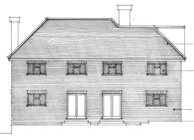

I am planing a 3 metre 2-storey rear extension within PD rules. I understand that no changes can be made to the existing toof. Does the image below look ok, particularly in reference to joining the new hipped roof to the gable end.
Black lines/white roof = existing. Yellow highlights/red lines show the new element.

The Council have told me that they are going to deny my Class B exclusion.
"we have concluded that the assessment should include Class B. In order to facilitate the creation of the two storey rear extension a portion of the roof form would be altered and the ridge height of the property would be extended. We consider that the proposed extension does not simply join onto the main roof of the original house. As a result of the increase in volume of the additional roof space, the proposal would fail to comply with Class B. I would suggest that the best way to overcome this issue would be to set the proposed roof down below the ridge height of the lower side element."
Slightly disappointed by their view. The guidance doesn't say that the new roof has to simply join the old roof. It just says that it has to join it. Semantics 1, me 0.
On a separate note, if I revise the drawings (attached) can I submit as part of this CoL application? Or do I have to withdraw my application & resubmit (starting the 8 week clock again)?

The Council confirmed that I can't resubmit drawings for a CoL and and have rejected it on the grounds that they view this as an enlargement of the original roof rather than just the new roof joining the existing old roof (and have therefore also assessed it under Class B).
