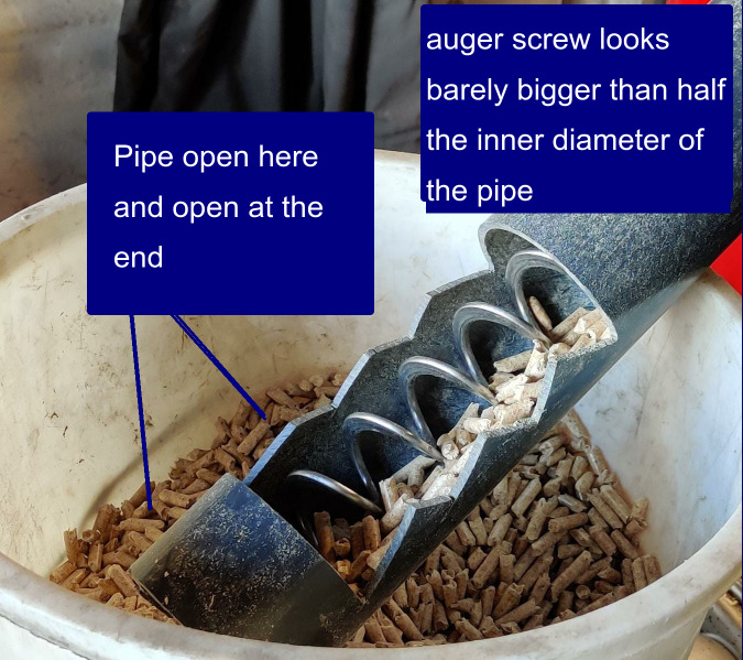

To any and all who can help... I'm in the process of understanding my parents' biomass system. The one part I can't get working is the pellet feed auger / screw.
It looks like the auger screw is way too small for the pipe where it's situated, and just isn't effective. I've tried setting it up at different angles - still no joy. The screw seems to pull up some pellets, but shift around in the pipe, and climb up on top of the pellets in the pipe, and just not bring them to the top.

It may be that the pellets are too small for that auger.
If the diameter of the pellet is smaller than the gap between auger spiral and auger wall then the uplift cannot be relied on,

The pipe and auger look to be commercially made items, rather than DIY, which suggests it should work. If that (in the photo) is the DIY hopper, then there is the issue. The auger and pipe need to go into the side of the hopper, so they are buried in the pellets. The pipe angle also needs to be fairly shallow, which may involve raising the base of the hopper.
It might not be a DIY pipe, but it does look a bit modified - the zigzag cuts over-shoot a bit.

No, this is just a bucket of pellets I was using. I was hoping I could find the magic angle where pellets would be able to travel up the entire length of the pipe - no joy.

Right, I missed that point. So I can assume you are manually dropping the pellets in at the bottom? So the auger should feed them up, if its design works?
In that case, it is as stated above, the pellet size which is too small.. Can you try it with something a bit larger as a trial?

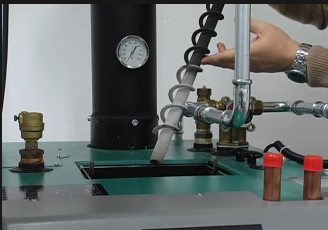

The second video on that page appears to show the actual auger. The auger has a tube down the centre, completely filling the space up between the blades - might yours be missing that?

I am almost certain it is just the tube down the centre of the auger which is missing, as I suggested above by the manufacturers own diagrams. The OP could simply test the idea with any tube which will fit reasonably snugly in the auger, even a bit of plastic tube should work.
If you mean this one here - that looks like a vertical auger, so a very different setup to mine... or was it another video?

This could be the situation, but I don't think so. I had it fully submerged (in the big drum) running for nearly 15 min without success. Maybe a nozzle/funnel on that pipe opening would also help. Think I'll contact the manufacturer to see if the parts look ok... here's how much space the screw has:
I think that is the one. The principle is the same whether vertical or at an angle - the pellets need to be prevented from slipping back down, via the centre of the auger.

The outer tube might be too large, but as said it looks like the pukka manufactured item, so should work. All of the feed hoppers seem to taper down to a point at the base, which the pellet auger should reach down to. Adding funnels should not be necessary.
