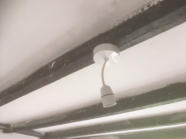

I asked the electrician to fit a new pendant light. I got back from work and found he's centered it in the room (which is to be expected), but hes fitted it to beam! Is this normal? I would have fitted it just off the beam (ie from the ceiling).

It's a matter of personal choice (and, sometimes, 'convenience'). If you had a preference, you really should have told him exactly what you wanted done.

The ceiling is just plasterboard. In other words, theres nothing secure to fit the pendant to. Or is plasteboard secure enough to fit the pendant to?
Well, ideally the rose should be fixed to something more solid (e.g. a wooden batten) above the plasterboard but, to be frank, if it's just a short pendant with a bulb/light in the lampholder, that represents so little weight that fixing it to the plasterboard (with appropriate fixings) would almost certainly not be a problem.

It looks a bit poo. Next time, pencil an x where you want a fitting to be placed rather than giving a vague on the ceiling type guide
