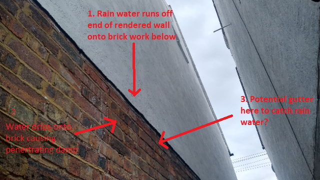

Gable wall on Victorian house has exposed brickwork from the ground up to about 30% of the wall.
The other 70% is rendered
I am getting patches of penetrating damp on the exposed brickwork
During rainfall, I noticed the following
1. Rain would run down the rendered wall
2. At the end of the render, rainwater water would run directly onto the exposed brickwork below causing damp.
To solve this issue.
Would placing a gutter (under the render) to catch the rain water be a decent solution? The water would run into a nearby drain

A gutter wont work and will look crap.
The render should have a bell cast at the bottom of it to cast water off the wall below it.
Point up any defective pointing and apply a silane water repellent if need be

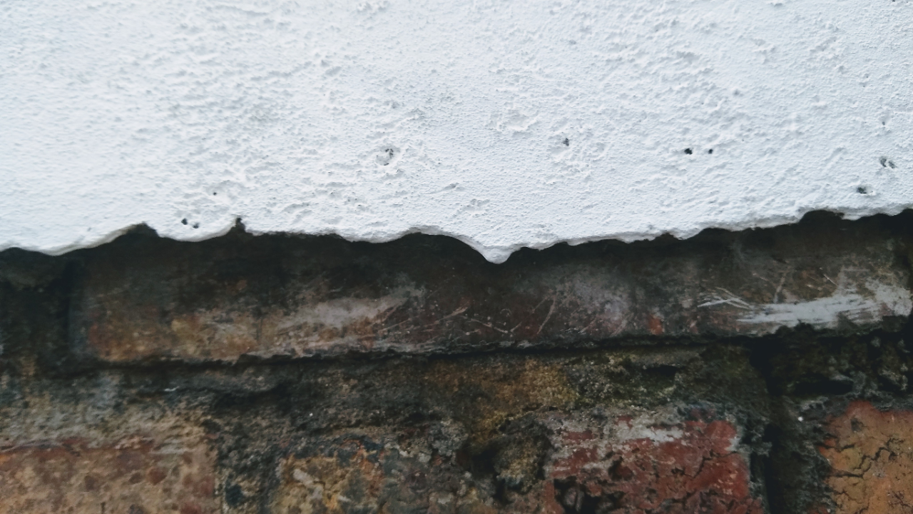

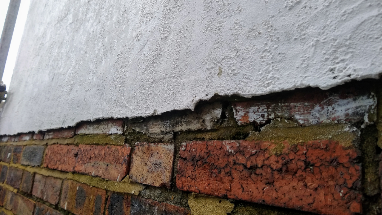

Doesn't look like I have that bell cast finish, so i will get that sorted

The damp on the inside leaf is only evident at and below the render line??
That is correct. Damp only appears to be present below the render line
Is this surprising? Were you expecting potential damp to come from elsewhere?
Yes I was expecting the evil that is cement render on period masonry to be the cause. Sounds like the lack of drip edge causing the rain water to 'pour' onto the brickwork is the cause as per above mentioned.
