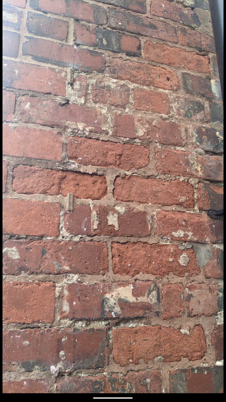

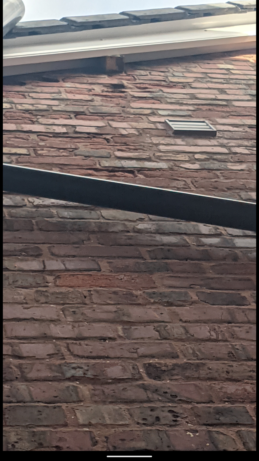

Thanks for reply @^woody^, I'm fairly certain it is just frost damage that has happened over 30yrs and not been addressed. The area is shadowed by another house and I think the freeze/thaw that has occurred over the years has caused the delamination. So- do you think the spalled brickwork needs to be removed & replaced prior to rendering or it'll be protected by the render?
I should add there are very similar properties on the road that have rendered and it seems to have resolved the issues.
Here's some pics-
To replace or to render over? or both

You may want to consider applying a facade cream/water repellent as an alternative to render. These can protect against frost damage.

Thanks for the pics, they are always useful. Internal pics would also help
to show what kind of damp damage you have, and where on what floors?
You have a cavity wall so in theory you shouldn't get penetrating damp.
However, there are a number of ways for cavities to be bridged.

The gable has been re-pointed in the past - not very successfully.
@tell80 The wall is solid- not cavity. The damp was on the first floor- it has now been rectified with a damp proof membrane and plastering so nothing to show. I certain it is the the 'sponge' like quality of the delaminated brick surface. Should I remove and replace said bricks (at a substantially higher cost I imagine) or just render over?

Good call, I was wrong but what is the lower pic? Is there an extension/outrigger butting up to the gable wall.
Tanking upper floors is unusual.
Given the neighbour's successful experiences with rendering, & the fact that you've got a solid wall, then I would go for render.
@tell80 I think its just a drain pipe! :D. The tanking/dpm was necessary as at the time the wall was too wet to dot and dab onto.
Thank you all for your help all- I'll go with the render. Fingers crossed I don't have to rip it all down a year later, lol!
Looks like a cavity wall tell80 as it's all stretchers, but I have worked on a property that was a solid wall built in stretcher bond.
Some surveyors call it a finger cavity, but it can have damp issues due to a hollow wall joint.
