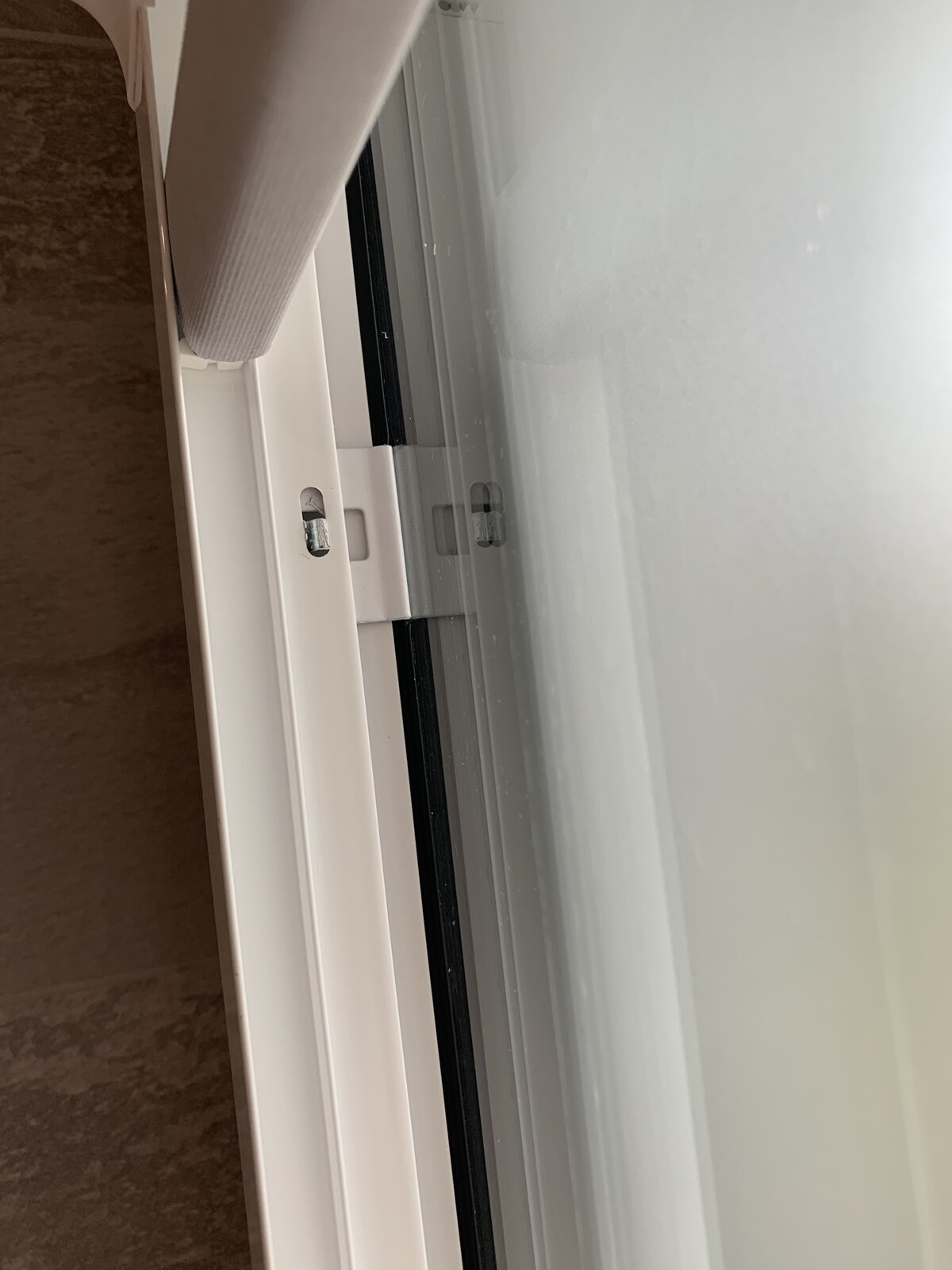

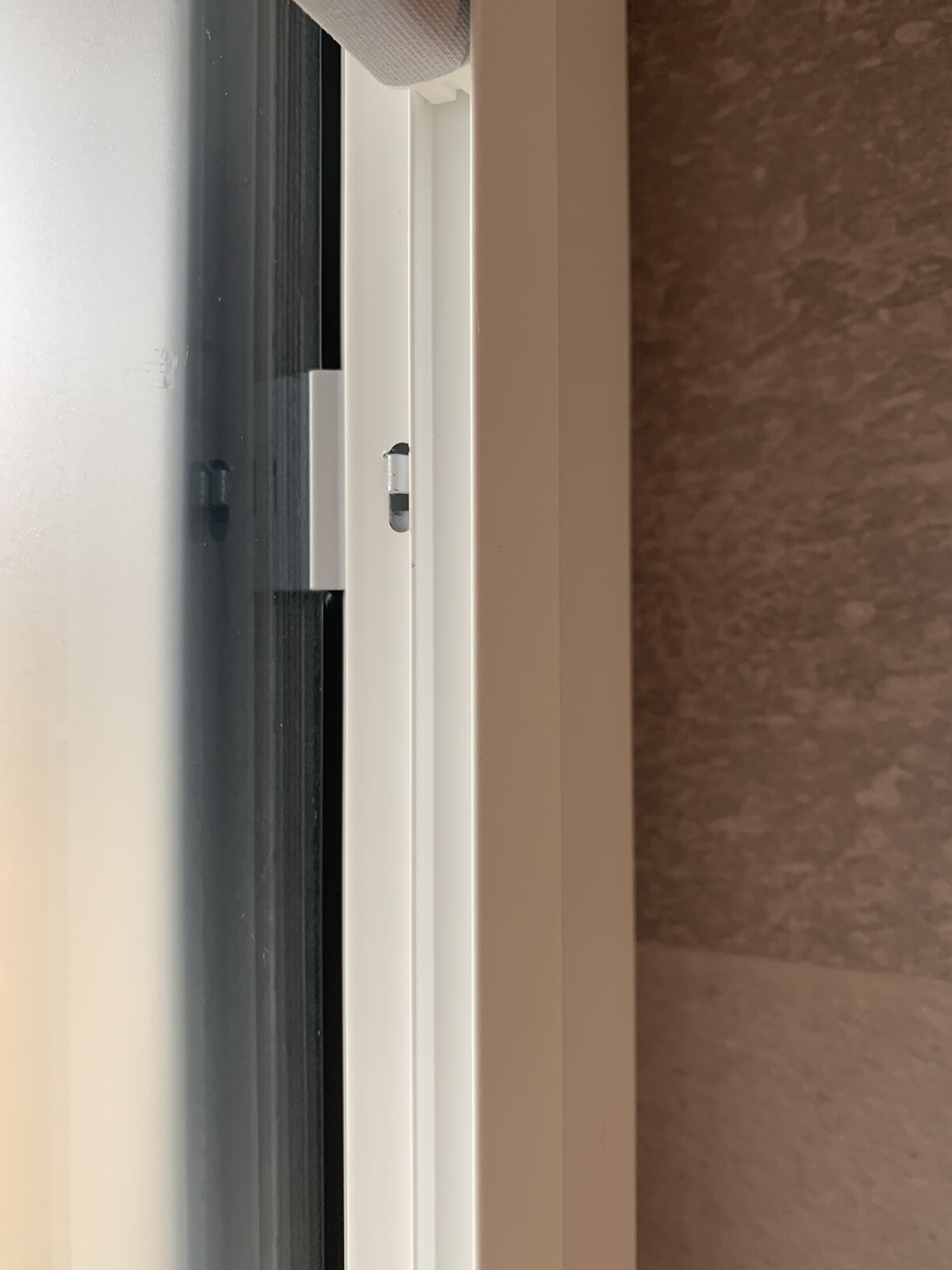

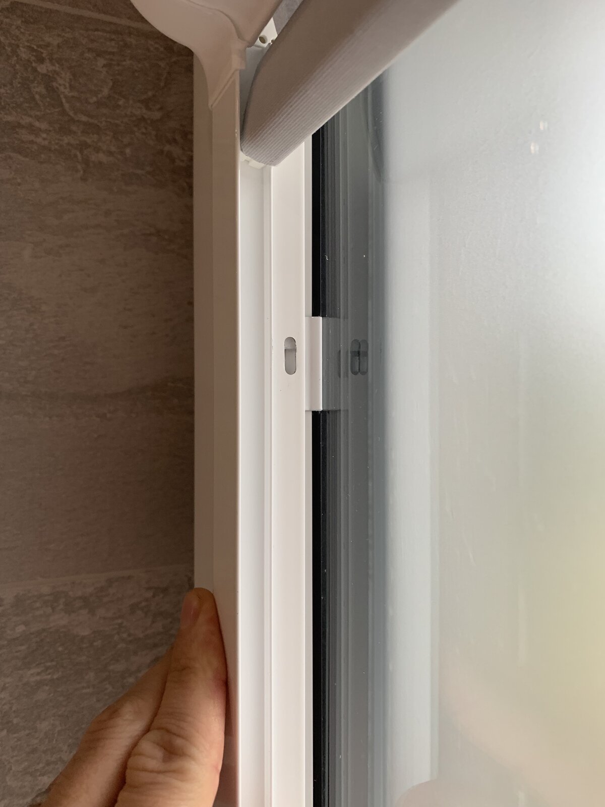

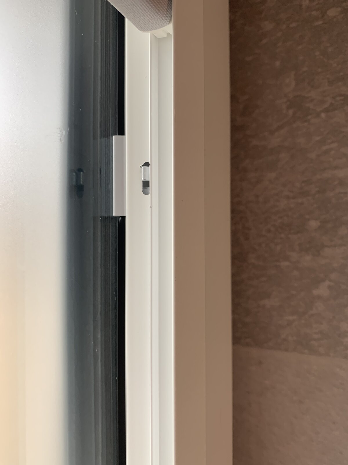

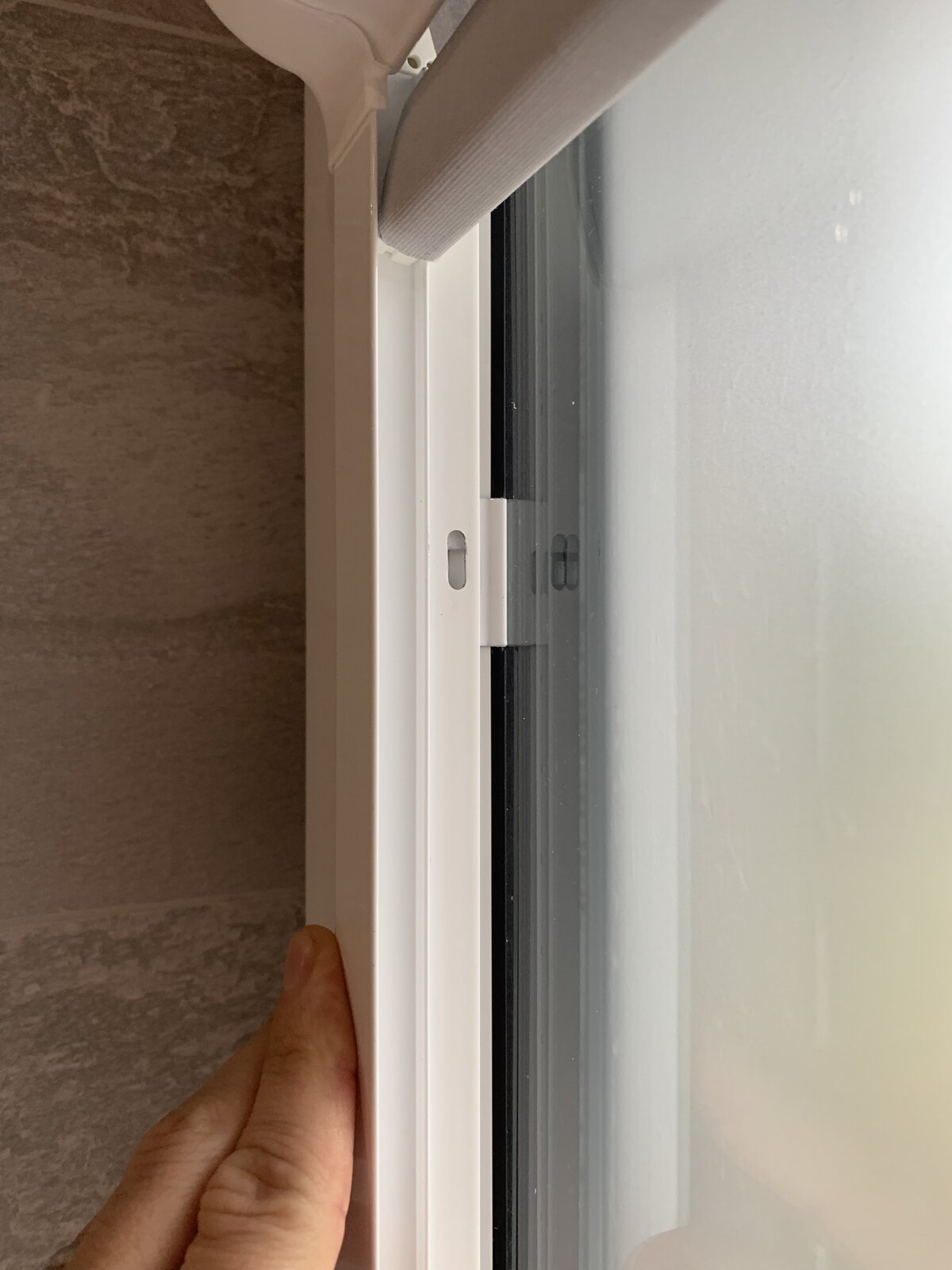

I have had this Perfect Fit Roller fitted 24mm brackets, the top left side is not sitting like the rest, see photos.
Photo 1 Top left not sitting right
Photo 2 How the rest are.
This is causing the top left of the frame to have movement back and forth. I never noticed it until the fitter was away and he isnt being of much help.
Anyone had this issue of know what the fix is? Is the frame faulty?
If I push in it the frame goes over the bracket stop, but just coming back out see Photo 3

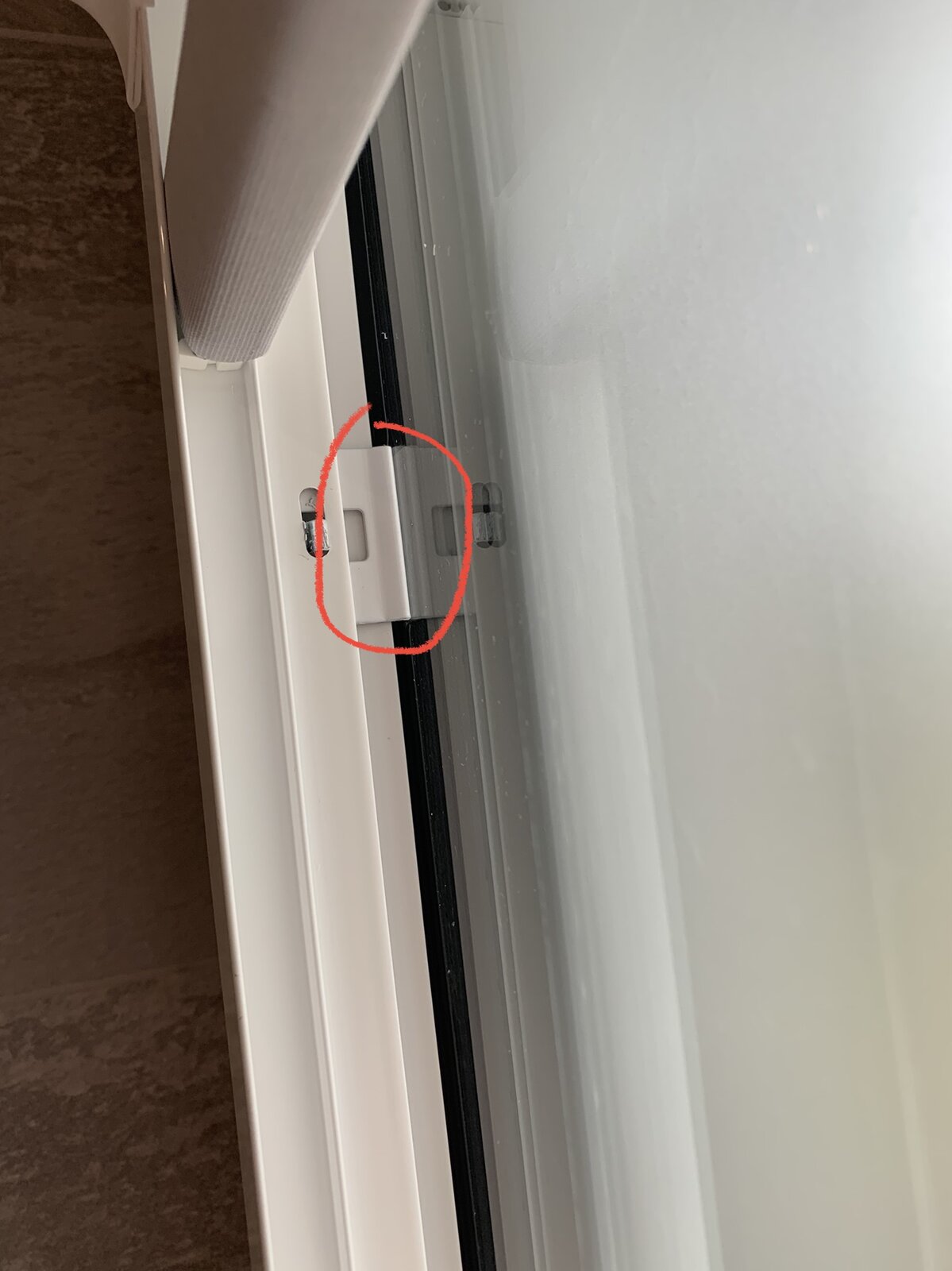

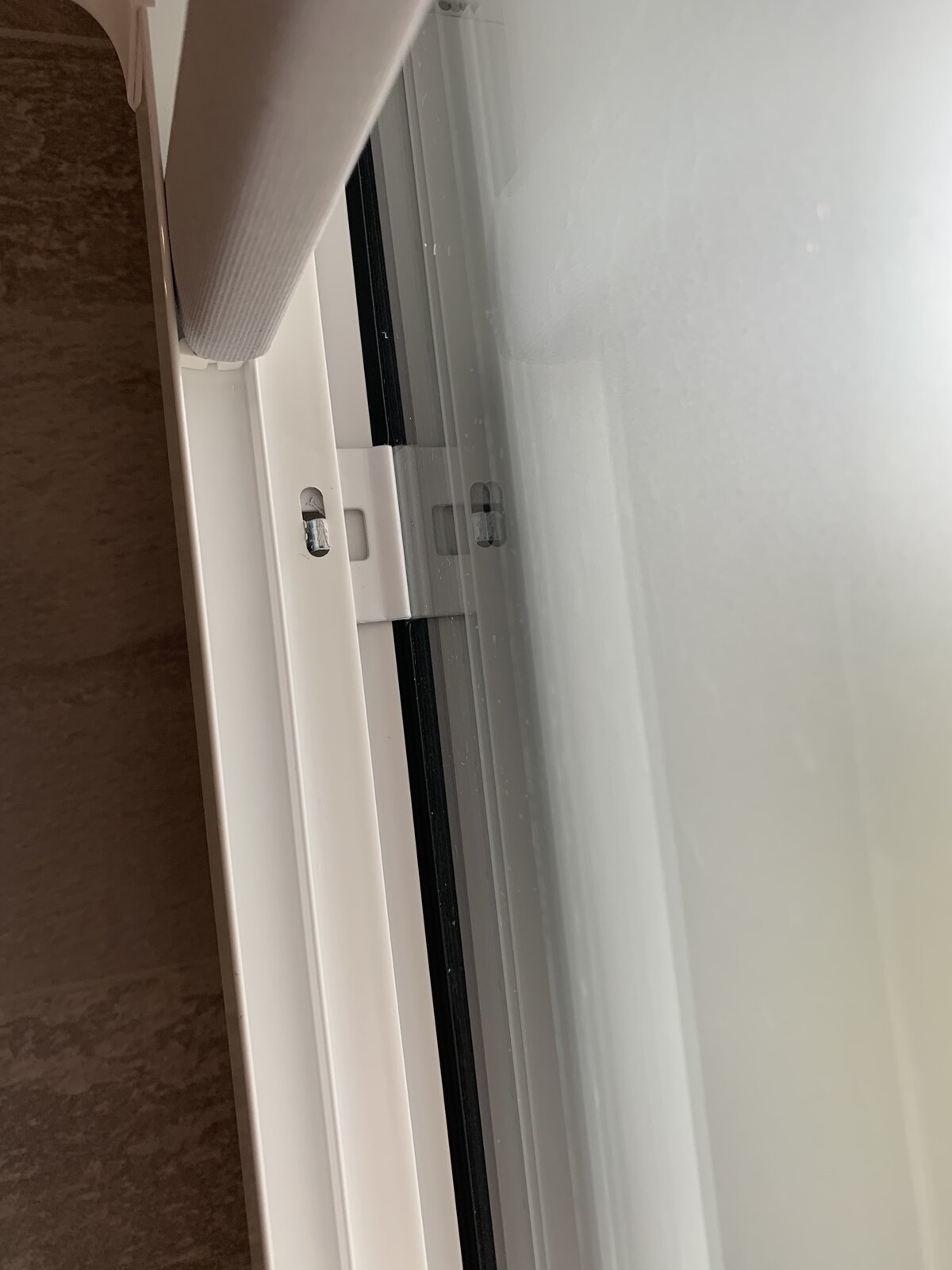

Look at Photo 1 and Photo 2, and look at the attached its sitting back see the red circled area
I've taken the frame off, and checked the brackets, Right side top and bottom is 22mm, left side top is 22mm and bottom 24mm!

the clip is miss-aligned or broken, removed frame and check.[Should be credit card space between top of glass and clip.]
Buy 4 new 22mm clips £3/4 on Ebay/Amazon, as foxhole said they do tend to distort i have fitted a few and you do get the odd clip that doesn't quite sit right.
However if the OP has paid for them to be fitted, the fitter should return to properly finish the job..
If the fitter is unwilling to return to finish the job, then the OP is entitled to a refund of the cost of the fitting.
Yes paid to have fitted as part of other works. I already meantioned the brackets are not all the same 3 have 22mm marked on these and 1 has 24mm marked on these, so that is obviously the issues.
These are not broken, misaligned etc
The fitter has fitted the wrong ones, must of been happy with the job even though there is clear movement on these.
