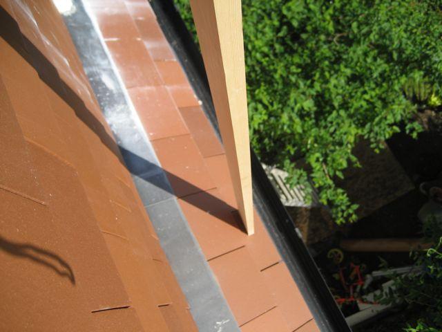

One of the questions asked was whether the stud rear wall had been set in sufficiently. Reading up on this it mentions a min 200mm from eaves. Even this seems to be a minefield of rulings but I'll put that aside for now.
Does anyone know where the 200mm are exactly measured from? The front of the eaves, the back, the house wall, including the guttering? OK, I doubt the guttering is included but it seems rather ambiguous.
I need to find the actual point of measure so I can verify whether the plans are sloppy or if this is yet another real issue coming towards us.

My interpretation of the 200mm rule is that it should be 200mm behind the front of the fascia board (back of the gutter). Its not something I've ever worried about frankly as a dormer with the wall sat there would look awful.
Where have you built yours in relation to the the face of the wall and the front of the fascia?
From the PP website...
• Roof extensions, apart from hip to gable ones, to be set back, as far as practicable, at least 20cm from the eaves
It also mentions this is to be measured along the roof plane.
I have "always" taken the measurement from the front of the fascia, which in its entirety... is part of the eaves.

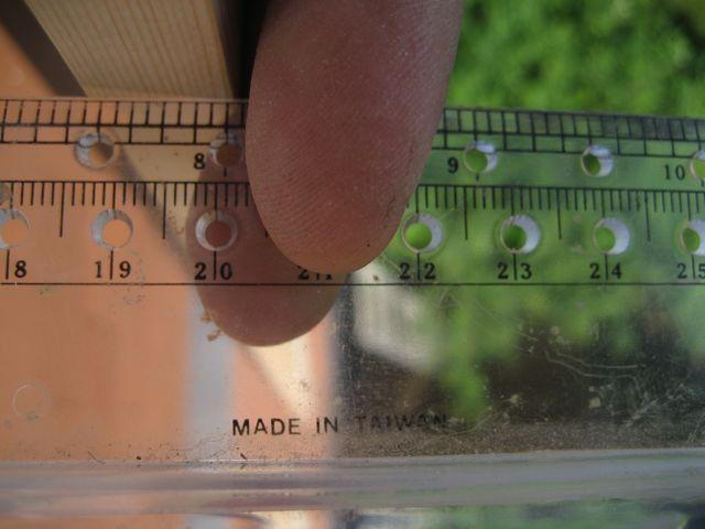

Our new stud wall sits virtually flush with the existing rear wall looking on sideways and 2 rows of tiles pertrude outwards to form the eaves as they existed before. Utilising the existing fascia that was there and that's a box of 13cm alone. Measuring just now (as possible) it's more like 300 if measuring from the last set of tiles forming the eaves.
So are you saying the new wall is 13cm horizontally back from the outer face of the fascia board? But 300mm up the roof slope from the leading edge of the last tile?
I would be gobsmacked that if (nowadays) Planning Permission were to applied for, for a dormer extension to sit in-line with the existing wall, it would be granted!
Sorry, pictures tell a thousand words ..... Basically if I take a ruler, put it against the back wall, measure 20cm and put a baton as a 'plumb line' I get something resulting like this .... So there is still some margin left to the outer edge of the tiles. OK, not much but still a margin ;)
Hence why that guidance document and others should be read in conjunction with eachother. It's not very clever that's it not included on the actual PP website though. I'm sure PP will sort it out one day :)

This was the reply from the officer:-
I can confirm that the set up is measured 200mm up from the rear wall and not from the eaves. During a previous appeal the Inspector at the time concluded that the 20cm rule is not measured from the edge of the eaves as is often argued by Architects and since then, we have been taking the same approach.
