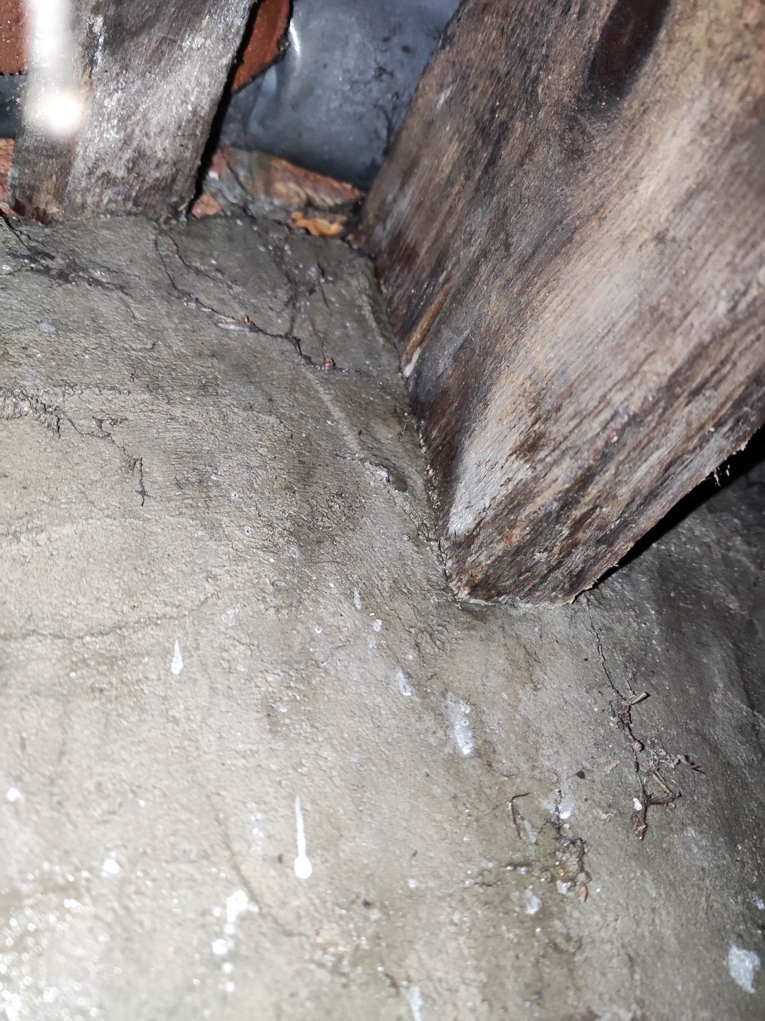

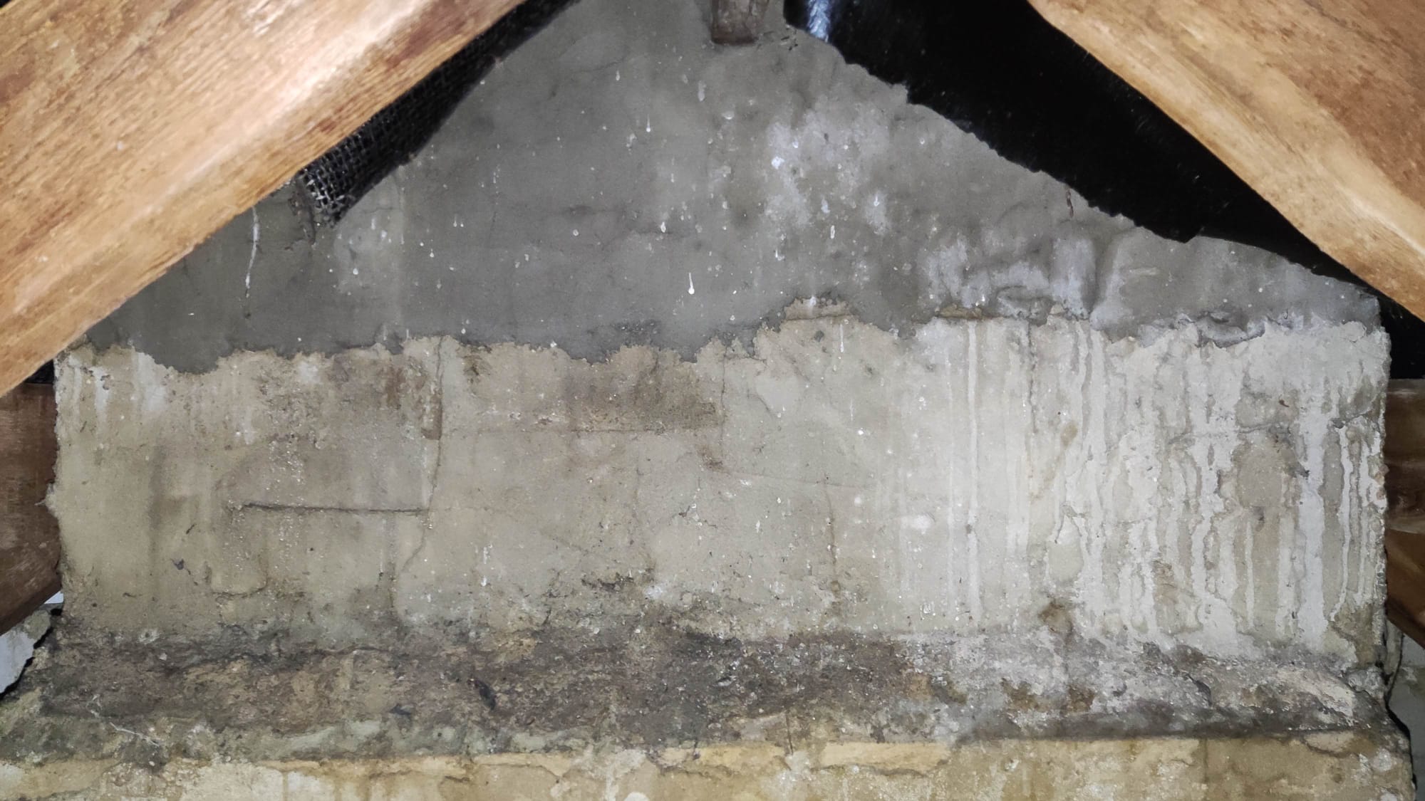

Since then it’s been fine in dry weather and over summer, but during winter, especially after prolonged heavy rain, water still gets in at one specific spot on the north side. The amount is small, but enough to soak the cement render covering the stack inside the loft. From there, the moisture transfers into the ridge board. I’m concerned that having the ridge board damp for several months each winter/spring will eventually lead to rot.
Questions
  1. Can I shorten or isolate the ridge board where it meets the chimney?
    My thought was to interrupt the contact between the ridge board and the chimney to stop capillary transfer of moisture. As far as I understand, the ridge board shouldn’t need to be structurally fixed to the chimney itself. Would it be acceptable to cut it back slightly where it meets the cement render, or is that a bad idea?

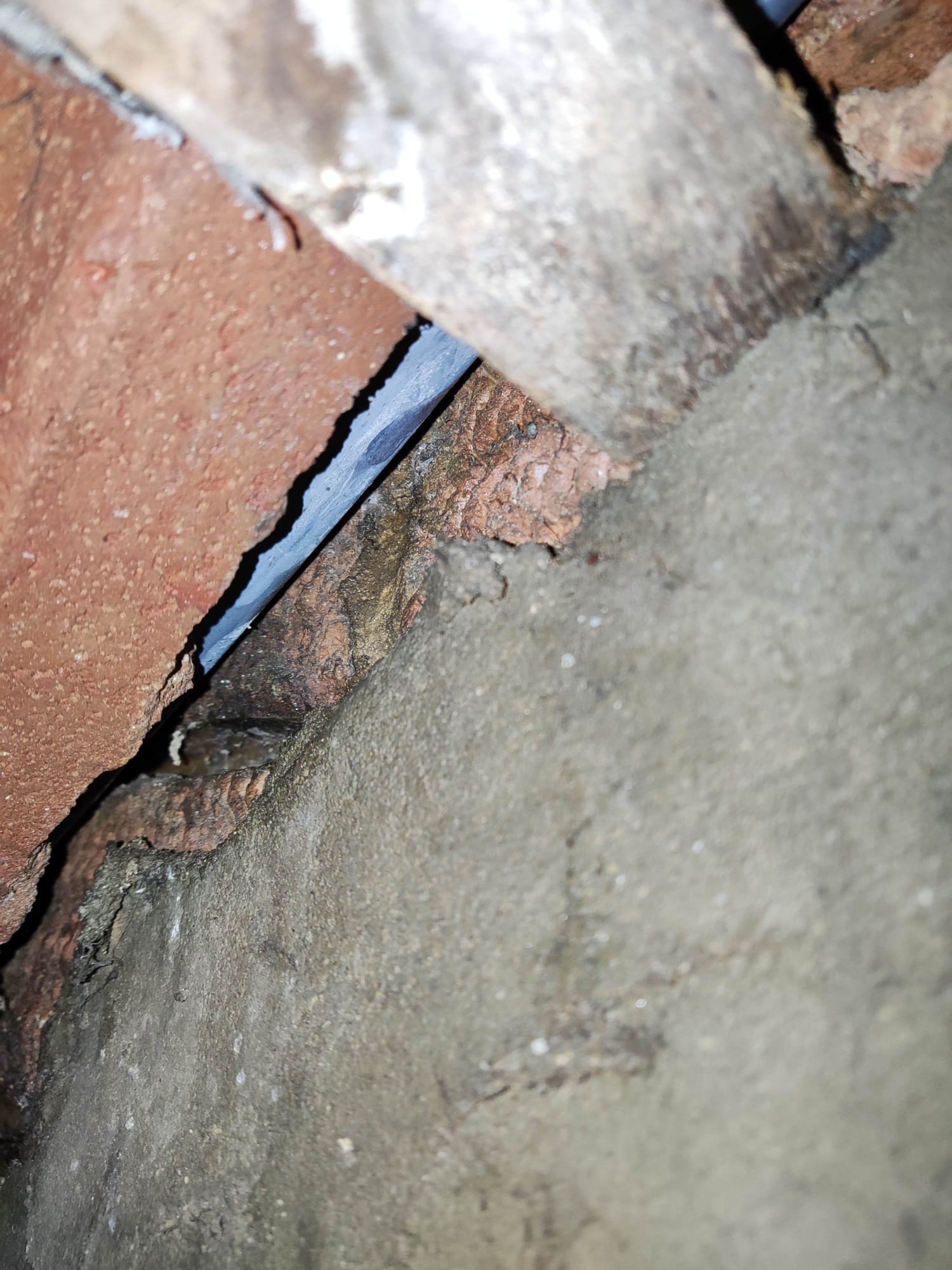

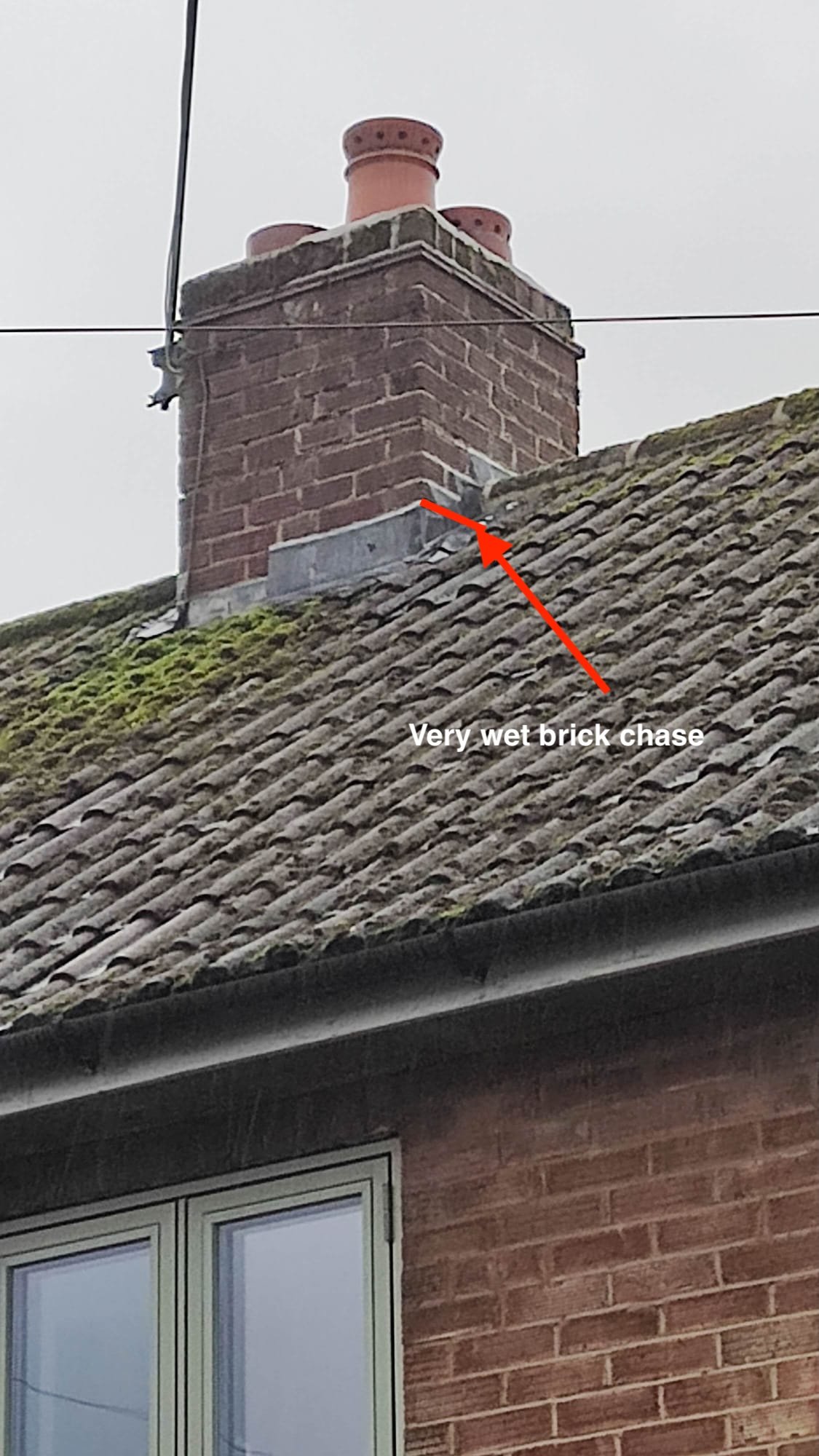

  2. Any thoughts on why it would still be leaking in one very specific area?
    The roofer’s view was that the next escalation would be repointing the entire stack. The roof is around 75 years old and will need replacing in the not-too-distant future, so it might make more sense to do that work together. That said, I’m not convinced pointing is definitely the root cause.
    The chimney stack is shared. Our neighbour hasn’t installed a chimney cowl, their flaunching is still cracked, and they still have the original lead flashing. They say they have no water ingress issues. Could water be entering on their side of the stack and tracking across to ours? If so, how would I go about confirming that?

After the last set of repairs in June 2024
Today - dry all around apart from water sitting inside the brick chase and running down the cement render
An inside view of the same spot, this was in 2024 before the stormdry. Still leaking today
The ridge board, embedded in the render and soaking wet

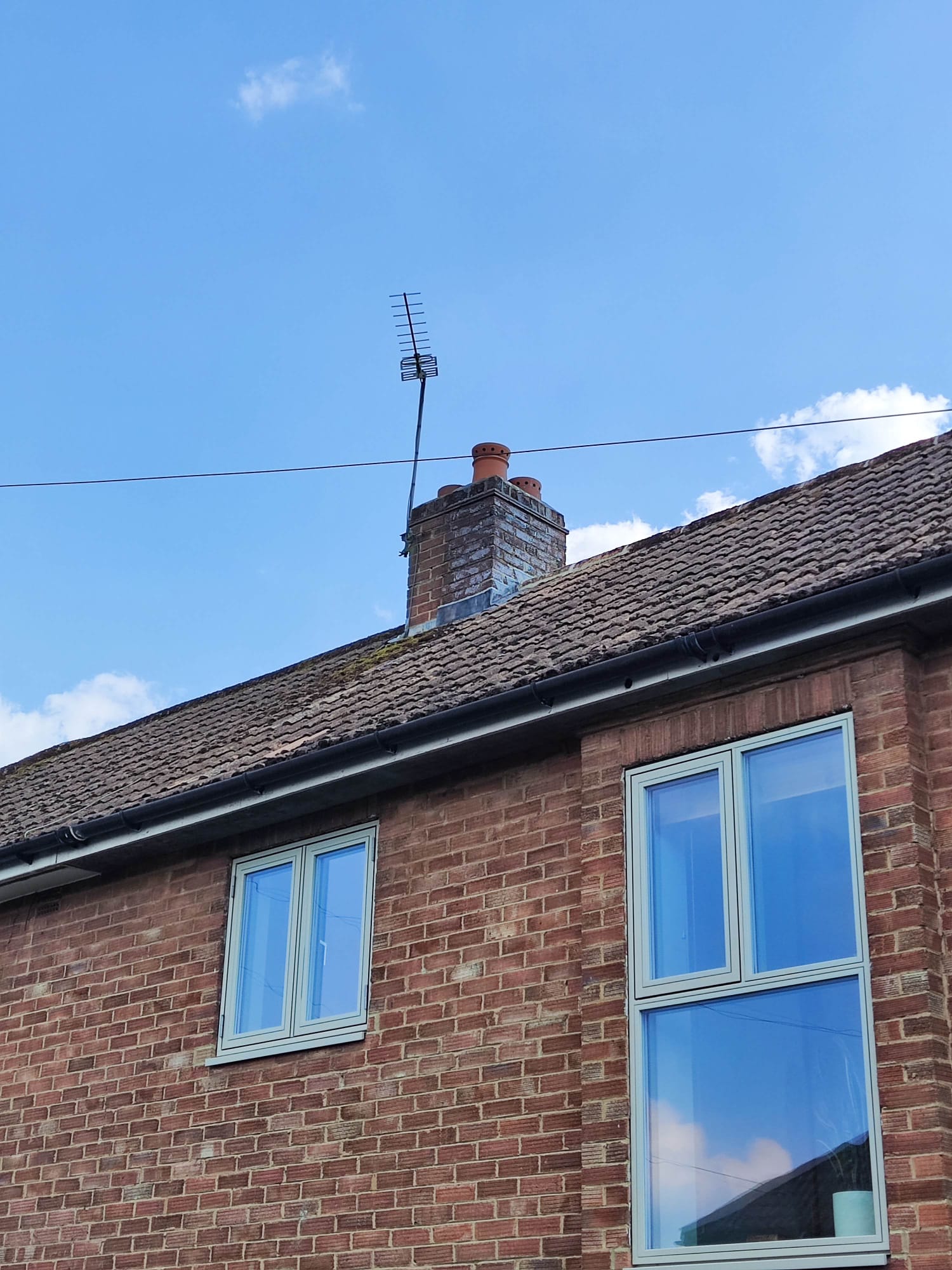

Frontal view of the chimney stack
Ridges in modern houses have to be separate from the flue so maybe you could find a suitable steel hangar for it. The gap where the damp is getting in needs to be identified and closed off with flashing or similar.
Thanks for the reply, that makes sense.
Just to clarify, does the ridge board need to be independently supported if it’s separated from the chimney, or is it normally only located by the rafters?
Also, when you say the gap needs to be identified and closed off with flashing or similar, are there particular failure points you’d suggest checking first on a rendered stack? As mentioned above we've done pretty much everything apart from a full repointing. Any pointers on the most likely place to investigate would be really helpful before I start opening things up or bringing someone back out.
