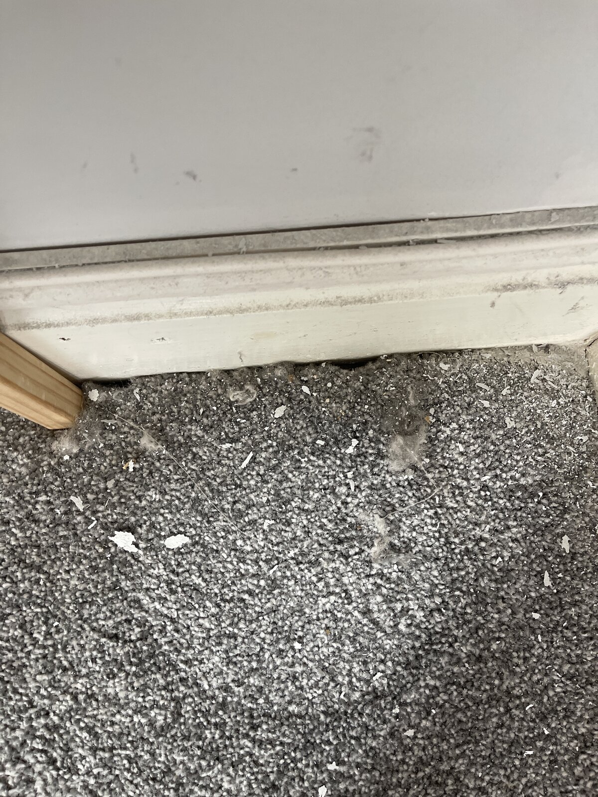

Mate look what damage they do around my living room! I actually can’t stand them and they are so grim

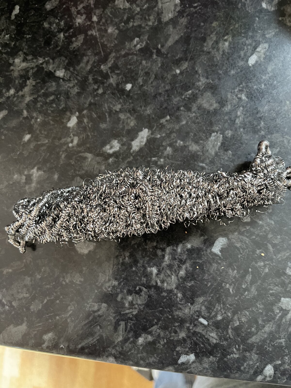

I think this is a form of wire wool. I use this to clean dishes etc.
Would this work fine?
It will work but would be expensive.
Something like this would be much cheaper.
You rip the roll apart and spread it out and then stuff it in to any mouse friendly holes. Wear gloves though, it can be rough on your fingers. A packet that size will go a long way. I cannot tell you how many you will need though. Looking at your carpet, it might be the case that you have big gaps under the skirting. It might make sense to pull the carpet back to check.

Will give those wire wool a go because I have it at home and its spare. Should hopefully do the job?

Medium wire wool is normally recommended. I honestly don't know if fine wire wool will work.
