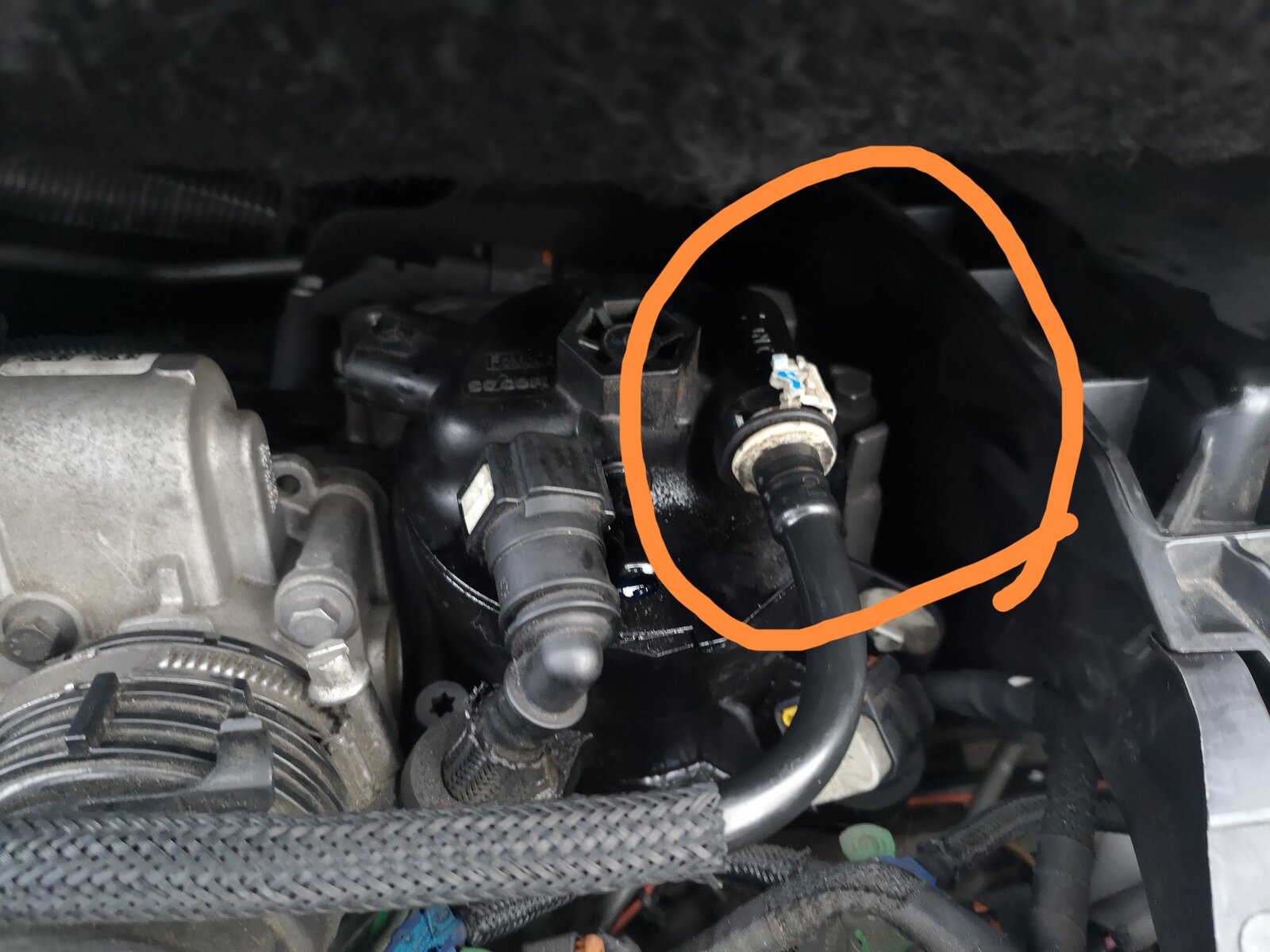

I have a 2017 peugeot partner tepee. 1.6 diesel.
I was trying to change my filters, but got stuck on the diesel filter. There is one electrical connection, and two pipes. Im having trouble trying to disconnect the pipe circled in the image attached. In fact, the clasp on it was quite degraded, and started to break off. How is this pipe disconnected? Thanks in advance for any help given

Right hand pipe.....lift up the white clip with a screwdriver and then squeeze, gently twisting and pulling the pipe back
Left pipe, squeeze the two white plastic squares and gently twist and pull back.
Sometimes these fastenings are the same, sometimes not and appear on either side of the filter!

Thanks John.
The clasp on the right hand pipe is broken, is this a garage job? The plastic was quite degraded, and broke away.
Hmmm that’s a bummer. If there’s any of the white clip lugs visible, maybe some small pliers could be used to pull the lugs up? I haven’t had one break before.
Failing that I’d get the new pipe from a Peugeot dealer before going any further. The engine won’t complain if the filter change is overdue.....most are!
