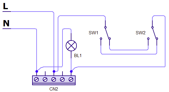

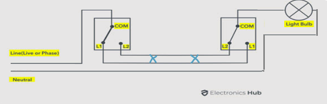

Two-way switches in France can be wired just like the same in UK.
Here's two examples, but both require two wires between the switches.

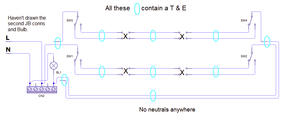

For intermediate switching there aren't any intermediate switches available. The French use the teleinterupteurs.
Here's an explanation.
Help!! trying to complete a job, in London for a French couple. At a late stage, two floors first fixed, the client wants to use a French make of accessories, Arnould (off shoot of Legrand). Basically, they do not make an intermediate switch like ours but uses a system back at the CCU on the...
www.electriciansforums.net
You can use the teleinterupteurs instead of two-way if you want. Then it's easy to add further switches in the future.
