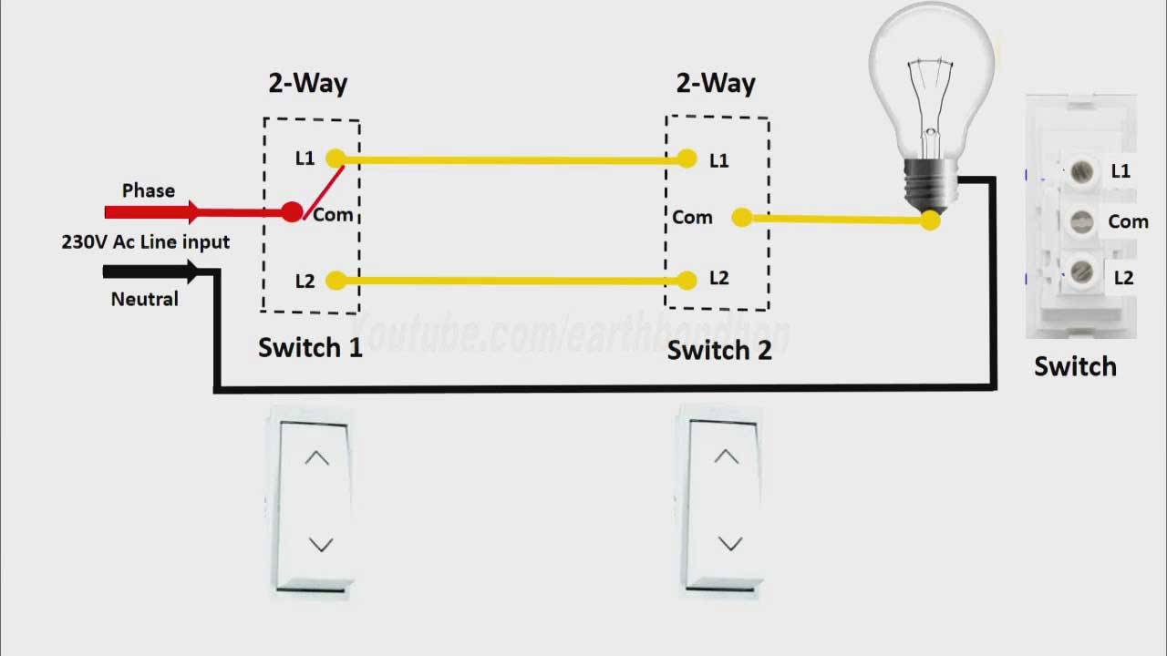

I mean that a two-way switch requires three wires, and my two switches only have two wires coming in to them. Depending on the position of one switch, the other either can or can't operate the light.

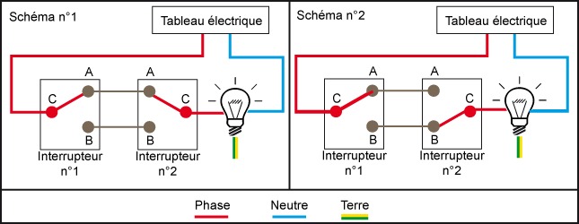

Thanks, hadn't heard that term before. A quick google suggests it still requires the same common wire between the switches as a UK 2-way, though:
(https://duckduckgo.com/?q=Va+et+Veint&t=ffab&iax=images&ia=images&iai=https://media.ooreka.fr/public/image/340503-comment-brancher-un-va-et-vient-1--panorama-12327868.jpg)
What am I misunderstanding when I say that the two separate 2-way switches require a connection between them, i.e. L+N+Com?

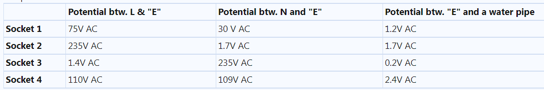

The potential between different wires varies from socket to socket:
Potential btw. L & "E"Potential btw. N and "E"Potential btw. "E" and a water pipe
Socket 175V AC30 V AC1.2V AC
Socket 2235V AC1.7V AC1.7V AC
Socket 31.4V AC235V AC0.2V AC
Socket 4110V AC109V AC2.4V AC
Is this what is referred to in the comments as floating earth?
In the diagram, there are no Neutrals at the switches.
The only Neutral is the blue wire from the lamp back to the supply.
What are you meaning by "socket" 1 to 4?
In that case:
It would appear you have reversed polarity at socket 3.
Sockets 1 & 4 L to E something wrong.
L to E should always be ~230V
L to N should always be ~230V
N to E (or E to pipe if earthed) should always be very low Ohms - and very low Volts.
Two-way switches in France can be wired just like the same in UK.
Here's two examples, but both require two wires between the switches.
