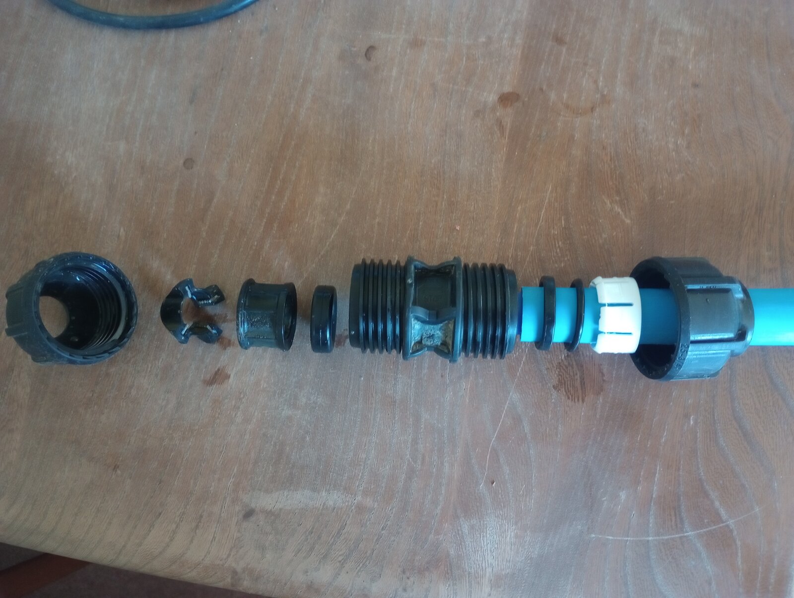

Just wondered if anyone's got any experience with these. I've got to fit one to get the water back on. I've had it a while so want to check it's all there and that I've got it in the right order. I'll attach a picture. Thanks if you can help.
Nope - white grab ring on right would be the other way around. What is it transitioning onto? The newer Philmac are very straightforward and use that universal transitioning coupler (UTC) end, as a one end fits all.

Thanks. I'm just glad nothings missing.
It's going into copper that's slightly bigger than 15mm and nothing else seems to fit. I bought it a year ago for £30!
They've got teeth at both ends now I take it then? Cheers.
