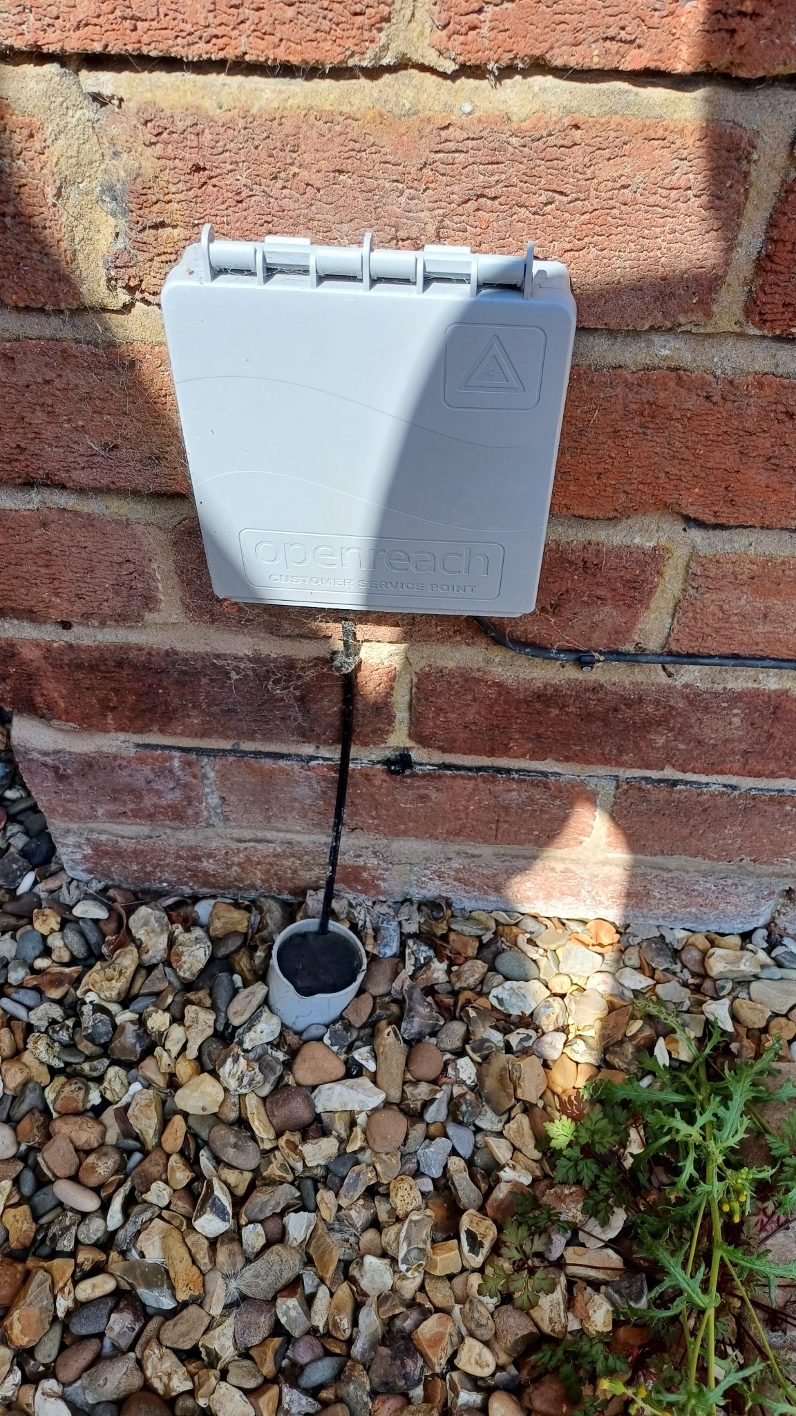

So going back to very early in this thread, this photo shows how the BT full fibre appears inside my son’s place. It was installed in December last year
I feel very cleverly constructed "lump of glass" is just a little understated ;)
Well, if that's what it is, that's what it is - even if it is extremely cleverly designed and constructed!
Countless things in this world are, in a literal sense, "a lump of something", but sometimes extremely cleverly designed and constructed.

I would still be intrigued to know how on earth it works. On the face of it, I would have thought that each such "lump of glass" would probably have to be 'bespoke' in every case (e.g. according to the number and identity of the individual customers and/or PoCs), but I can't believe that woud be practicable?
yes but those bespoke situations occur on pretty much every fibre circuit

The splitters don't just split, they do WDM mux and demux.
My understanding is that what BT (and CityFibre, etc?) are currently deploying is GPON, “gigabit passive optical network”.
The splitters are all passive, and it all uses two wavelengths, one for upstream and one for downstream. Multiple users are segregated using time-division multiplexing only.
I’m surprised by your comment about WDM in this context. I was under the impression that it was not used on these fibres. I do know that 10GPON uses different wavelengths, so in principle you could have gigabit and 10G on the same fibres for different customers.
