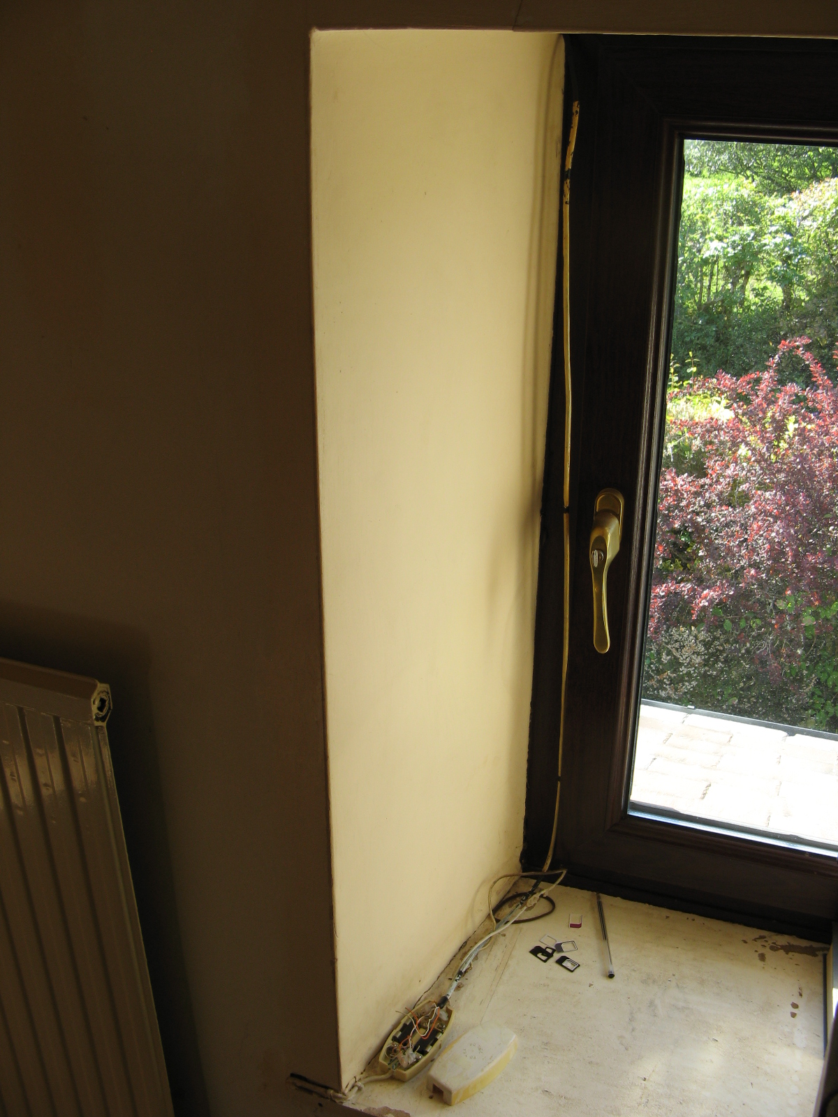

Recently moved house... The phone line in the property does work, but is rather unsightly. It comes into the house at an upstairs window on the landing:

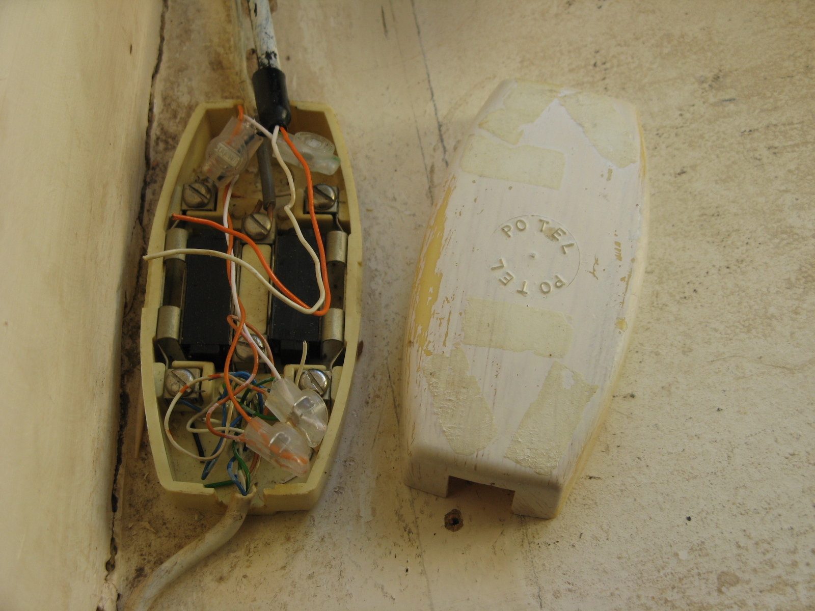

Then it comes into this junction box on the windowsill:

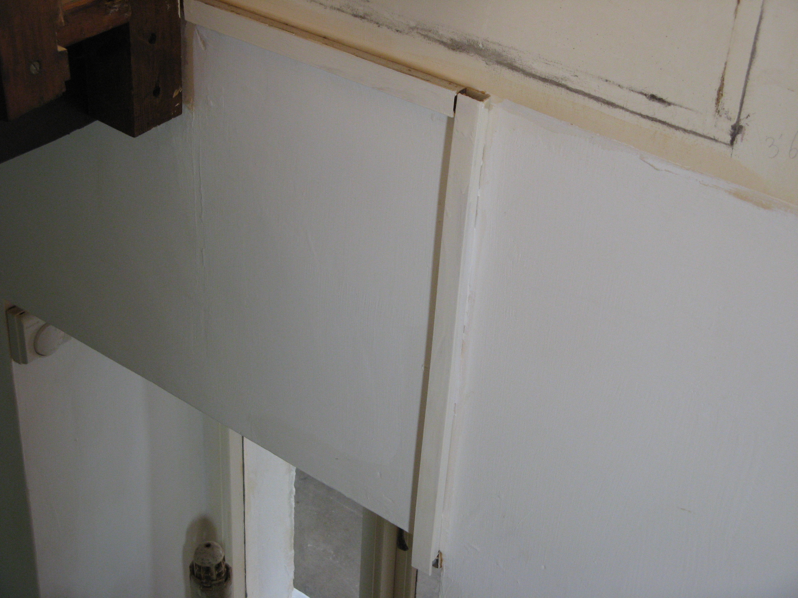

From there, it travels through this conduit down to the living room windowsill below, which is where the Master Socket is (out of view in the photo)

We have a Master Socket in the house. All three photos show the wiring in the house BEFORE the Master Socket. So the first photo shows the phone line coming in from outdoors and down to the cream coloured oval box (at the bottom of the photo). The second photo is that same oval box, but close up. The cable then comes out of this oval box, runs just under the edge of the window sill, and then down from there through the conduit in the last photo. After that it goes to the Master Socket.
The phone line works fine. It's just ugly having the cable just hanging there (photo one) and going through the conduit (photo 3).

Yes, so that includes the "block terminal" (oval junction box on the windowsill). It is perfectly normal to have these in older installations, especially as it looks like you might have "dropwire 12" cable coming into the house, which has thicker wires than normal dropwire cable and cannot be wired directly into any socket with IDC terminals.

No. You could take off the plastic trunking if you want, I doubt BT did that in the first place, more likely the previous tenant.

I hadn't really go that far yet because I didn't want to put the cart ahead of the horse. The option you suggest could work. Other options... Do people ever / can you chase it phone line? More subtle conduit might be another idea (both in size and placement). But it's likely that to achieve most of these things the line would need to be longer, so that would mean an Open Reach engineer I presume....

Yes, but this would normally need to be your own internal wiring, coming out of the master, not the incoming line.
Yes, you're likely to end up with this sort of thing on the outside of the house if OpenReach have to extend the cable, unless you specifically ask for the cable to the pole to be replaced, i.e. more cost.
Another option to consider is a modern wireless set of phones, with the master upstairs by that cable joint and replace the cable joint by a master socket. If you need to also use internet on that line, you could have the router there too and use its wifi.

That joint box looks as if BT has made the joint, at least who ever used what appears to be the 'jelly joints' used by BT.
I may be wrong, but I think the grey dropwire is no longer used and the wire is connected to the new black dropwire with the little Sleeve Dropwire 2A.
In which case the Block Terminal (which is a slightly unusual one which someone might like on Ebay) might be replaced with a new NTE5C (whistles nonchalantly).
