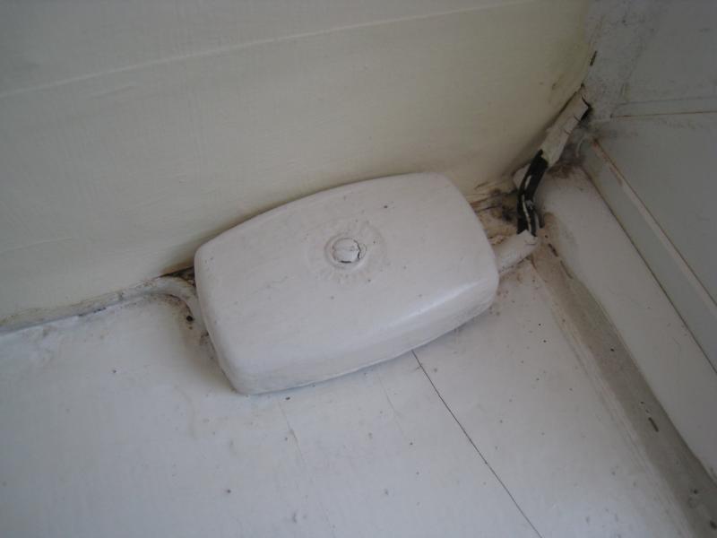

I live in a purpose built maisonette.
Where the telephone line enters the house there is a rectangular junction box type connector
only connected to a second rectangular junction box connector where the two telehone extensions are connected.
There appears to be no NTE5 Master socket in the property.

that "soap bar" connector is the very old type from before the modern type of socket was introduced
AFAIK the "GPO telephones" would convert installations if they were working in the house, otherwise they used to leave it as-is unless you paid them.
We are going back 20 years or more.
GPO/BT terminal block no. 52A. :D They were the standard connecting blocks for 700-series telephones, and are just a simple 4-way connection inside.
As noted, strictly speaking if you don't have a modern NTE5 you aren't supposed to touch any of the wiring, but in practice with the mess created between the various service providers and BT/OpenReach today, nothing really bad is going to happen if you just get an NTE5 and connect it. If there's sufficient drop wire to re-terminate, you can wire it directly, otherwise just locate it adjacent or nearby and wire to the 52A with regular internal cable.
With an installation of that age, you might find that the extension wiring already in place is the older type with blue, orange, green, and brown wires rather than the white/blue & white/orange pairs of today.
