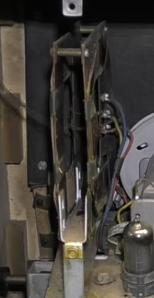

One can't assume because you can or can't do some thing where you live, it is the same for everyone. And since @PYE P75A is into radio I expect he knows how to make aerials, I love the HB9CV but I am sure @PYE P75A can confirm an aerial like this
works very well on long and medium wave, but not really up to the job for short wave. It is not only indoors it is inside the radio indoors.
But those radios are now quite rare, and with short wave today we really need a BFO. However the point is how to relay TV signals inside the home, preferable in a legal manor, I remember on the Falklands we were told the military were going to start transmitting TV, I had a TV for my old spectrum computer, so every so often would try to tune in.
