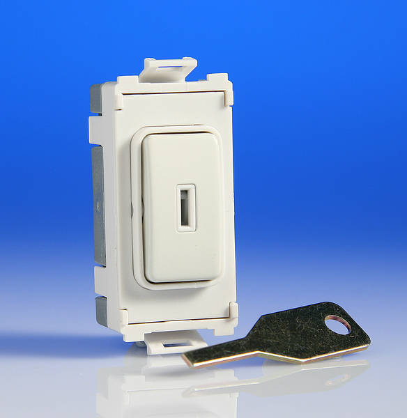

I have a different solution that may work for your situation, as it's quite unusual in my experience to have a loft light switch below the hatch.
You could replace your switch with a grid system like these: https://www.tlc-direct.co.uk/Main_I...mate_Grid_Index/Ulimate_Grid_White/index.html
For the rest of the lights, fit a standard switch module in the grid and for your loft light switch, fit a key switch like this:
https://www.tlc-direct.co.uk/Products/GUG20DPKWPW.html
This solves the issue of accidentally switching the loft light on when you aren't going up there, and also has the added benefit that someone can't easily switch the light off while you are up there.
