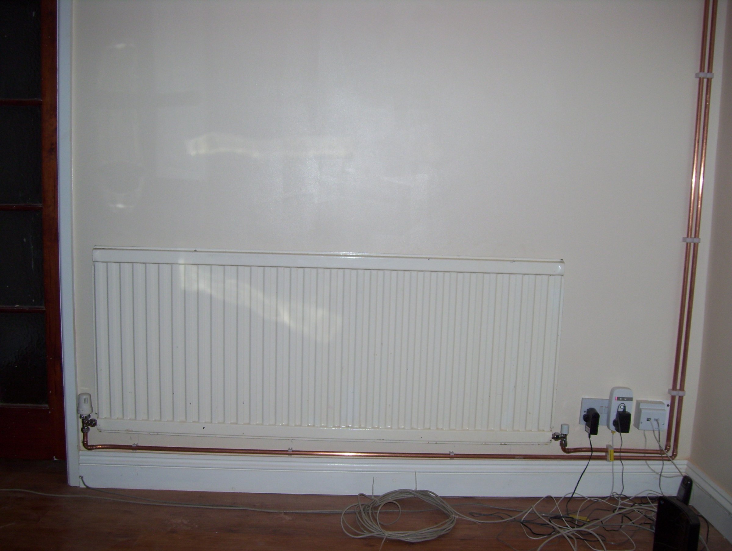

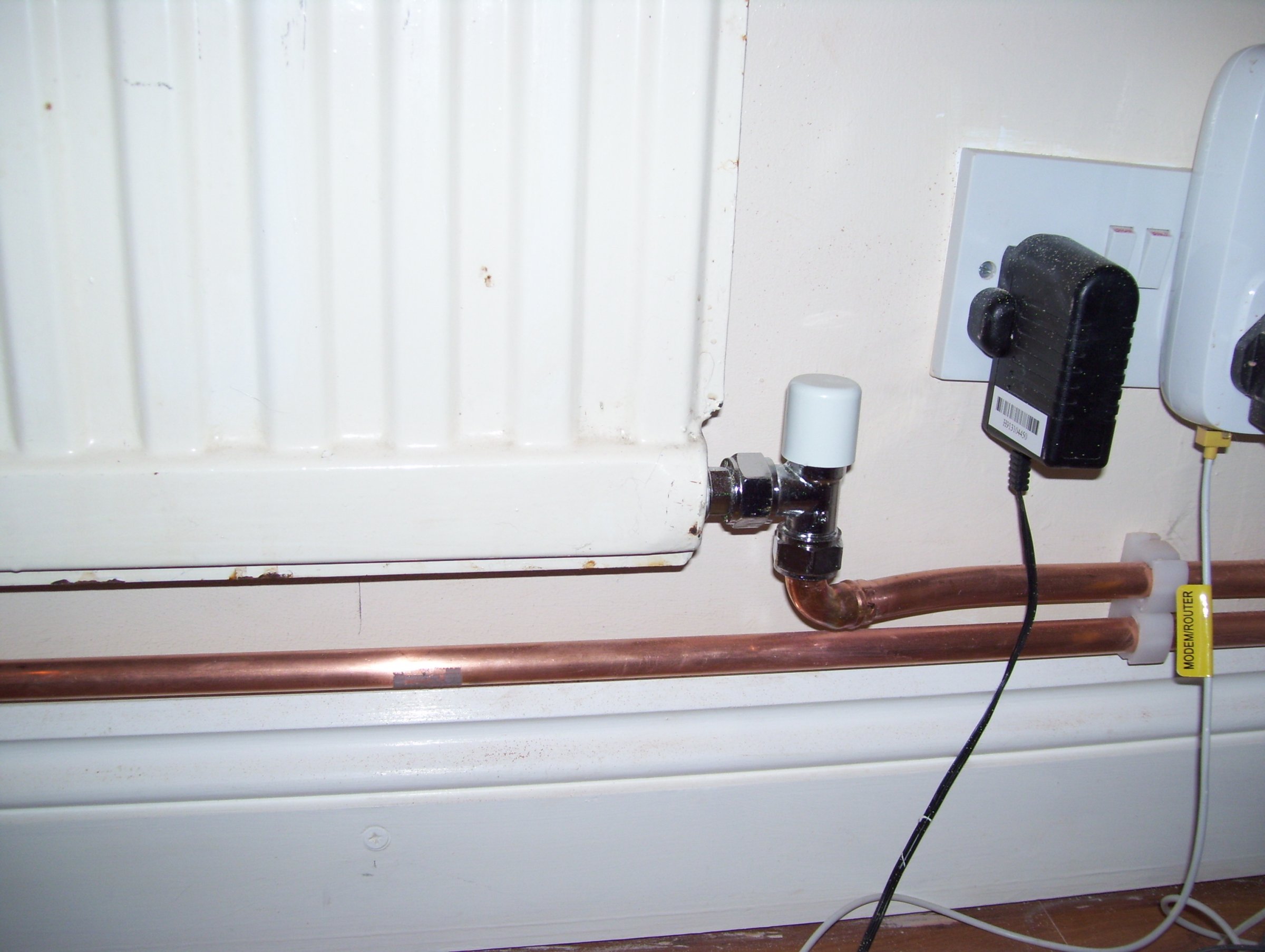

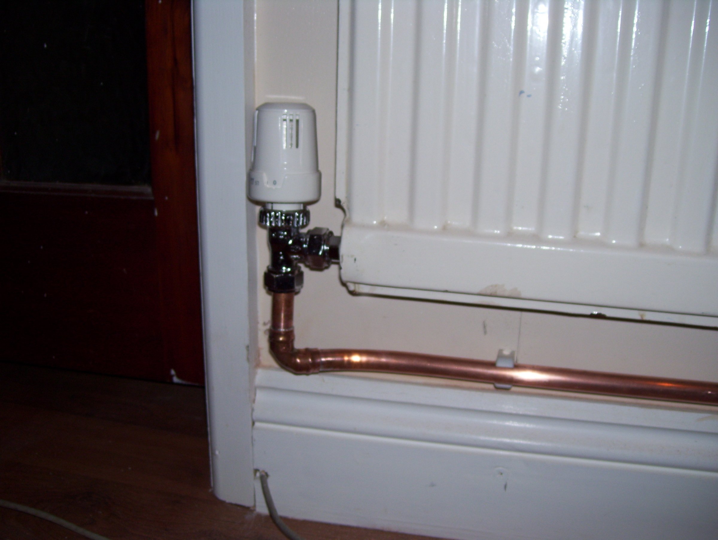

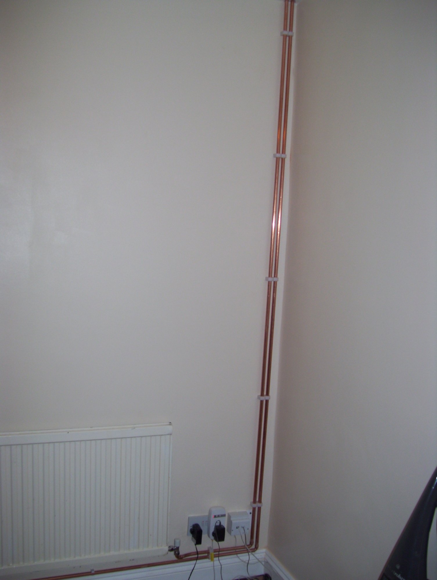

Thanks for the advice all. I got a spring this morning from screwfix, and cracked on with it, so missed the last few posts. I've put some picks in an album. Not perfect perhaps, but looks ok, and it works :). The vertical pipes look out of plumb, but it is, in fact, the wall of our 1940's house :).
A smart professional job mate! Have you any plans for disguising the pipes up the wall?
I hope you qualify for many brownie points......
John :)
Well done mate.
(y) That looks great, no need to hide them! It's also nice to see the pipes properly supported so they won't sag in a few years time, you don't get that around here.
