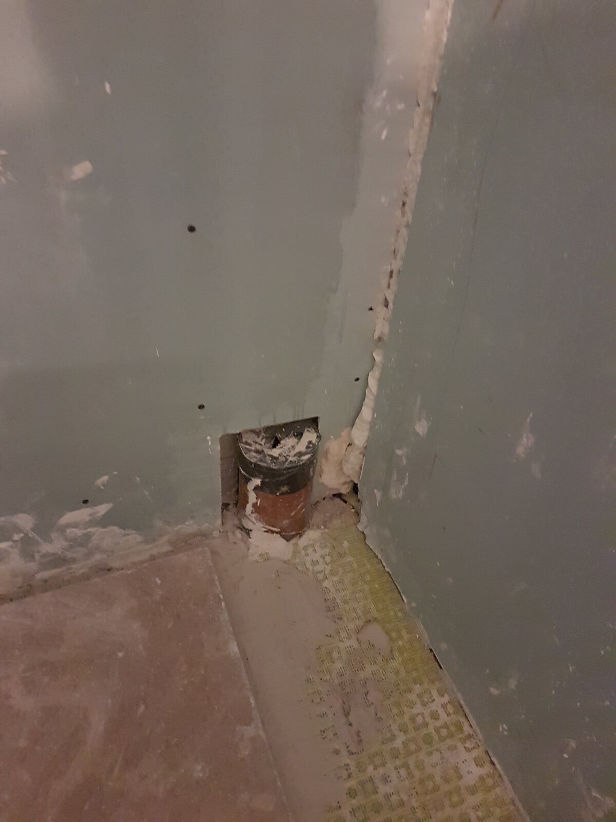

I need to box in the pipe work for a Durgo valve in the bathroom.
The pipe needs to extend our a bit to clear the insulation board wall.
Would I just use 2 x bends with some pipe between them. Any idea what degree bends I need?

2x 45 degrees, adjust the pipe length used between the two bends, to whatever distance you need it to come out.
Usefully, you may be able, by making the pipe between the 45's a little longer, to move the pipe right into the corner - if that will help.

This is what i thought but without the bits to hand it was difficult to picture how it would not end up really wonky but it will be boxed in mostly so not really important as long as the box isn't huge.
