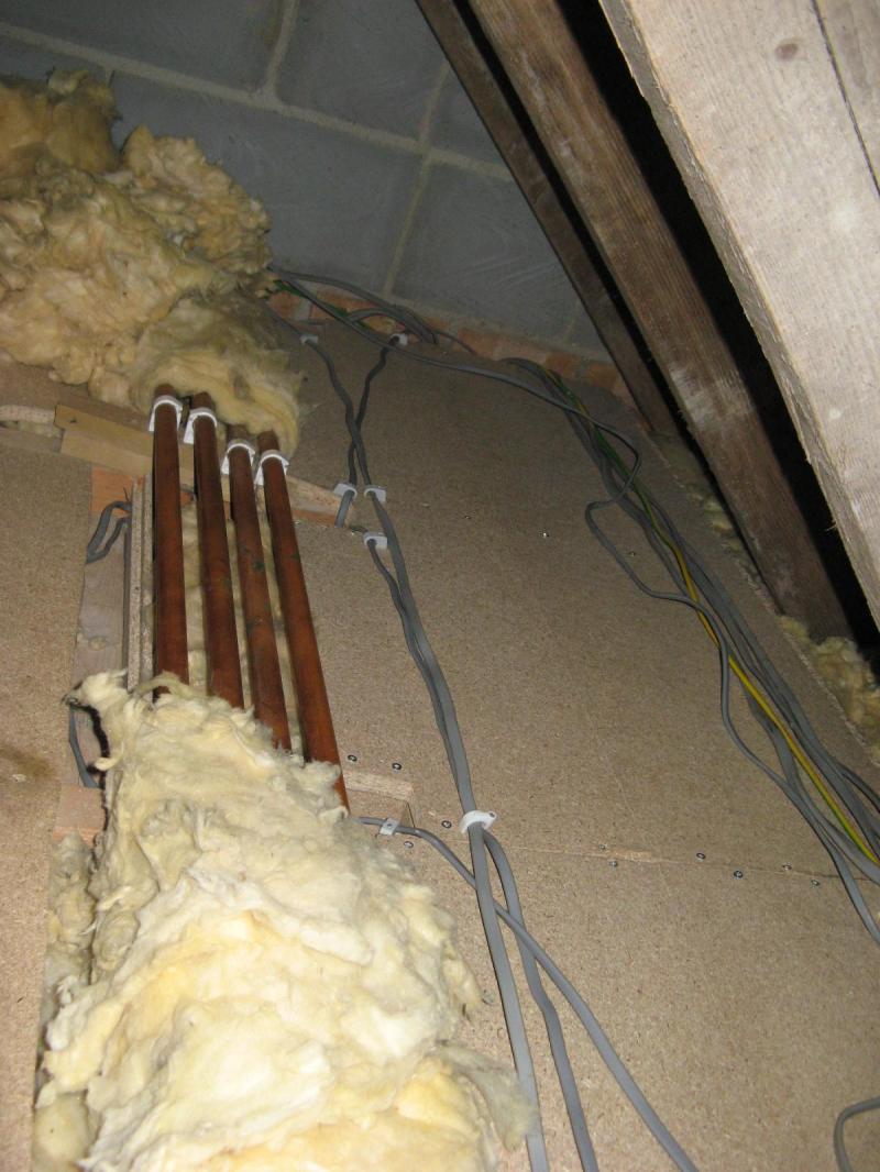

I have a small loft above the one storey utility room at the end of my house. Four pipes rise from the boiler in the utility room, and then run through the loft into the rest of the house. They all run quite close together.

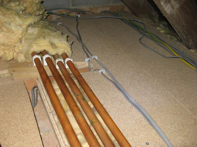

The loft is all boarded out, EXCEPT for where the pipes run - there is no boarding beneath them. See pictures for an illustration.
I'm going to box the pipes in so that they do not get knocked when putting things in/taking things out of the loft. My question is whether I should wrap the pipes up fully in insulation OR whether I should put insulation at the sides and on top of the pipes, but NOT beneath them (so that the warmer air from the room below will rise to them - as it does for water tanks in lofts).

Since one/some of these pipes should be hot, the best thing would be to surround them with insulation. In the circumstances shown, it's not going to make any real difference if you insulate below them or not, so your choice.
Thanks for the reply. Just to clarify - with the hot water only on, two of the pipes get hot. When the heating is on, all four pipes get hot.
I should also that due to the work we do, etc. the hot water/heating is not used as much as it is in the average home. We may go several days at a time without using either. So the purpose of the insulation is mainly to prevent freezing, although if it makes that the system more effective and energy efficient that is a bonus too!

Insulating over the top of them will be the easiest and will be perfectly effective.

Still got very mixed opinions on this one. However, I think I'm going to wrap them as advised and that's for a couple of reasons:
1. They were originally wrapped and have been since the house was built in 1993, with no problems.
2. I have not thought of this reason until just now..... When the heating is on, all the pipes are hot anyway. So the heat from the room below rising to prevent freezing is totally irrelevant! When the heating has been off for a while, the room below is pretty damn cold anyhow (as it's a utility room at the end of the house with a back door and double window).
