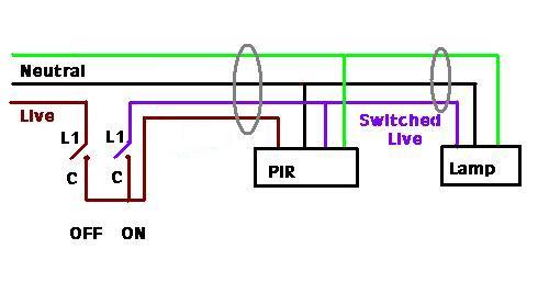

Hi all ,
Is anybody aware of any pir floods with overide facility ie by pass the pir to turn the light on via switch ??
Or any with any space within internal wiring which can be broken into and jointed to incorporate the switch wire ..
Don't want the usual on and off 2 time method of staying on, was hoping to incorporate wireless switch so receiver output = switched live if that makes sense ?
Thankyou
Not sure how it's wired but I have floodlights that work off the pir when the switch is off and then are always on when the switch is on. It's just a standard pir used on the external wall.
