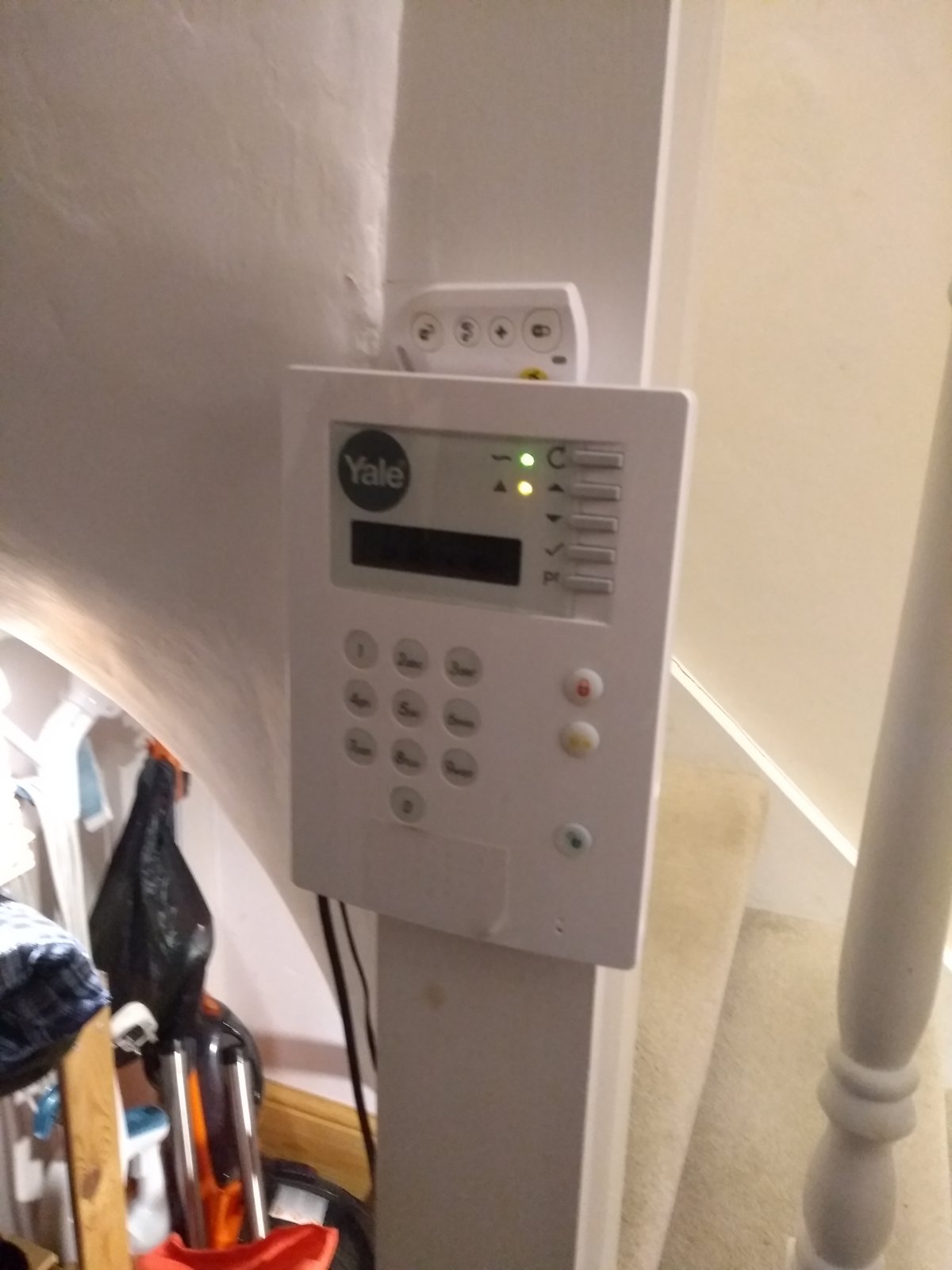

Apols if this is answered elsewhere I searched to no avail.
I have a Yale wireless HSA system.
Got a battery low warning on a PIR.
Entered program mode, changed the battery but have a tamper alert.
Went into fault log and tried to remove alert bit it won't go away.
I re-entered PM, pressed the button on its front, still there. Re took off front panel of PIR and refitted, tried to clear fault log but still have tamper alert.
Please can anyone advise how to get rid of the tamper alert.
Thanks in advance.

Hi, I press the pr button, entered the code, pressed tick to accept. Fault log is the default option, I press the tick button to enter. I see the IR room Tamper, I press the arrowed C button, am asked to clear fault display and press the tick button.

I plan to try, with a friends assistance, to remove the cover and physically ensure the job of the spring is being done by manually holding down whatever is in there.
I have just changed the batteries in another PIR using the same procedure and no tamper alert has resulted from doing so!
