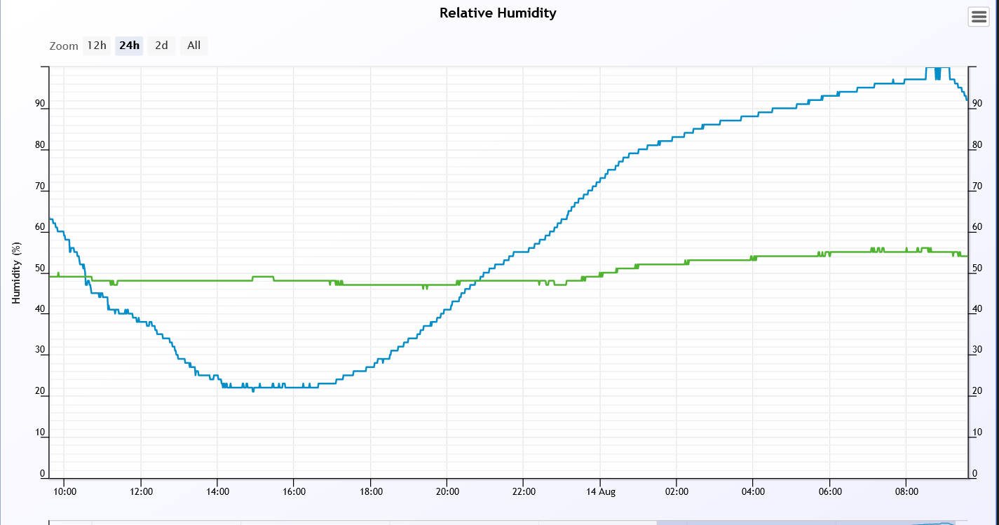

Below is my humidity log for the past 24 hours, which is typical and what you would expect of a home with no issues. Blue is the outdoors, green the indoor level.
You will notice the green indoor humidity begins to rise at around 11pm. That is because at around 11pm in this heat, I opened the windows wide on the upper floor, to vent the heat build up in the house during the day. You can also see a small rise at around 3pm, when I took a shower to cool down.
The blue outdoor humidity reaches a minimum in the heat of yesterday's afternoon, then gradually increases as the evening cools to a maximum by 9am. I have the system set to accept anything greater than 90% RH, to show 100%.
