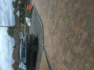

Thank you for the great post mate. Drive looks fantastic.In my opinion you're overthinking this a bit. Google "angle of repose" to get an idea of what you can do near the foundation. Slope the driveway up so the subbase finishes level with the top of the concrete and the finish covers it. If the slope is too steep you can consider things like a "step" or a steeper section about 2 feet from the wall - picture your car - the wheels should be at least 2 feet from the wall so you only need to take account of the overhang of the car a bit like in a carpark where the front goes over the kerb until your wheels touch it.
I lowered my ground level by about 300mm, I actually excavated 500mm and exposed the foundation but the subbase and block paving added back 200mm. You can make out the original ground level (2 courses below the top airbricks and see where I had to render over 4 courses of exposed foundation bricks because they weren't facing bricks.
I could have gone lower and made the slope flatter but didn't want loads of steps up to the front door.
I am curious as to why you went 0.5 metre down then 0.2m back up. Could you not have simply gone down 0.2m to start with then raised it back to the original level with your drive? Or did you want it dropping down anyway?
So really, 200mm of surface is all that is above your foundation? That’s interesting. I still have lots to learn haha!
