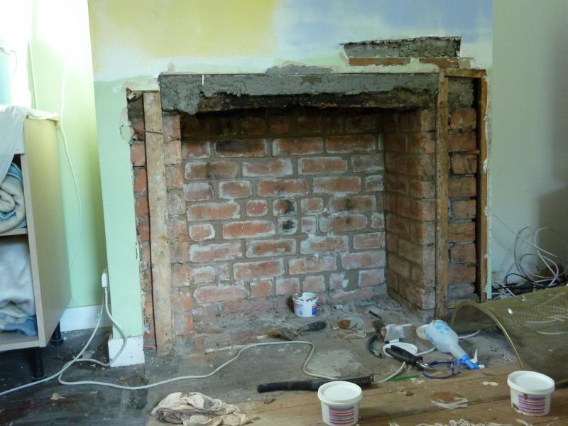

I've been reading through the many posts on the forum to try and figure out how to finish around the fireplace. What I am doing is re-pointing the original chimney brickwork in the recess and plastering the wall around the chimney. I've read Gypsum plaster is not as option, and VITCAS has been mentioned as an option. My questions are:
1:If I were to only use the VITCAS to 800mm above the fire (to save money) the how would I tie in normal gypsum plater as the VITCAS website says it forms a non porus surface and so can't be skimmed?
2: How would you finish the corner around the fireplace opening (between the wall and the fireplace recess) if you are keeping the internal bricks? Put up some formwork and plaster up to it to get a clean edge?
3. If I use fireboard, how can I tidy up the edges at the corners of the recess (as above)
4. This VITCAS stuff if quite expensive, any cheaper options?
Cheers!

Could you post photo's of the situation?
Here's a pic of the opening. I want to leave the back and sides brickwork, and render / plaster the walls. I'm going to put a wood burner in the recess so need to keep a min distance for plaster / flammable material.
I think for the edge around the opening i will use a stop bead as I'm not rendering into the recess. Then I can use the heat resistant stuff up to a point, use uni bond or equivalent for the tie-in between that and the plaster and plaster the rest[/img]
I am like you, i like to see well pointed brick work, and to me the metal stop bead would detract from the rustic looking effect of the brickwork.
The way i would go with it is, cut a a wooden straight edge to the length of the corner of the area, by knocking nails in to the bed joints of the brickwork, or get some one to hold it in position while you render up to it, it just gives you a hard edge to finish to.
Let the scratch coat set, (but not dry) then give it the second coat, and wait while this starts to set, just keep testing it every so often until you can feel getting stiff. Then a moist sponge and very very gently run it down the stiffening angle. You will make a slightly rounded corner, what we would call a pencil round corner. Then take a small brush, about 1/2 inch or so wide and brush the render gently in to the bed joints. to fade it out from the corner.
Its a bit of a bit picky picky procedure, but when done right, i think it looks spot on.
If your not confident in doing that, you can of course just stick your stop bead on and at the end of the day, it is really is a matter of personal taste.
One more thing, is that the render will get hot and cold, expansion and contraction, which means that your render coat needs to be well and truly stuck to the wall. Another variable is the render it self, sand and cement is a stiff and rigid material when set, while browning and renovation plasters are more pliable, it has more give in it therefore less likely to crack from heat.
Which ever way you go with it, i personally would rake out the joints of the brick work your going to render over, to a depth of about 1 inch. This would then create a good key for the render to grip into and to counteract the results of expansion and contraction. Then of course PVA it before slapping on the render.
The ideal tool for raking out the old sand and cement in the brick work joints on small interior jobs like this is what i think is called a multi tool, that works on vibration and therefore does not blow the dust all over the place, perhaps you could borrow one from a mate or relative.
I'd be interested in seeing the finished job, if you get time to post one, either way good luck with it.
