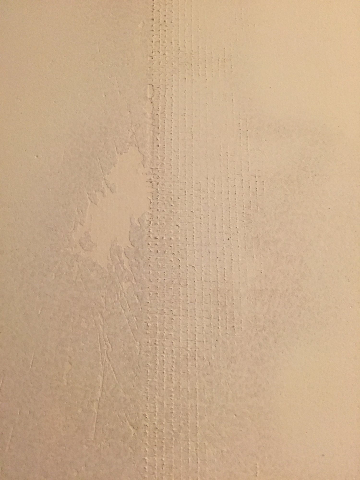

How do I sort this? Scrim tape showing through after light sand! Took out a partition porch, taped and skimmed. Want to paint over. Can I polyfilla/skim over? Cheers
yeah sand it back a bit harder then use a sandable filler. You will have to fade it in over a wider area, might take a few goes to get it right
