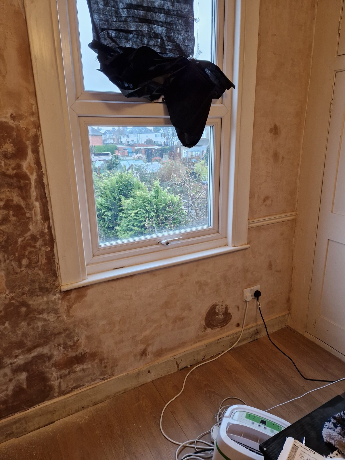

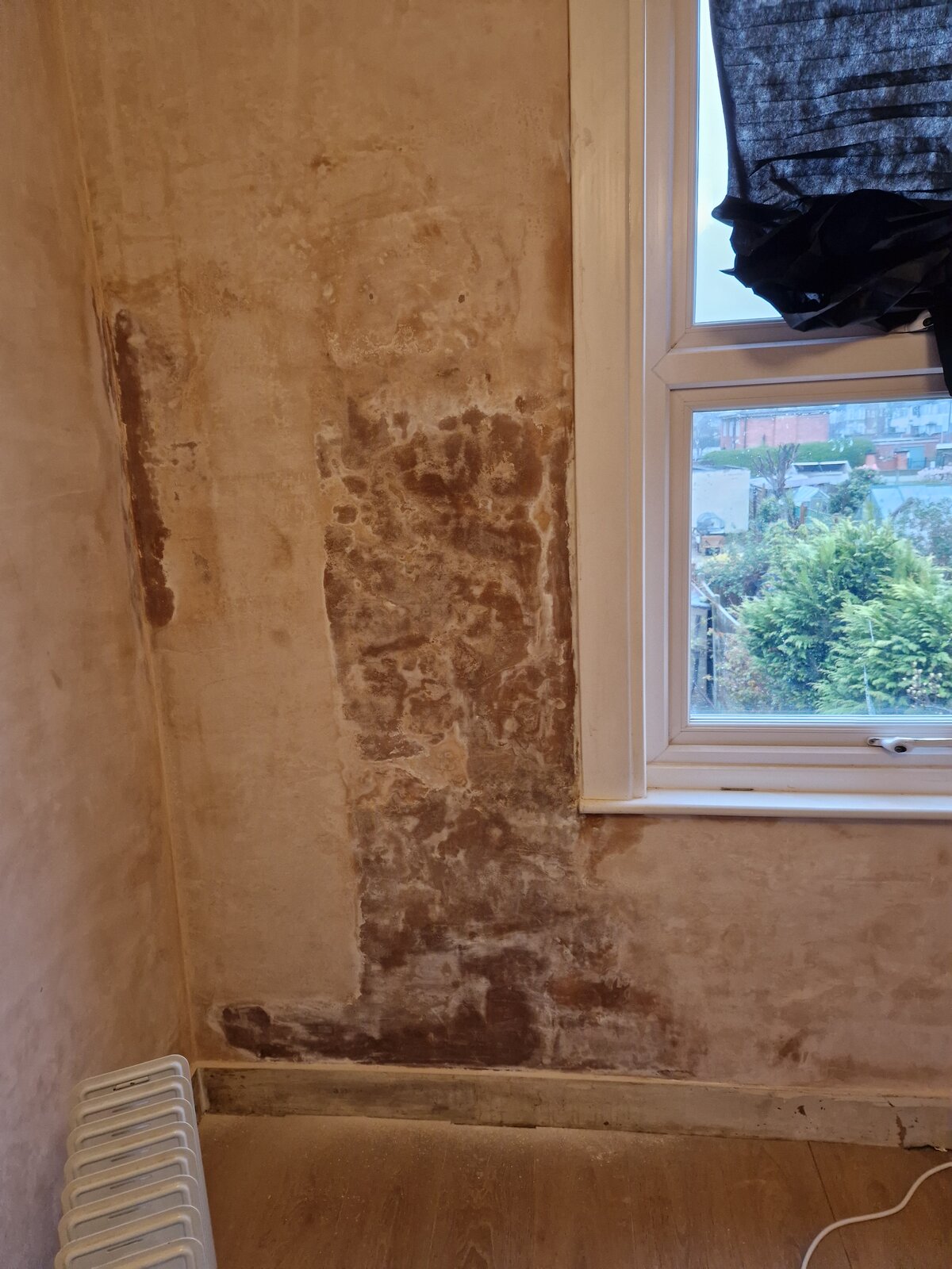

Hello,
I had some plastering done last August, there was one section of the room where the previous plaster was crumbling off the walls, so that wall had much more plaster used to full it, so has taken much longer to dry. It is now 7 months later and the plaster still hasn't dried (see first picture), for the last two months we have had a heater next to it and dehumidifier and it has turned a lighter colour and doesn't feel damp, could it be dry and that will just be the colour of the plaster?

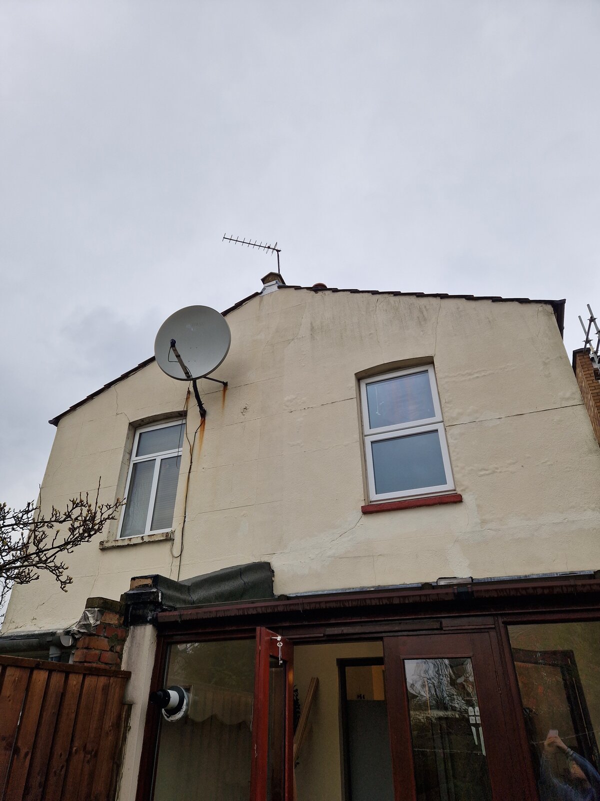

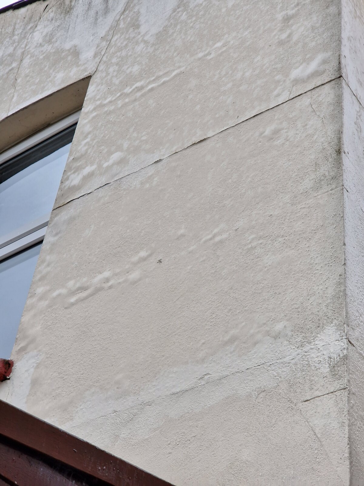

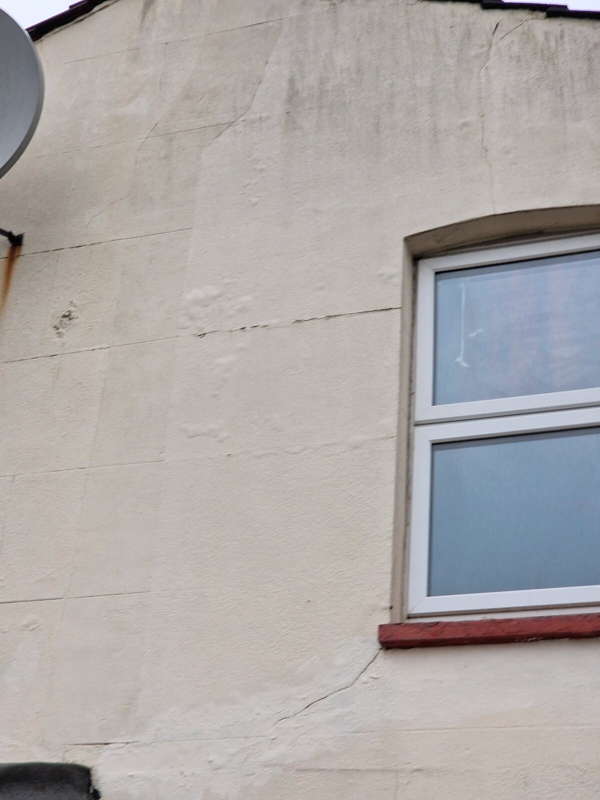

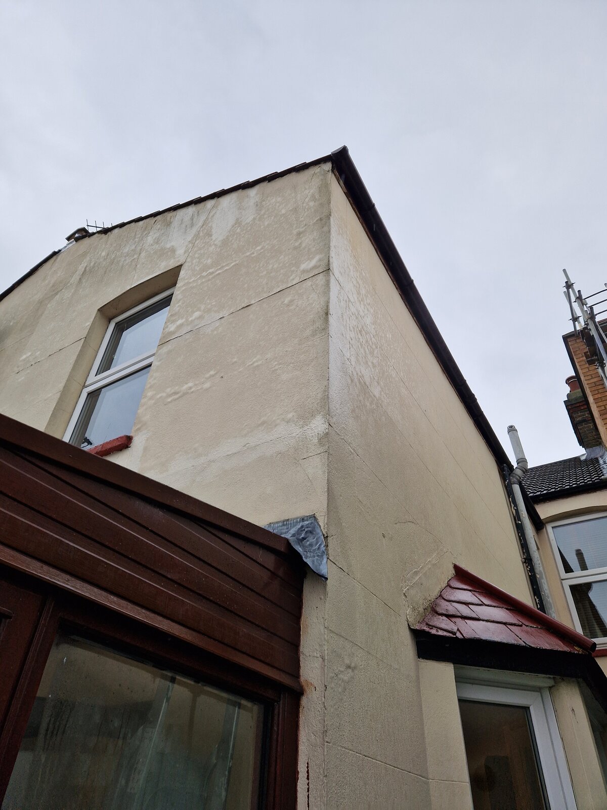

Secondly, I have looked on the outside of the plastered wall and I'm unsure if there is water getting in due to the wall being damaged. I have attached pictures below, are the blocks on the wall a type of cladding, or waterproofing? Can it be repaired and would that solve the issue? A builder suggested digging out the cracks and using exterior filler and using a thermal plasterboard for the internal wall and reskimming.

What did he use as a base coat to reinstate the inside walls, sand and cement then skimmed over, or browning skimmed.
The blocks on the wall are a pattern scratched into sand and cement render if you want a proper long term fix then it needs to be all knocked off and redone any thing else is just a temporary bodge as far as I am concerned. That could well be the reason for your penetrating damp but there could be other reasons such as brick ties being bridged with mortar along with the render problem. I am making the assumption that you have cavity walls. If they are solid then the render definitely needs replacing.
Thank you for your response, as far as I'm aware the plasterer used plasterboard followed by a much thicker layer of plasterer in that area due to the previous plaster crumbling on that wall.

Judging by the dirt on the outside wall, you've got water running off the edge of the roof and down the wall which is penetrating through the render.

1. Your solid walls have been penetrated by damp - what you see on the inside is damp penetration.
2. all the plaster etc must be hacked off back to brickwork and then rendered with sand & NH lime in 3:1 mix. And skim finished with a custom remedial finish. Plasterboard must not be used
3. Investigate inside the built-in closet for perhaps more damp or condensation.
4. The outside render to the whole back elevation has failed - damage can also be seen on the side wall render. It must be hacked off to brickwork and rendered with a 3:1 S&L mix.
5. The "blockwork" lines are merely decorative render - its called Ashlar or pretend stone blocks.
6. The verge above your rear wall is wrong - its allowing water to drip down the render. The verge needs correcting with an undercloak and pointing.
7. FWIW: the flashing above the shed extension and the side wall bay is wrong, and needs re-doing.
The chimney stack might need attention?
The extn parapet is covered with felt - felt used as flashing usually fails.

If the cause of the penetrating damp is fixed (externally), will this not allow the plaster to dry, instead of hacking off all of the plaster?
Why should plasterboard never be used? Is that due to having solid walls? Or does it always have the potential to allow damp in?
It might do. Fixing the source of water is certainly the first thing you should do, because it will stop things getting worse, and allow the house to start drying.

I've advised renewing with S&L render specifically to give the wall a chance to breathe - plasterboard would eventually end up stained and decaying.
I don't think you need to hack off the external ashlar render as it looks as though it is only the masonry paint that has blistered , find a broken roof tile and run the rough side over the rendered wall to see if it sounds hollow, if so its failed ,if it sounds solid then it has not failed, you may need a brick plane to clean the paint off and repair the cracked areas and then treat with a water proofer and repaint, get the roof sorted out so you stop water running off the roof and down the wall, the interior looks like it is an original sand and lime render with a lime finish that has been patched up at some point using a carlite based plaster like bonding or browning, now carlites love water and will find it from anywhere and eventually rot, personally I would hack those small areas out and redo with sand and cement and a water proofer or a limelite plaster that inhibits damp, as long as the backing is sound there is no need to hack everything off, unless you can afford the mess and expense , it is water penetration that is your enemy,get that sorted first before dealing with the cosmetics

  • I disagree that my advice is wrong , it is funny that I viewed yours as wrong and over the top, there is no way you can tell by looking at the photo that the render has failed , you have to physically examine it , there are a few parts around the windows that have been repaired in the past and they appear to correspond with the repairs on the wall internally (possibly due to settlement or when the new windows were fitted), as for cosmetics that refers to the interior as if you are experienced you would know that the internal plaster work is cosmetic/decorative and not structural, in truth when I read your post I was flabbergasted on how over the top you have gone, Oh and to be clear Damp does not rise above 1 metre in height so how has damp penetrated an upstairs bedroom wall ( water has penetrated through the crack in the render and that area needs attention as stated )

"The previous plaster was crumbling off the walls, so that wall had much more plaster used to full it, so has taken much longer to dry. It is now 7 months later and the plaster still hasn't dried (see first picture"
as I stated in my post the plasterer possibly used a carlite plaster like bonding or browning and these plasters will suck water from anywhere and must not be used where damp or water penetration is an issue as they rot and will always find water and mineral deposits will appear
