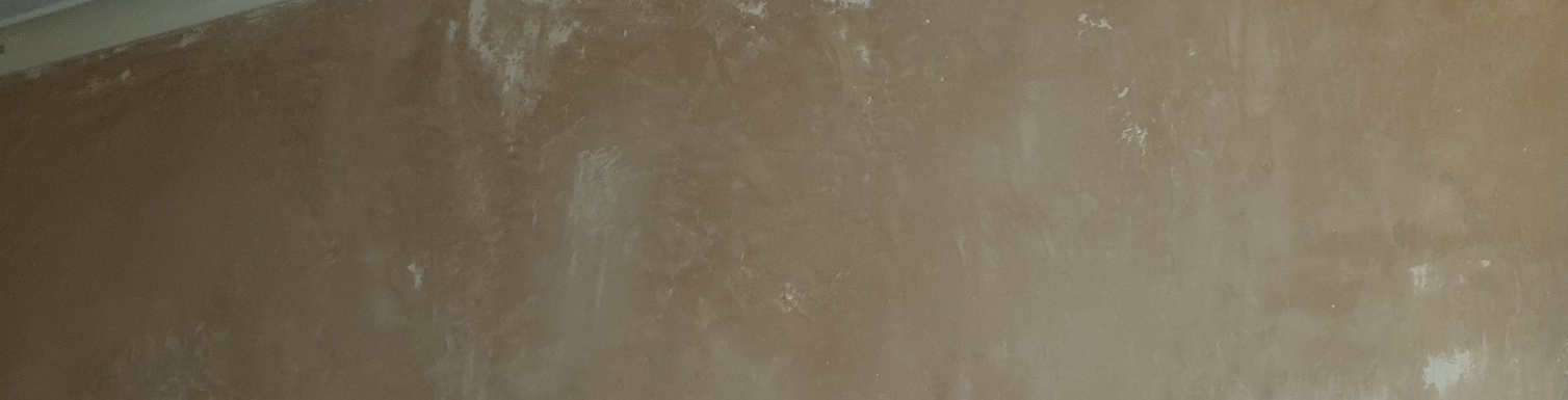

Hi, just wondering how this went for you. I have the same issue in my house now and am worried about how long it will take. Been drying for 2.5 weeks now and will give it 1 more week.
Hi,
Same thing over here. Last wall dried unevenly but a reskim made things a lot better. So the picture is of a wall done 3 weeks ago.
Im trying to work out whether its best to wait 3 more weeks then:
1) reskim the wall after 2 coats of watered down pva.
2) use joint compound to fix the uneven bits (where the plaster has dried too quickly).
Bit dissapointed the wall turned out like this as it did get 2 good coats of pva (not gone off, 3:1 ratio).
Really went to town with the trowelling, maybe over-did it ? But i was careful to use very little water.
Other than that, it was 2 coats of multiskim with a worn-in trowel. Speedskim to flat. Any advice on preventing those dry blotches would be welcome.
Thanks,

watered down pva is next to useless.
wait for it to dry and either neat pva with a handful of sand thrown in or bostik green or blue grit.
It actually looks like you overtroweled it.
pva - skim 24 hrs later.
When you skim the pva emulsifies so if you trowel up to soon you’ll start dragging it around.
this wont happen with green or blue grit.

That point about the overtrowelling makes a lot of sense. It is odd still, I made a point of waiting until I could just about make fingerprints in the plaster but other than that it was almost 'set'. I almost thought I had left it too long.
Perhaps the only other difference was that I did the trowelling up with an older steel (worn-in) trowel. Mind you, it was not marked/damaged in any way.
Sounds like I had gone at the wall a bit too hard. Will give it another try. Thanks for your help.
