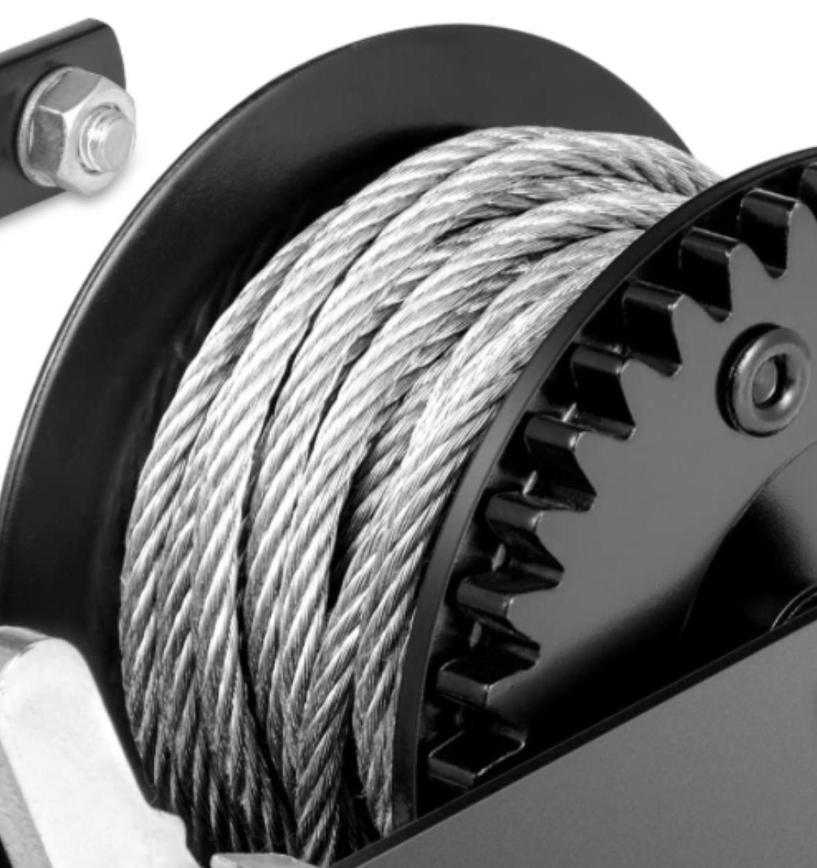

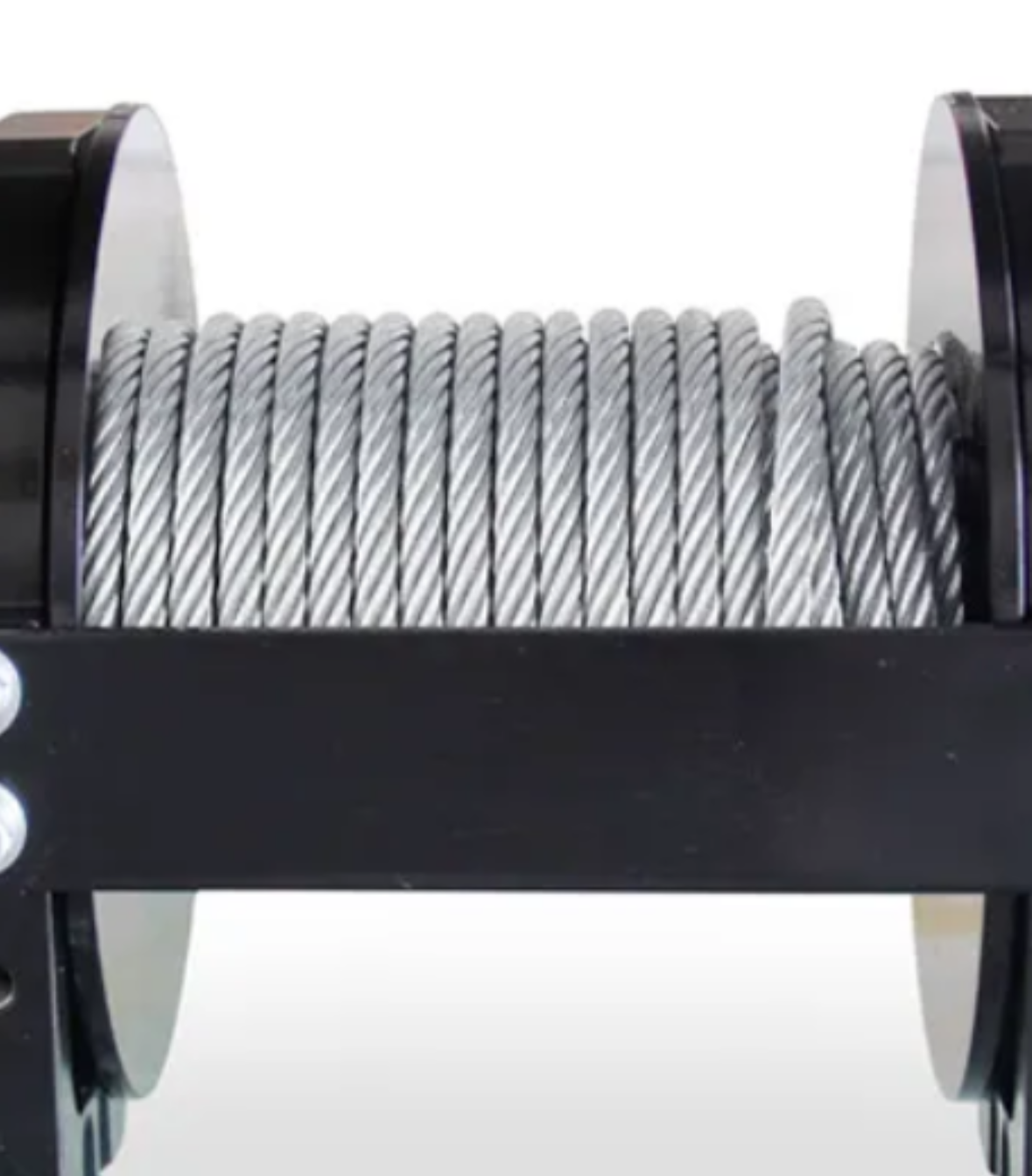

One thing I found with mine that I always felt was a bit of a design flaw, is in the way the wire winds round the drum when you turn the handle. The way the machine has a slight pull to the side in the cable makes the cable pile up on top of itself, so I tend to manually "steer" the cable as it winds so it spreads out neatly across the drum, as piling it up on top of itself damages it if the whole lot re jiggles, and it also causes the board to drop. Wound neatly in layers that go back and forward over themselves the behaviour is much more predictable
In short, as you wind push left/right on the tense cable so it ends up looking like this:
Not like this:
Wear strong gloves whenever you grab ahold of a steel rope, and individual strands can break and end up sticking out of the rope like needles; they make a real mess of your skin
Not like this:
