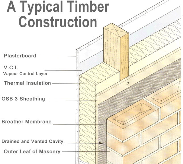

Please explain what the difference is between a timber frame house construction that will be (from internal to external):-
Plasterboard => VCL => Insulation => vapour membrane => ventilated cavity => brick skin

If it was a timber frame construction you would have a breather membrane over the OSB to protect the exposed timbers. With insulated plasterboard, if you follow the manufacturers installation instructions you don't need it - in all the insulated PB I have used there is an internal membrane over the foam core.
A timber frame is a specific form of construction, a structural frame with a rainscreen cladding. It is not the same as lining the inside of a wall with timber.
Essentially there are two principles or risks with any external wall - the first of penetrating damp from the external face, the second is of interstitial condensation within the structure - whatever that structure is comprised of. Both risks can be dealt with by including or excluding a cavity.
But fundamentally, the idea of trying to create a ventilated and drained cavity on the inside of a room is problematic and wrong. The only time this would be done is in a basement.
