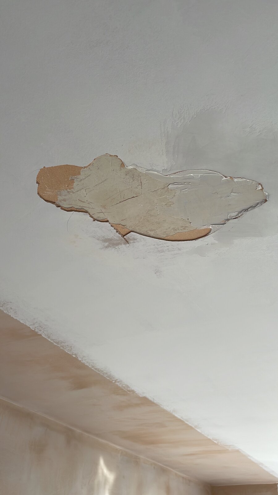

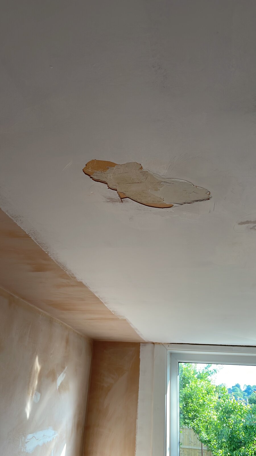

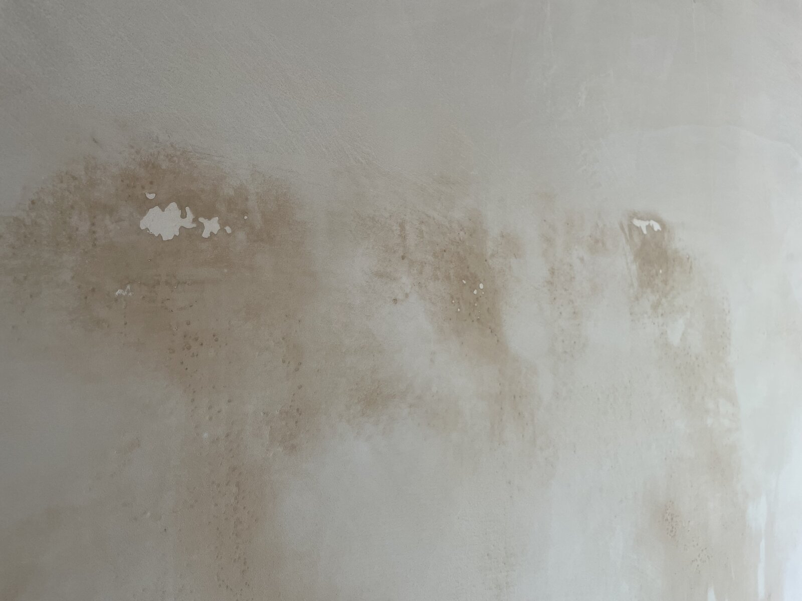

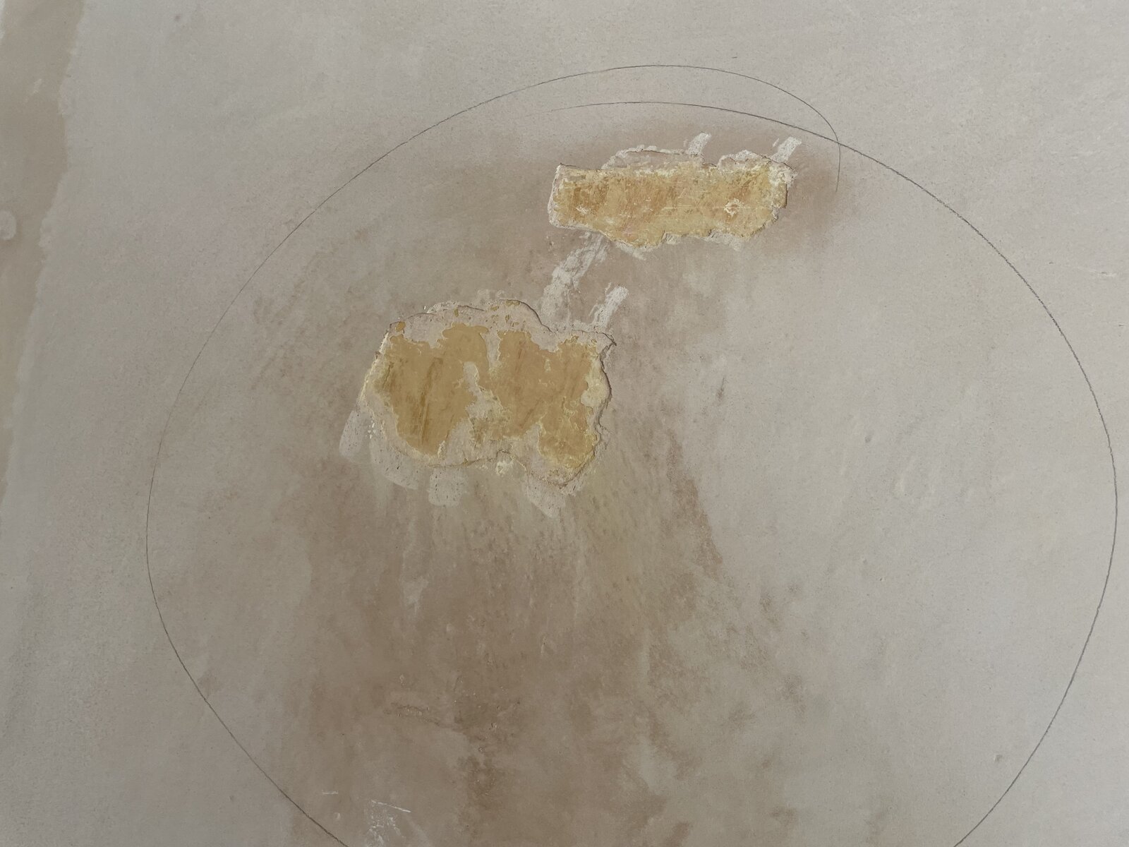

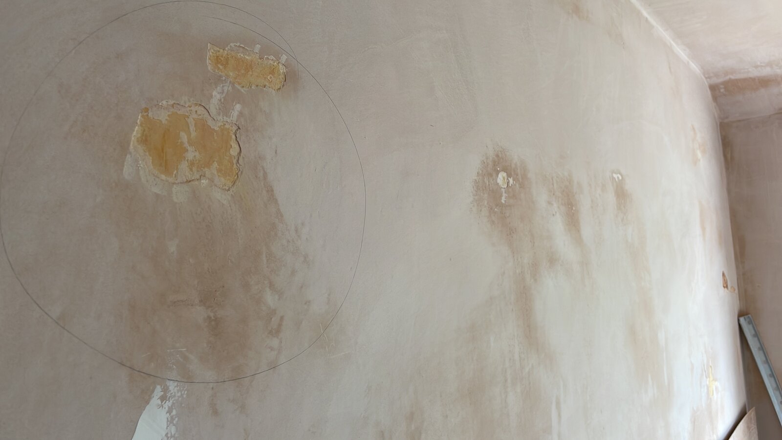

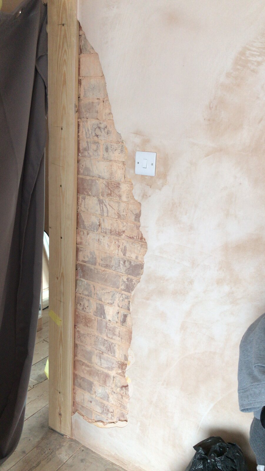

Hi all,
I recently had my entire house skimmed. In the six months following this. I had a number of hairline cracks show on the walls and, according to what I understand, this is normal as the house moves so i simply filled the cracks, sanded down and proceeded to mist coat. However, these cracks have since got worse and more are showing and some are actually flexing (coming away from the wall) with large portions of the wall (lime render) coming away at some points (see image below). I called the plasterer and he said it had blown and I paid him to bond and reskim the issues. However, these are occurring everywhere now. I have spoke to a few plasterers and have said that the plasterer should have sealed this prior to skimming? Should he have checked it was lime render prior to commencing work or was that down to me? I also spoke to the lime Cornish company after testing a small sample of the render with vinegar to check it was lime and they also said he should not have used gypsum multi finish over lime render.
Some have said to remove old lime render back to the brick which I know is a lime mortar. If this is the case (which would essentially mean I have wasted days and thousands of pounds), I am thinking of have the place boarded out (dot and dab). However, I do not want any more issues. I have been reading up on how to ensure a good seal between the wall, the board adhesive and the board. Some say pva, some say sbr and some have recommended different products. I am not carrying this out myself but I certainly want to understand the correct process to avoid another situation like now. If there are any reputable plasterers in Exeter, Devon, who are interested, please give me a shout.
Disappointed is not the word. I have attached some images below (the two smaller ones are where the skim come away from the ceiling after a light sand).

If the background is lime render on an internal wall then using the gypsum multi finish would be OK. Otherwise use Remedial finishes such as Limelite etc.
But if its an outside wall, or a wall that has previously received remedial treatment, then no gypsum should be used.
From the pics it seems the finish is delaminating/shelling from the background because of poor prep ie. the suction wasn't taken up before the finish was applied.
Sometimes its best to use a couple of coats of 50:50 Pva or SBR etc. before the skim or even before rendering the background brickwork.

I'd start by removing everything that's blown and see what's left. You can tell by knocking - if blown it will sound hollow. Even if extensive it could be salvaged.

As for the ‘shelling’ that would explain some of it but really it is all over the place so I am unsure. I’ve had another plasterer take a look and he believes it is limewash and it could be that making it flake and weaken. He recommended removing the hollow sounding render and bonding and skimming this but given quite a bit of it is hollow (probably 50%) he suggested either reboarding and skimming or knocking all the render away and skimming.

Hi, yes that is basically what another plasterer told me to do. Not sure if this helps but where all the cracks have formed and that weird shelling/flaking plaster has occurred, it is hollow.

How about trying this: using any steel trowel or a taping knife, slide the blade under the skim and prise off the skim finish only not the background render.
You will be purposely shelling the finish.
Try it on one wall only, & see how you get on?
