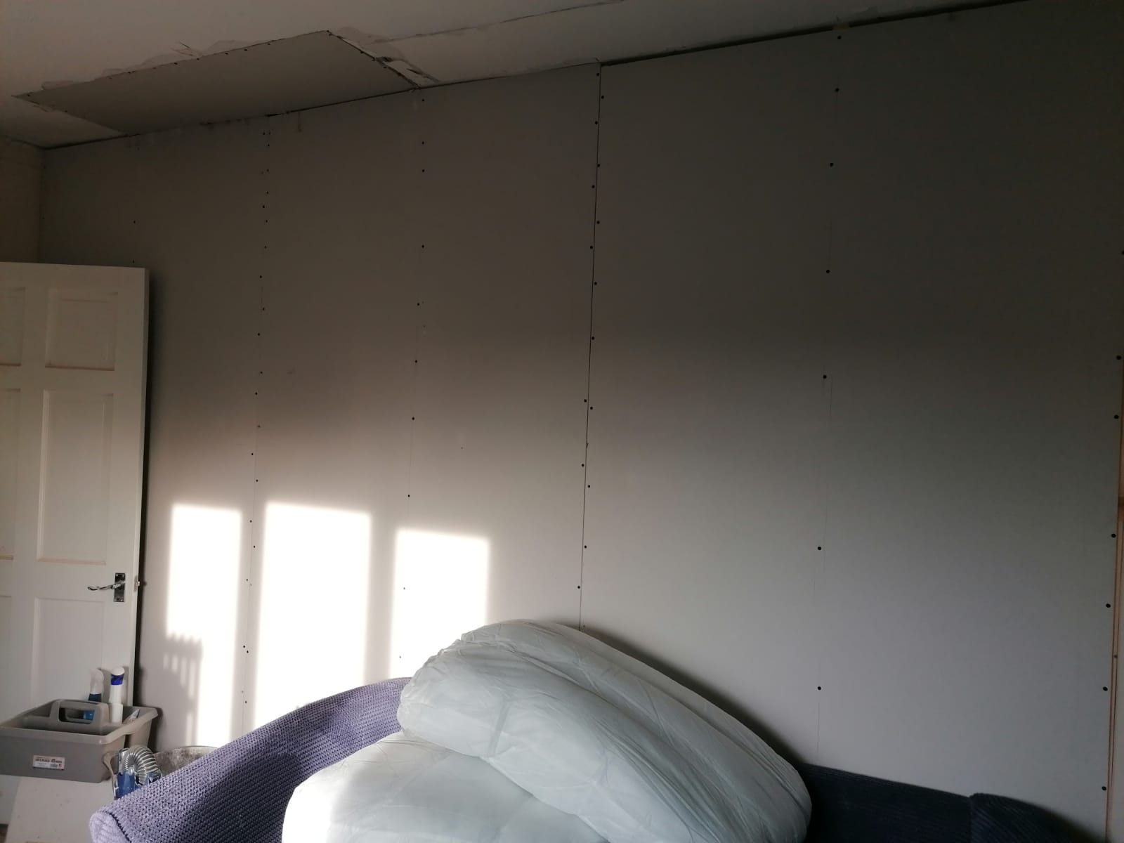

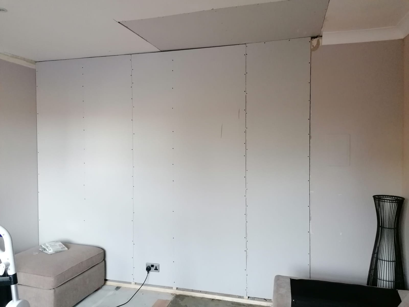

After chimney removal my daughters house needs a couple of ceilings patched, can they be skimmed or is it advisable to have entire ceiling done?
Its easy enough to patch and skim to match existing but it depends on the state of the ceiling.
Pics of the ceiling holes would help?
Just received quotes of £300 and £900 , second quote, plasterer wants to do entire ceilings. There is also about 6m of new plasterboard on walls which is also in the quote for just a skim.

Thanks for the pics.
Your call ref ceiling and walls and prices.
Doing the whole ceiling would make meeting at the walls easy for the board skim but if coving is going up its irrelevant.
But I would simply skim the ceiling patches, and after taping I'd leave it a little, and then press the taping well hard with the trowel to squeeze out a little fat - then use the fat to take the taping to nothing. Be cautious with water, only use a little or non if possible.
Can't see any screws in existing ceiling around edge other than new board edges? I' like to add screws on both sides of join and along wall edge. No flex causing cracks.
Also top of wall needs wood across then screws to stop flex between wall and ceiling join. Also something for plaster to push against if a gap like you have or will fall through a bit.
I like to fit board level with existing ceiling or hard work dragging out to get level.
If I patch skim I go back and sand and fill edges then prime so no call backs from that join to existing ceiling showing, which is why some will want to skim the lot. Call backs are a loss so to be avoided. Can avoid by skimming the lot.
