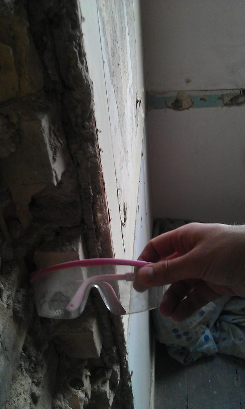

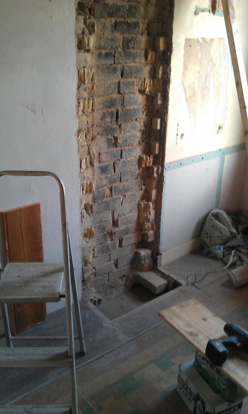

We've removed a chimney from the room, and the recess left is pretty huge. Goggles for scale. It's around 100mm in places.
Firstly, what do I fill that void with? Bonding plaster, or some type of cement mix? And then skim over the top with multi-finish?

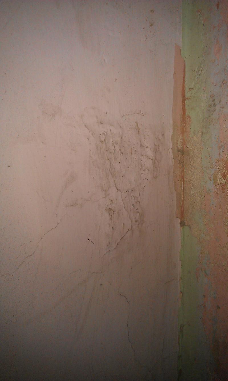

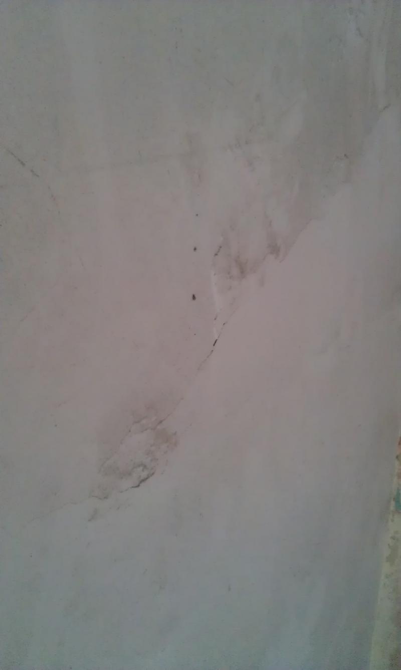

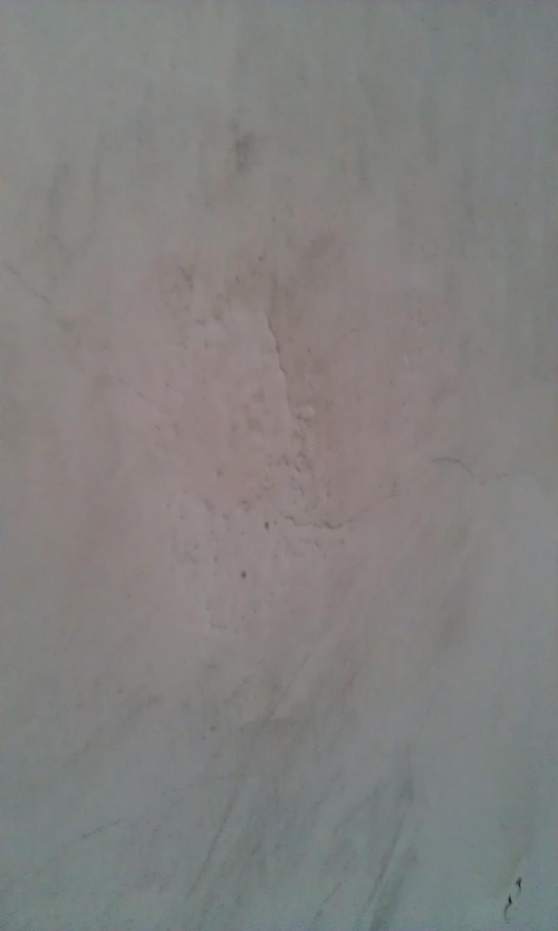

Secondly, there's no obvious damp, but I think the plaster has bubbled up in various places. Or maybe it's just bonding plaster? It has that bonding-plaster type of texture. It sounds pretty hollow when you tap it. Could that be what people call "blown plaster"? Could that be caused by damp, and if so does that affect what I need to do in order to plaster this wall? Here's are some pretty useless photos of some of it. :confused: It's not very photogenic.

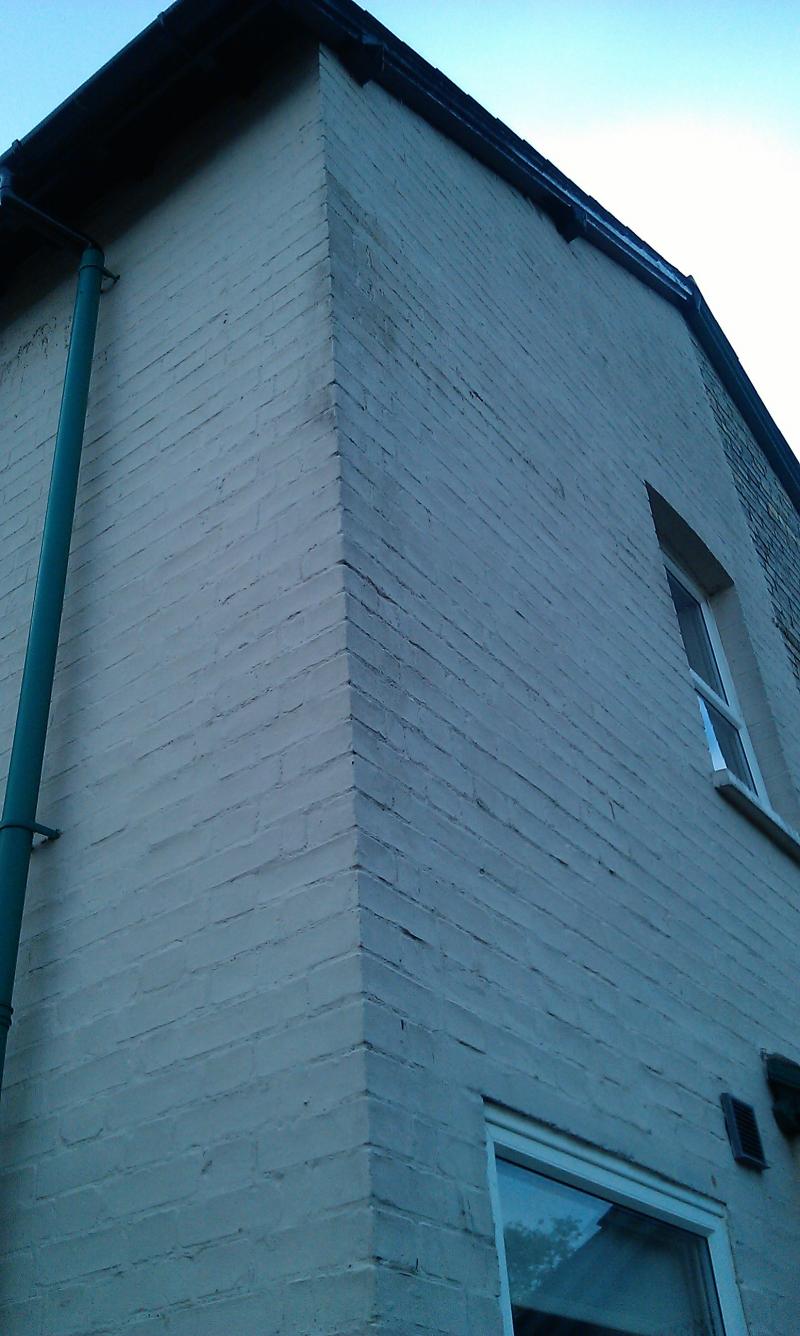

Oh, and here's a photo of the exterior walls, for no reason other than to illustrate it's been painted :)

You wont fill the recess with plaster, build it back in with some 75mm blocks or bricks, cutting the backs of where tight.
Then backing plaster to bring level with existing wall, knock of any loose plaster and re-do.
Pva the whole wall and re-skim, tape any joints/cracks prior to skimming.

I think I've exaggerated the depth of the void. In places it gets to near 100mm, but it gets thinner at the top, down to about 30mm. I could do a bit of blockwork, but most of it is too thin.
Is there anything else I can do? Something with plasterboard? :confused:
I would put horizontal "battens " across the wall all the way up then put a straight edge across each batten then fill it out to about an inch off the straight edge then plaster board it then bonding then skim. you can feather either side in then tape the joints before you bond it.

What's the bonding for? Just PB and skim. Personally I'd use Celcon block with an old saw to trim it up. You gotta use a bolster to trim them there bricks up. Have you used a grinder on them? Must be mad if you did.
Ha. No grinder :) I used a bolster, but they were quite brittle and didn't split very well. I previously thought I could just fill the void with plaster or render (possibly a few layers ;)) so I wasn't worred they were uneven. Maybe battens and a piece of plasterboard are the way forward though. I s'pose if I even up the bricks I can just put a piece of plasterboard neatly in there. Certainly sounds easier than putting up blockwork.

As Roy has said, easiest way is studding out, packing boarding, bonding and skim.
What you got to watch is if its a 225mm solid wall, what you have cut out leaves about 100mm, ie the outer brick skin.
Mind you dont have further damp problems.

Oh, sorry. That's not the outer wall. The one with the chimney on is one of the inner ones. I don't think I'd have had the balls to take the outer skin down to 100mm :)
Do we think I'll be OK with gypsum on the exterior walls? I have to go buy it all tomorrow, as it's double bank holiday on mon-tues.
It looks like lime backing on the wall with the cut out stack, you should replace like for like, the walls need to breathe, this is more for a spread who has knowledge working with lime plasters.
The inner walls will be okay done in gypsum plaster.
