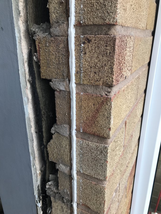

What would you put on the edge here to make as neat a finish as possible.
I have to do the prep for the plasterer coming Friday!
Patio door has come out so want to keep the rock as it is in the conservatory to right of pic and finish the reveal.
I'm hoping to board up to the existing plaster so he can tape the join and skim over but although there are stop beads they seem to say they are for two coat plaster?
Any advice much appreciated!

I would put a stop bead in fill the gap between the bead and the existing finish with bonding or hardwall and then skim the lot
