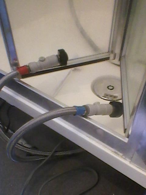

I've removed an Aqualisa shower processor but the the hot and cold flexi pipes are still attached to the plastic plumbing outlets so the water is off.
Are blanking plugs available for plastic plumbing?
May decommission the shower due to leaks and faulty valve but I want to turn the water back on for now.

The two braided flexible hoses have isolation valves , do they not work ??
Never actually tried them but I debating fitting a Mira mixer shower to work of the comby boiler so the flexi pipes would need to be removed anyway.
Found this which I presume will seal the end of a plastic pipe.
When removing the shower processor, the flexi pipes twisted in the plastic elbows. Hopefully no damage or leaks when the water is turned on.
The stop ends that you linked to can indeed be used on plastic pipes ,and the pipe must have a suitable pipe stiffener inserted into the pipe end.
