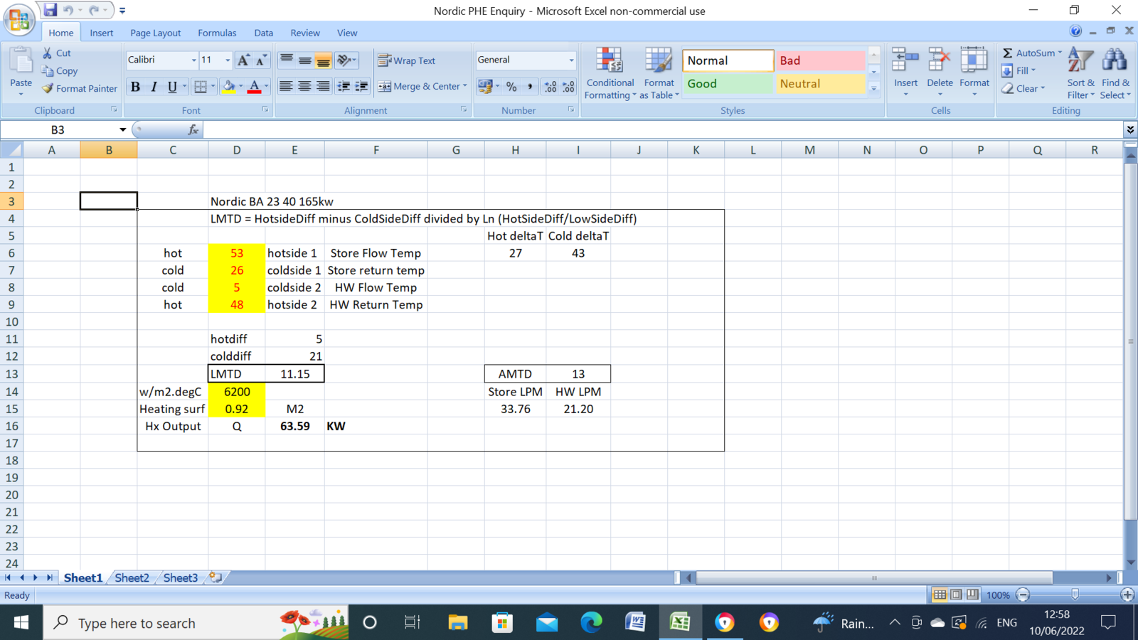

Someone familiar with PHE calculations (SimonH2??) might have a look at this and comment/correct.
Someone asked me to have a look at the output from a Nordic BA 23-40 165kw PHE, all their PHEs have a heat transfer coefficient of 6200W/M2 deg C. the known inputs are primary flow 33.76LPM at 53C, required secondary temperature 48C from cold water at 5C, my calculations below show that the 0.92M2 Hx should give a output of 63.59kw with a secondary flowrate of 21.2LPM. Nordic technical inform me that a 1.98M2 Hx is required (closest Hx is their 2.24M2) to give these outputs/flowrates, am awaiting a reply as to why this is.

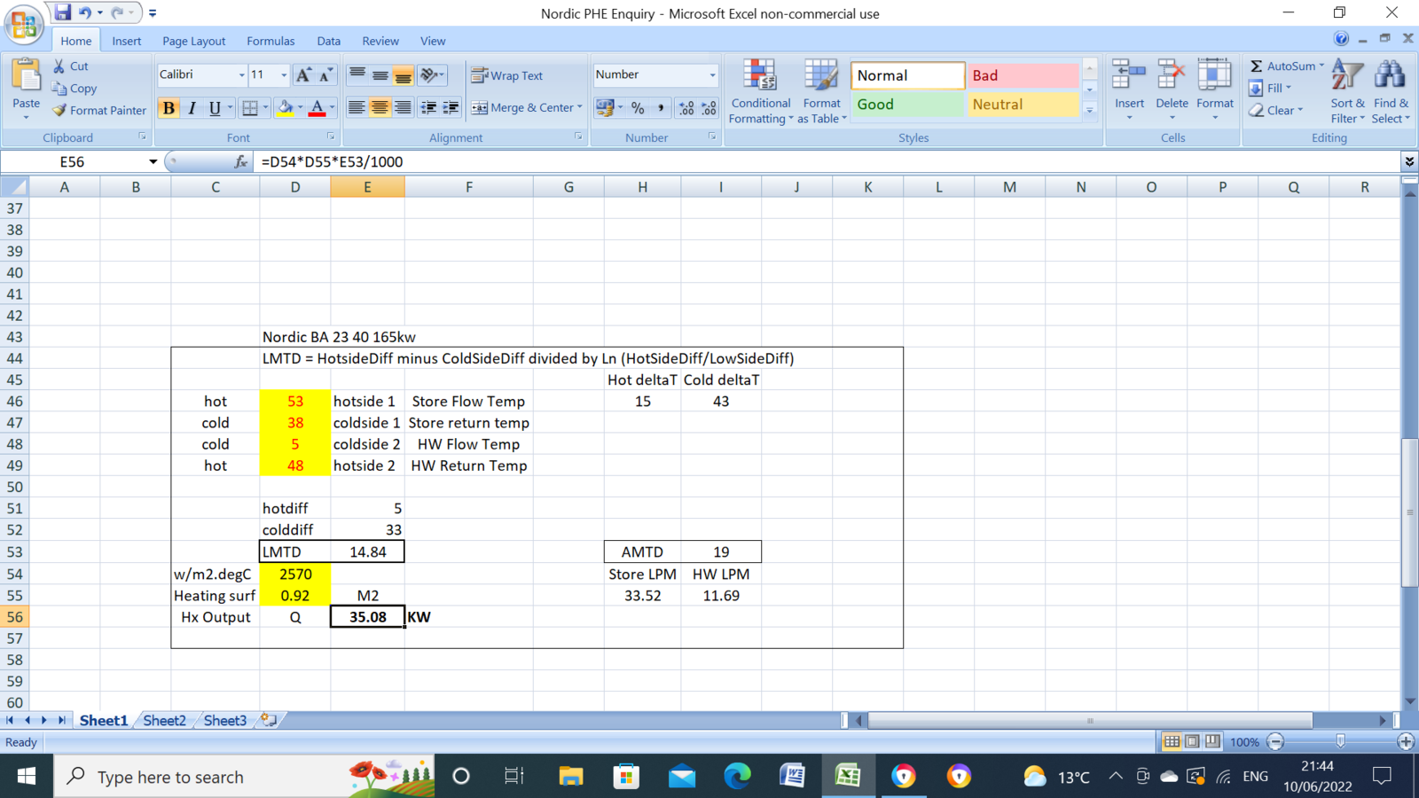

I also asked Nordic what performance they expected from the above and they replied.......
Side 1) - 33.76 l/min, inlet temp. 53oC
Side 2) - 12 l/min, from 5 to 48oC
Then 35 kW

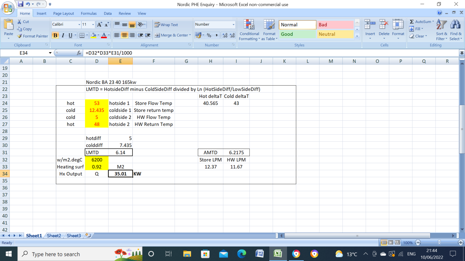

The only way I can "achieve" this is by reducing side 1 flowrate to 12.37LPM (from 33.76) or reducing the heat transfer coefficient to 2570 (from 6200).,
