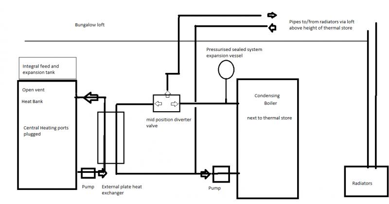

Hi Norcon and Agile. Yes I did it myself and yes you are right, I have connected both flows in the same direction! Thanks for pointing that out. The pump is flowing downwards which is correct but I need to swap over the CW mains connections to the PHE.
The tank has a port for the boiler flow at the top next to the port flow to the HW PHE. Another port at the bottom of the tank for boiler return. There are are 2 other ports for CH flow and return. I have uploaded a diagram of how I think it should work. Please take a look.
Will this work? If so, do you know if boiler will operate efficiently at optimum condensing temperature in this arrangement?
Are other items required to be fitted such as automatic air valves, non-return valves etc.?

The return to the boiler can come from the bottom of the store (you'll want to move it up when you get the solar installed), the flow from the boiler goes into the top of the store. You'll need to modulate the flow rate, or the return temperature, so that the flow temperature is hot enough to heat the bank top-down - although your heat exchanger setup is poorly designed in that respect and will very quickly de-stratify your store. For my store, I used a TMV in the return line, mixing hot water from the boiler flow with cold from the store bottom - in my case I still have a non-condensing boiler and so wanted to avoid condensing. From an efficiency POV, you would want to keep the return to a condensing boiler as cool as possible and vary the flow rate to get the flow temperature you want - but obviously there are limits imposed by the design of the boiler.
Stratification is important - and also (in part) why I decided on a thermal store rather than heat bank for my flat. To get optimal results, you need (as someone pointed out) contra flows in the heat exchanger AND to match primary flow rate with DHW flow rate. If you can match the flow rates properly, you'll then be able to return cold water to the bottom of the store that is only a few degrees warmer than the incoming mains. The colder you can keep the bottom of the store, the more effect you'll get from your solar when the weather is marginal.
However, as you have it, your return will never be cooler than your DHW flow AND your primary flow rate will need to be at least as much as needed to satisfy your highest DHW flow rate - under any other conditions it will be higher than needed and primary return to the store will be hotter than necessary.

As I understand it, the boiler circuit has to be part of the CH. I don't want a FE tank or anything in the loft, so I intend to have a sealed CH system which requires an expansion vessel.
I assume you are referring to my diagram and not confusing the DHW side in the photo?

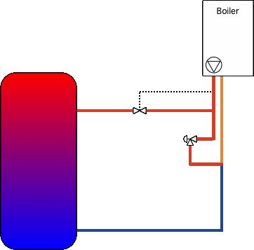

I have a TMV for this purpose but the company who I bought it from don't have a diagram, can you refer me to a diagram somewhere?

Hang on, you are talking about the DHW side now, although I presume the same principle applies.

But back to the original query, I can't see what the problem is - what does the location/route of the radiator plumbing have to do with the boiler circuit ? I'm assuming there is a F&E tank somewhere (hopefully at the highest point of the system) - as long as this is high enough to give sufficient head for the boiler and not too high for the store and boiler pressure rating, then the CH connections are irrelevant to the boiler. All the boiler "sees" is the head from a F&E tank providing a head to a direct cylinder.
OK, you'll already have a F&E tank somewhere - although looking again I see you've got one integrated into the top of the store. Where is this in relation to the rest of the CH ?
But the key thing you seem to have missed is that the CH does NOT have to come direct off the boiler - and there are some significant benefits by running it from the store instead (more if you had a condensing boiler).
I was talking about the DHW side - someone else picked this up, I didn't notice it, but it looks like both the primary and DHW flows are downwards in the PHE. Ideally they should be opposite - probably make the DHW flow upwards and the primary flow downwards. Doen that way, and with the flows accurately matched to load, the return temp into the bottom of the store would be quite close to the incoming cold water supply temp.
Your diagram for the boiler loop does have the flows correct.
See the diagram I linked to. it's the three port valve linking boiler flow and return, and the store.

Bit confused here. My diagram shows my envisaged CH solution so the flow would be hot flow from PHE to top of store because the boiler is charging the store via the PHE. But the DHW from the store has to flow from the top (Hot) to bottom (cool) of the store because the store is heating the mains water. If I did as you suggest, it would mean the PHE being mounted above the height of the store which means air problems similar to what you described for the CH fix, or have I misunderstood?

No I had'nt missed this. I wanted/expected to be able to connect the flow/rtn pipes to/from the rads to the dedicated ports on the store. But then I realised (after connecting it up) that those connections are Direct (no internal coil) and the pipes to/from the rads rise above the height of the store which is Vented and I presumed that this will not work because water finds its own level plus the effect of the CH pump etc I envisaged water bubbling out of the integral FE tank overflow and/or interfering with the other Direct ports.
OK, I can see there being problems getting the rads filled initially, but I can't really see why a loop of pipe going higher than the F&E tank should stop the system working. The pipes are sealed so will not admit air (if they did, then they'd have let water out normally) - they'll just be at a bit less head - about 25' absolute instead of 30' absolute.
Unless you planned to run the CH very hot, and hence the lower boiling point at the lower pressure would have an effect, then it's not going to be an issue once the system is filled. It really will NOT affect any other ports on the store, and you won't have air bubbling out of the F&E tank.
Once filled, the weight of water hanging down one leg of the syphon will balance the weight of water hanging in the other. It won't affect the pump, the boiler, the store, the rads - nothing.
The biggest problem I see is getting the system filled in the first place. If the pump is powerful enough then it should be able to pump water "over the top" and fill the system, but you'll be left either with air in the pipes, or with it being carried over and deposited in the rads. The only difference really is that you won't be able to use air vents (manual or automatic) in the loops to let the air out.

I would give serious consideration to buying a standard F&E tank and putting it in the loft. It will be a LOT cheaper, and a LOT simpler than the messing around you are planning with PHEs and so on.
Is this because it would be a sealed system?
So if I put a F&E tank in the loft, it would not be a sealed system and then I would be able use auto air vents? And I would just use the integral F&E on top of the store to initially fill the store, or should I just fill the whole system from the F&E tank in the loft?
No, because they would be above the water level in the integral F&E tank. So rather than letting air out, they'd let air in.

OK, a couple of diagrams for you to ponder over.
First off, this is a general arrangement as I'd do it - but not including any controls over DHW PHE primary flow as yet - and I've also omitted the F&E tank for clarity. The colour should give you an indication of the sort of heat profile you should normally be trying to achieve in the store to maximise the ability to use the solar panel input (not shown).
This differs slightly from the earlier schematic as it shows the TMV in the boiler loop as a diverter rather than mixer. In this mode, the TMV senses the flow temperature, and divert some (or all) of it to the top of the store when it's hot enough - and the rest back to the boiler return.
The key difference here is that you are controlling the flow temperature while the return is "what it ends up at", while a mixer controls the return temperature and the flow becomes "what it ends up at". There are pro's and cons both ways.
The divert arrangement will give you better control over store temperature. The main downside is you only have indirect control over boiler return temp and in particular you cannot quite guarantee not to go cold enough to avoid condensing. You would normally set the boiler on max, and rely on setting the flow to give the delta-T you want and hence the return temperature. In practical terms, for a given flow rate and a given boiler output, you will get a constant delta-T.
The mixing arrangement means you can control the return temp and thus avoid condensing. The downside is you have only indirect control over flow temperature. You can however take advantage of a modulating boiler and let it give some control over flow temp.
I chose the mixing arrangement for my current setup (non-condensing boiler) - I'd choose a divert arrangement with a condensing boiler. I actually have a couple more ideas, but I'll leave them out.
A secondary consideration is that in mixer mode, it should be within the range of a relatively cheap TMV sold for tempering DHW supplies - I picked some up off an "online auction site". In divert mode, you'll need a different valve as this would normally be well above the range of a DHW TMV.

How it should work is that the flow will be controlled so that as the DHW flow rate varies, and hence the cooling effect on the primary, the valve will adjust the flow rate to suit. I'd be looking to set it a little above the prevailing cold water supply temp - I'd guess 10&#730;C higher would be a reasonable starting point and experiment from there. You may need a bypass round the pump to avoid dead-heading it at very low DHW flow rates.
Note that the sensor bulb ideally needs to be inside the PHE port so that it can sense the temperature even if the valve has fully shut and there is now flow - otherwise you could find a situation where the DHW goes cold until the pipes lose a bit of heat and the valve starts allowing some flow.
On the right is an arrangement where the primary flow rate is controlled from the DHW flow temperature. It will only admit as much primary flow as is required to heat the DHW to setpoint.
Note that neither of these is a good solution from a control engineering POV. Controlling PHEs by varying flow rate is very difficult to do accurately and stably so it's generally avoided if possible. Normally you would aim to keep the primary flow rate high and vary the loop temperature as this gives good control - which is the starting point in the thread I linked to earlier. Because the temperature differential between primary input and secondary (DHW) output tends to be quite small if you keep the primary flow rate high, you can in fact get quite good control of secondary (DHW) temperature by only controlling primary loop temperature - thus eliminating the TMV in the DHW side.
That's the arrangement in teh diagram here if you imagine the lower PHE isn't there.
With a single PHE though, this means the primary water you return to the store will be quite warm (or even hot) most of the time - although at a much lower flow rate than with an uncontrolled flow.
This is one reason I went with a thermal store rather than heat bank in the flat.
After a little more thought, but drifting off topic a bit for the OP, this is how I'd probably connect a condensing boiler.
With boiler set on max, the thermostatic valve will regulate flow so maintain desired store reheat temperature.
From cold startup, the automatic bypass allows just the minimum flow for the boiler to operate safely. Once the thermostatic valve is opening, the differential pressure will drop and the bypass will close. The return flow to the boiler is as cold as is practical thus extracting the max amount of heat from the gas exhaust.
