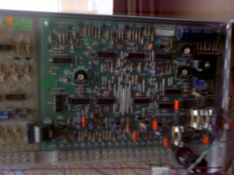

Hi,
Could someone please help me out: Over the weekend i decided to do some cleaning up in the attic and have accidentally snapped the alarm cable!!! I thought it was an old aerial cable so i decided to get rid of it, turns out i have cut the main alarm cable! Both bells went off an the box says "tamper" on it. We waited for the batteries to die in the bells and then have turned the mains off as well as disconnected the battery inside the alarm box (have obviously re-connected the 6 smaller cables inside the cable that i have snapped) but still no joy, it says temper on it and we cant even set the system...
On the inside of the box it says to reset the system: 4 times cut the D30. I have located the D30 transistor (i think thats what it is..) and its already cut, not sure whether the instruction means i should short it somehow.
If anyone has any ideas or advice it would be highly appreciated!
Thank You!

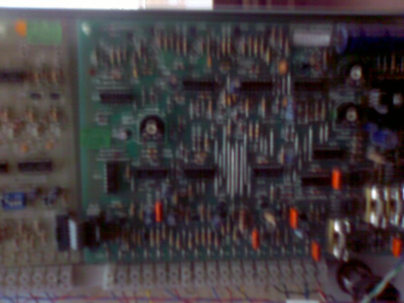

Here are some pictures of the board:

i mean the glass 20mm fuses, there are 4 of them in the right corner of the picture, it does look like what i know as a watchman.
I doubt if any one else knows what one is they are very old, probably older than some posters (yes they are that old)

Thank you for the fuses hint, found one that was blown!

I have had a look at the fuses and one of them is blown!!!! So i ordered some of them ancient glass ones off fleabay so hopefully this will sort the
"temper" side of things, but not sure it it will cure the bells... also need to find a battery somewhere to replace in all the bells.... they are actually soldered on to the chip inside the bell...

you wont find a number on it, most alarm engineers have never seen a watchman panel, most modern panels have a number, the watchman doesnt.
the bell battery will we directly soldered onto the pcb, not the chip.
are you any good with a soldering iron? take the old one out and look for one same size characteristics, i would gues around 7.5v.
But, as your alarm is so old, i suggest you dont bother with that battery, its only there to make the bell ring if the supply to the bell is removed.
modern sounders have a 20 min cut off in the bell, yours is so old it wont have one (the panel has) so if you do get a new battery, and if you do change it
and if the supply to the bell is cut, the bell will not stop.
i only say this as you are doing diy
