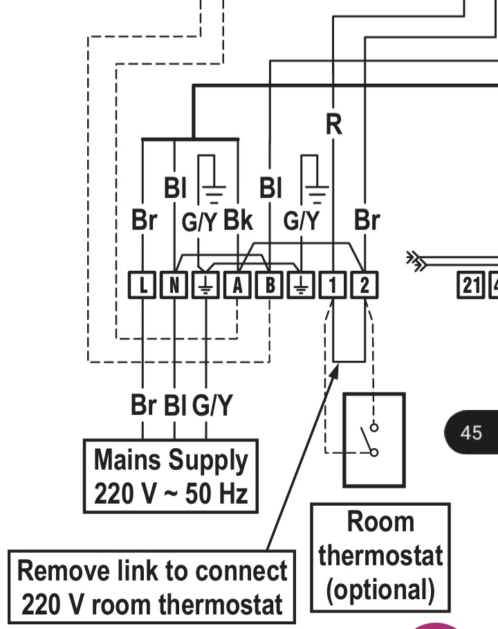

Please help fit Hive receiver to Alpha Intec 28XE combi
1 Oct 2024
13
3

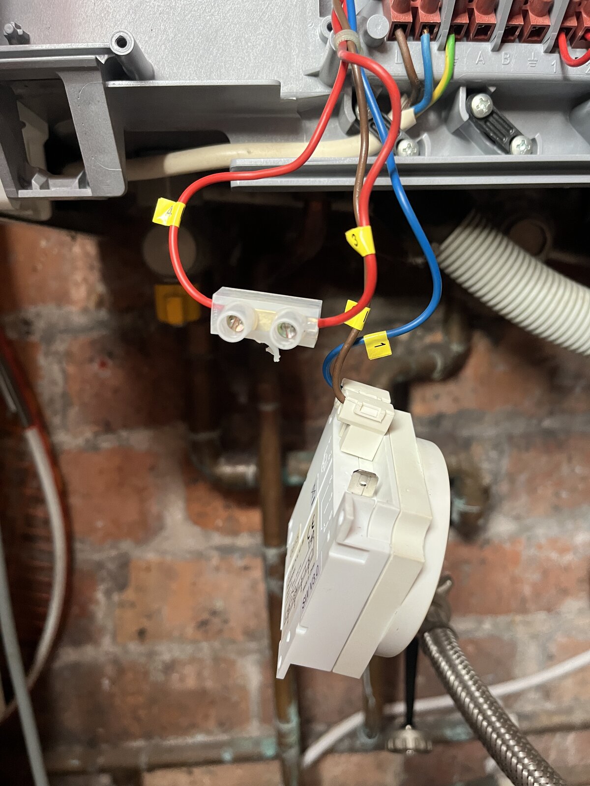

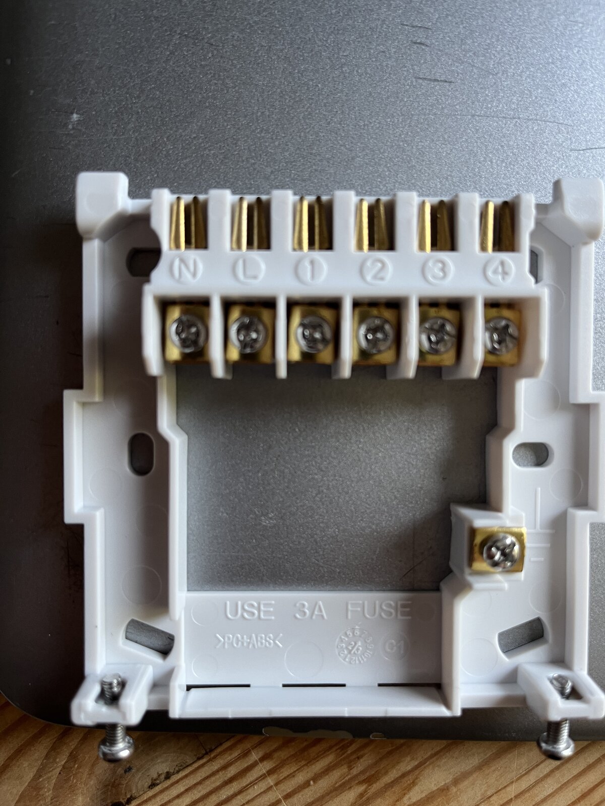

I have the hive receiver in hand - is it as easy as it looks to just wire in N,L,3,4 or is there something else i should know please?

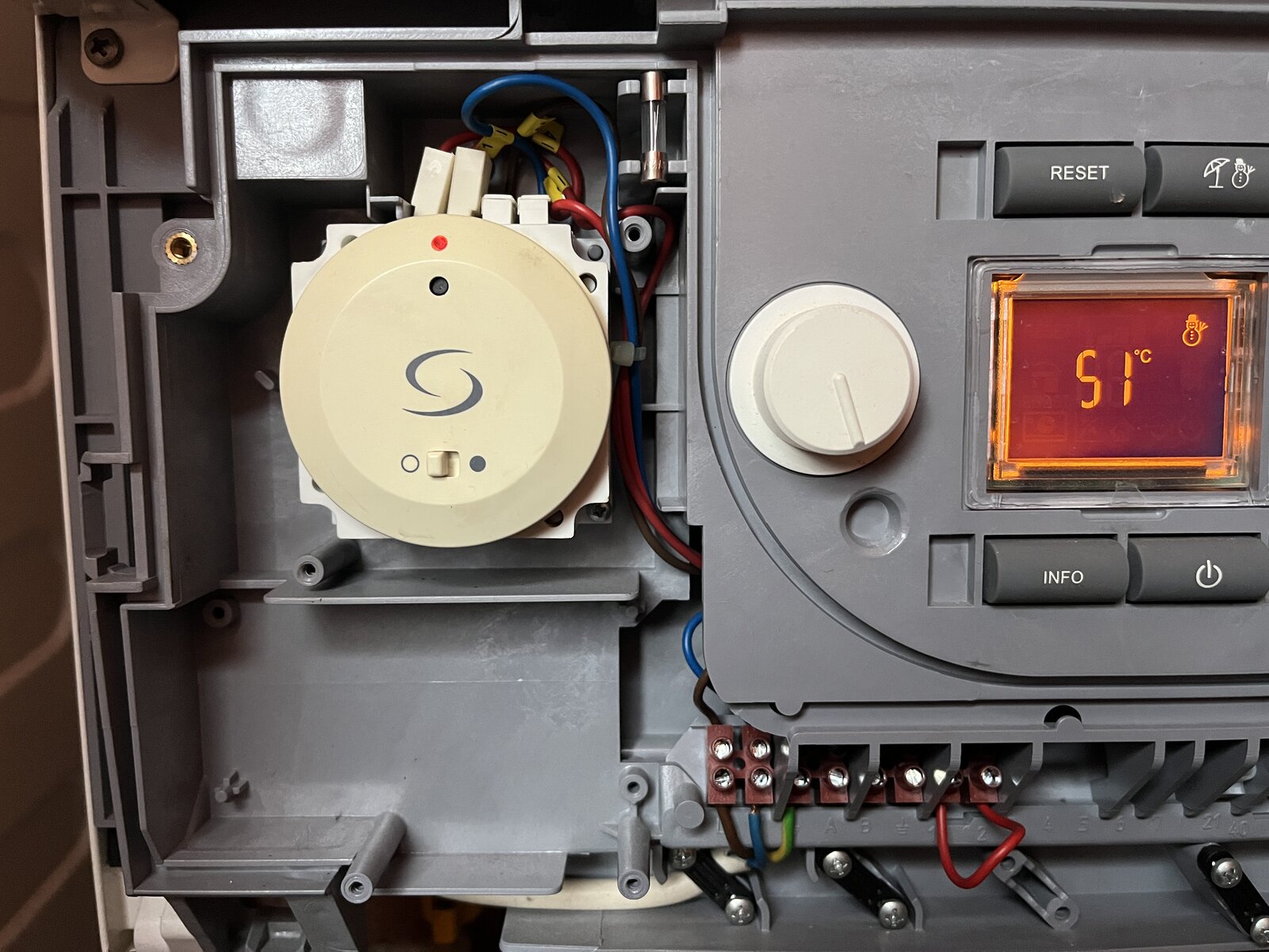

This is what was there and I connected 3 and 4 together to bypass the failed Salus. Thanks
From the other thread...

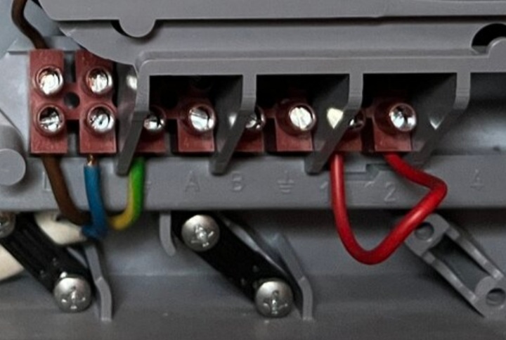

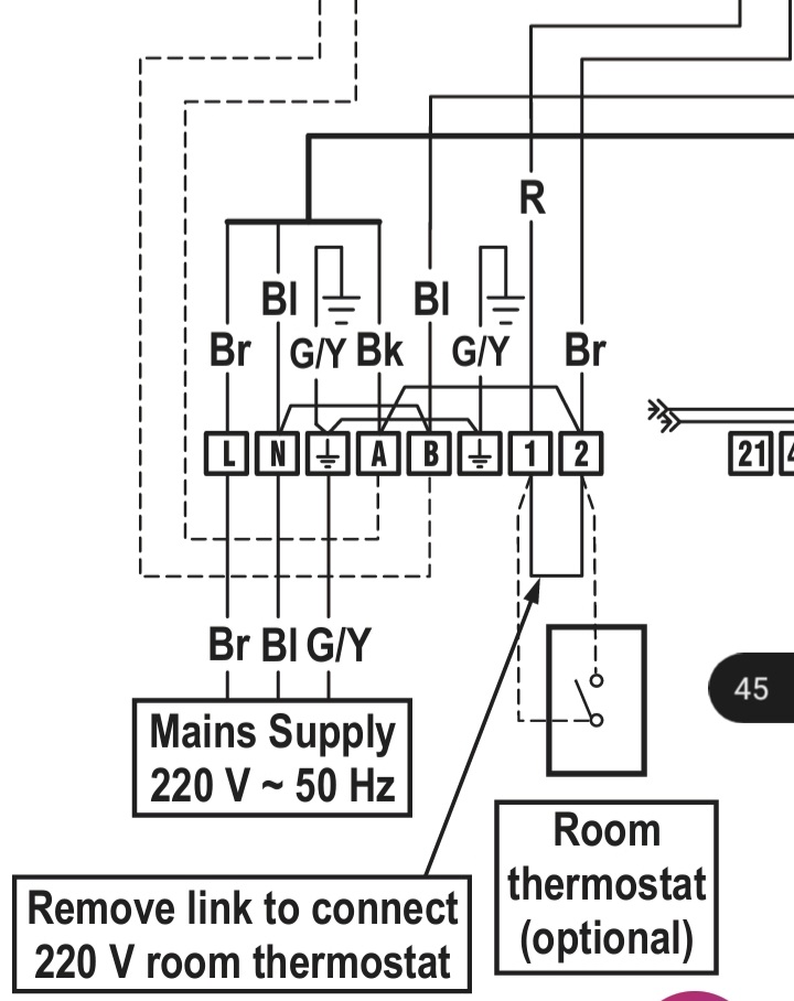

If you want to connect a new on/off thermostat, the power can come from the L, N & E terminals and the switch wires would connect to terminals 1 & 2 (after removing the link)...
Assuming Single Channel Hive...
Ideally with a 4 core and earth cable:
Connect L, N and E on the boiler, to Hive L, N and E.
Remove the red link wire on boiler terminals 1 and 2.
Connect boiler terminals 1 and 2, to Hive terminals 1 and 3 - the order doesn't matter.
Use the cable grips provided, to hold the flex.

Thanks! So to clarify the cables 3 and 4 i have joined by block can remain?
The earth can go to the left of cable 1 on the pic?
Yes, forget about the wires behind the Salus including the L and N.
Use the brown terminal block and the cable grips (as in the image above) - they are there specifically for connecting the external controls.
Yes.

I used the L and N wires from the Salus and did everything else as you stated and all WORKS PERFECTLY!! Thank you so much, much appreciated :)
Well done!
Thanks for letting us know the outcome.
...and we should be grateful for another Salus banished to the depths of hell! ;)
