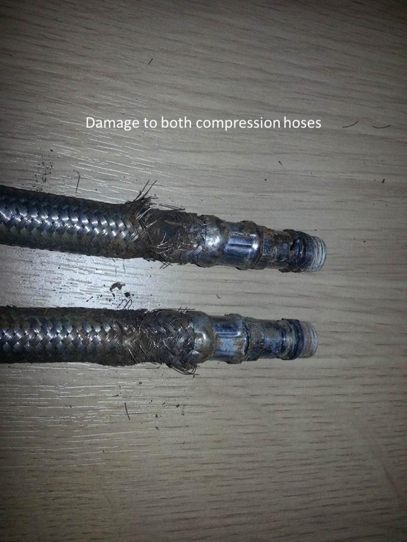

Please help me with an issue/dilemna I have with TapsUK. I bought a monobloc mixer tap from them 2 years ago, installed it and then 2 weeks ago was sat watching telly when I heard dripping coming from my hallway and water leaking out my RCD unit. I went upstairs to find the braided hose squirting water in my vanity unit.
I isolated the tap and removed it to find the braided hoses all frayed and the tap corroded as well as the o-rings damaged.
After a serious amount of arguing with TapsUK and the parent company Utsumi they are trying to wash their hands of any blame on their part and saying that the hoses must have worn due to rubbing causing fraying and that a leak was due to overtightening of the compression fittings. One of the braided hoses was missing an o-ring.
I have damage to my hallway ceiling and have obivously had to order a new tap from a different supplier.
I am an Aerospace engineer and I believe the braided hoses are of inferior quality. Can you guys have a look at the photos and offer your professional opinion please ?
Based on the way they have treated me I really want to take this further. I installed the tap into a kitchen worktop in my bathroom and I fail to see how else this tap can be installed. Plus the taps are braided stainless steel they should not wear like this.

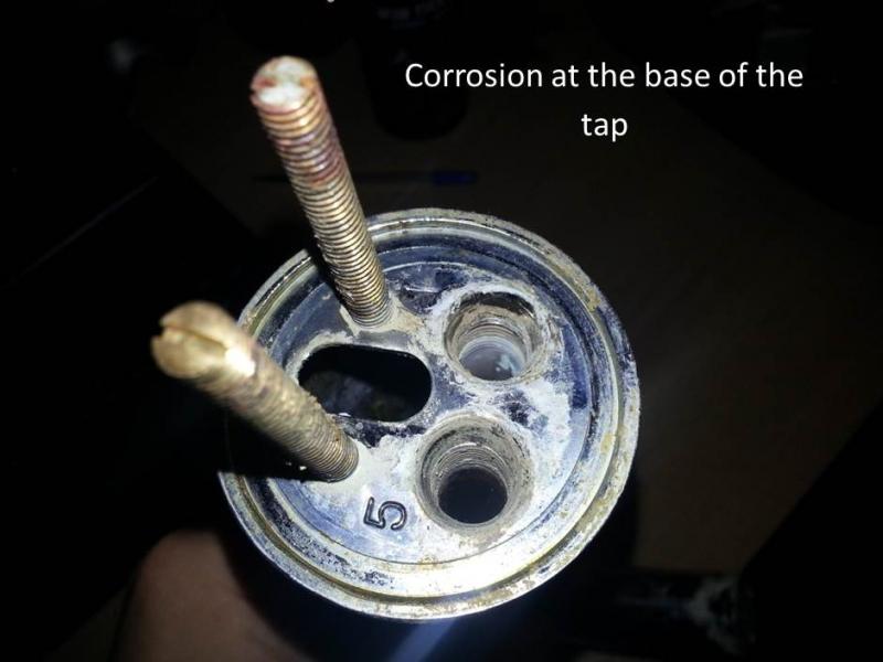

Plus the base of this tap shows evidence of corrosion
My personal thoughts are that the crap quality hoses have been corroded due to the rubbish o-ring leading to fraying and ultimately then the rubbing has led to the rubber innard splitting

Sorry, but you won't like this. If someone brought those to me with a claim after 2 years my response would be:
The installer thinks the hoses are inferior quality.....2 years after fitting them?
The hose braid has failed in the same area on both hoses. Common problem to both hoses, rubbing on the underside of the fixing surface or fitted with too tight bend in hoses.
Corrosion? Looks more like limescale to me.....long-term minor leak.

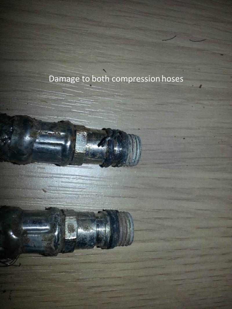

That looks more like damage done when people fit the hoses by twisting them in by the flexi rather than using the hex nut provided on the lower part.
Installation issue for my money. Fitted loads and never had a problem with any. That s/s braid has been mullered. Mullered is a technical term used in the aerospace industry. :mrgreen:
+1
These hoses look like they've been twisted in by hand in stead of a spanner.
If the o ring was missing it would have leaked from installation.
The staining looks more like limescale or soap scum that has crept under the tap body when in use.

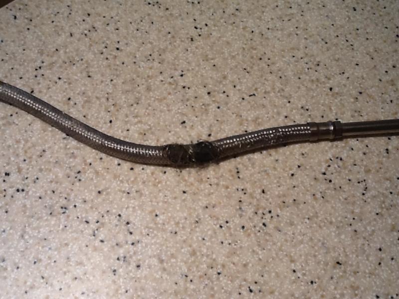

I was looking through the web to see if anyone had a similar problem. We had a new toilet sink installed in a flat just over a year ago. All was fine until last Saturday when the hot water hose, a flexible stainless steel braided hose burst, flooding our toilet and bathroom next door and even worse the flat below and the flat below that. We isolated the feed and called the plumber
He showed us the flexible hose had competed ruptured in the middle. There were no sharp bends in the hose. Also all of the hose had sharp bits of metal sticking out as if it were disintegrating. I cannot add a photo. Can someone please advise ?
My-bathroom, an Ebay shop says it is bad installation. We used a Corgi qualified plumber to do all of our work. The bend was no more than a curve.
Any ideas ? Does this happen often ?
I am now showing the photos. The first one shows the frayed hose, after 1 years use. If you look closed you can see the rest of the hose is not smooth, it has spiky bits on it. The second one shows the shape of the hoses, newly fitted by our plumber today. The original ones would have been in the same shape.
Any ideas ? Really worried in case it happen
s again
Those hoses have failed because they were installed badly, over tightened and twisted would be my guess.
