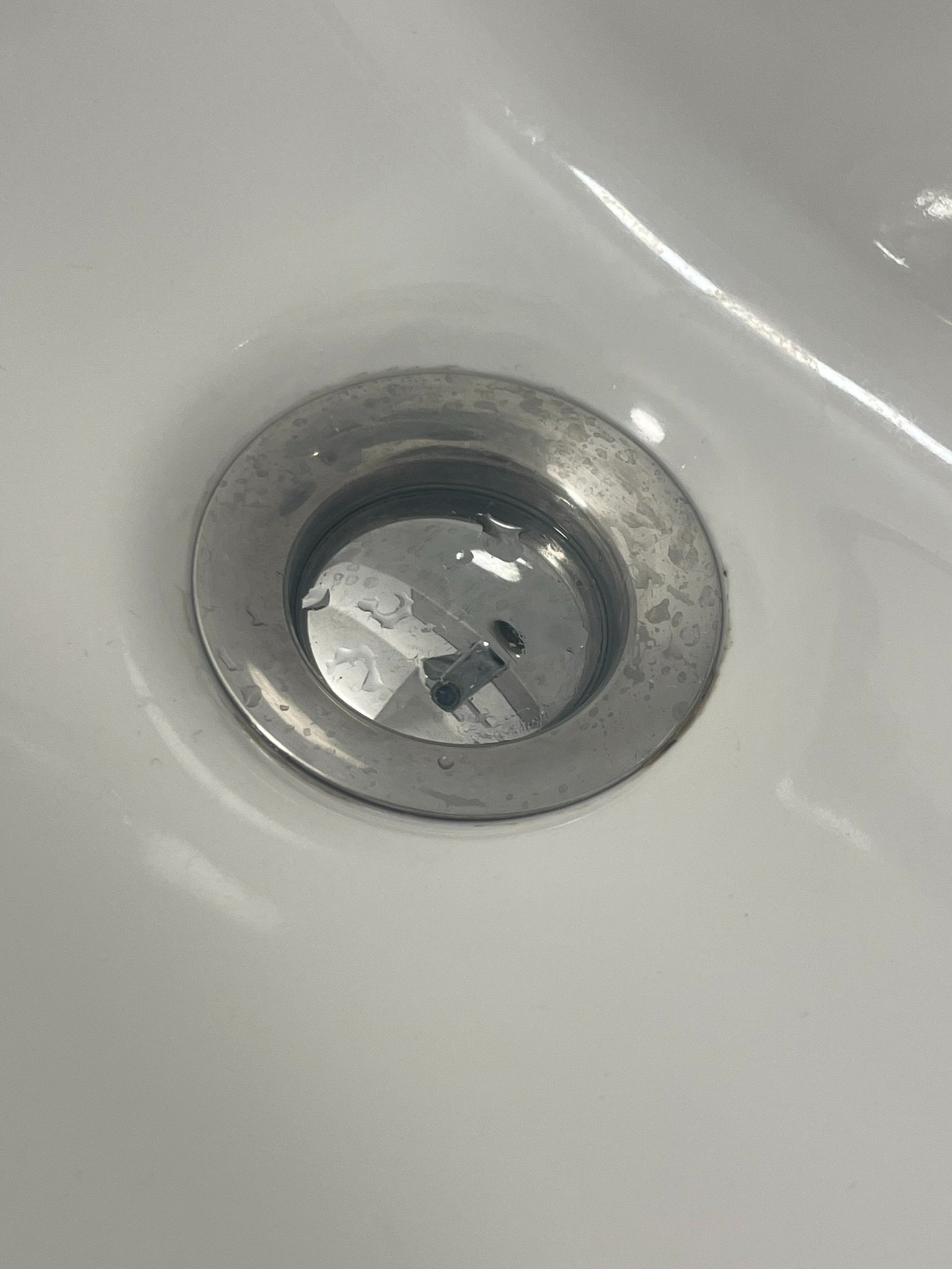

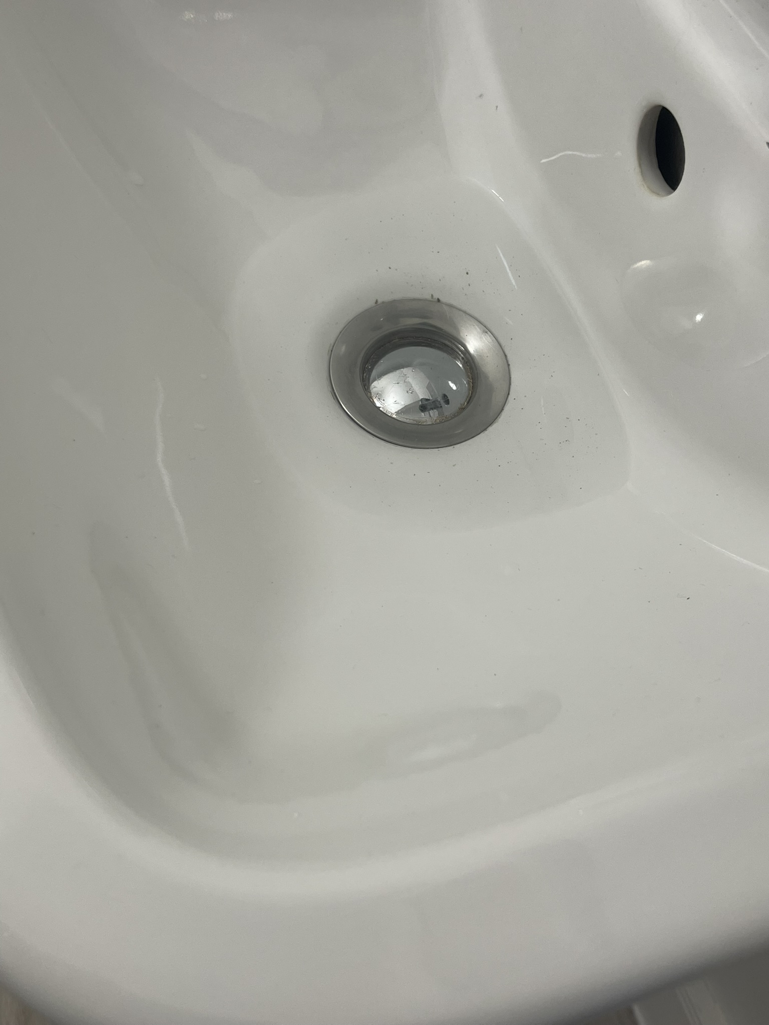

A Plug stopper depressed in sink!
Advice appreciated on how to get out!

I dont have any sort of sucker... and it feels REALLy jammed.... so i dont think a sucker would work anyway... i thought about super glueing something to it and pulling it! (but havent tried it yet).
poured hot water on it and it did start to jiggle abuot a bit... but now i think ive made it worse as it isnt jiggling...
theres not a lever behind taps regretfully
Im not sure how to take the waste out from underneath - do i need to take the entire unit off the wall?

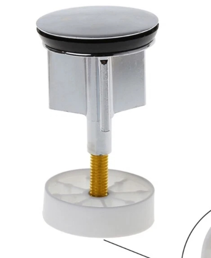

What you haven't explained is the type of stopper - is it the type which you press, and it is supposed to pop up, or is it the type where you operate a pushrod/button, by the tap?
Isn't there any loop/projection/whatever that you could grip with pliers or insert a coat-hanger-wire hook into?
is it the type which you press, and it is supposed to pop up....
not sure what is meant by "isn't there any loop/projection/whatever that you could grip with pliers or insert a coat-hanger-wire hook into?".... theres nothing obvious that i can see...
Repeated question.....
...it is the type which you press, and it is supposed to pop up.
A rubber sucker, should be able to lift it! If you don't have one, have you tried a vacuum cleaner hose end?
If trying the latter method, make sure there is no water in the sink.

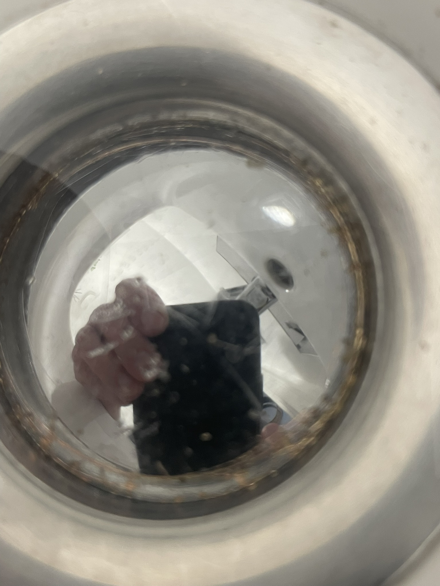

thanks but it is well and truly jammed in.... theres no way suction of that power would work... best i can think is to superglue something to it and pull!! but i havent found anything suitable yet!
we have a shark hoover that does not have an apt hose...
as mentioned unfortunately i dont have any sort of sucker....
I havent tried "Take the waste out from underneath" as i do not know how to do this
It might have jammed because they work on a type of ratchet that hooks on when closed then a spring takes the tension off and latch is released when you press down again ( difficult to put into words). Just undo the plastic waste pipe and there will be a large nut holding the rest into the basin which you unscew and then lift out the waste. If you have no access then you may need a plumber.
