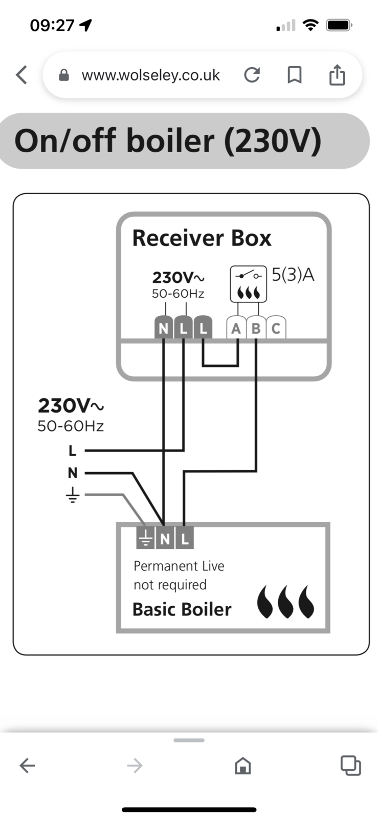

Hi
below is how the Plumb is wired up, i assume as the hive only has 1 live i put the live in and the loop into live and 1 the other cable into 3? as this is a glow-worm combi boiler.
just need some calcification that this is the right way.
Thanks in advanced.
chris
What model of glow worm? If the boiler needs a switched live then you would bridge the live into common and then run the switched live out to the boiler.
The diagram you attached is for an on/off boiler and is not really the norm these days. I would suggest that your combi boiler will have a zero volt contact and that's how it would be switched by the hive receiver.
That boiler has a zero volt (24v) contact, that's what would usually be switched by the single channel hive. It also has a switched live (SL) option.
These days, it is preferred to not use a powered live to actually switch the boiler on and off via a switched live as your wiring diagram shows, chances are your current setup is sending a SL to the RT terminal on the boiler, so the boiler stays on all the time but is fired up by a SL from a programmer/stat calling for heat.
I'd suggest you may need someone in to ensure it gets wired correctly.

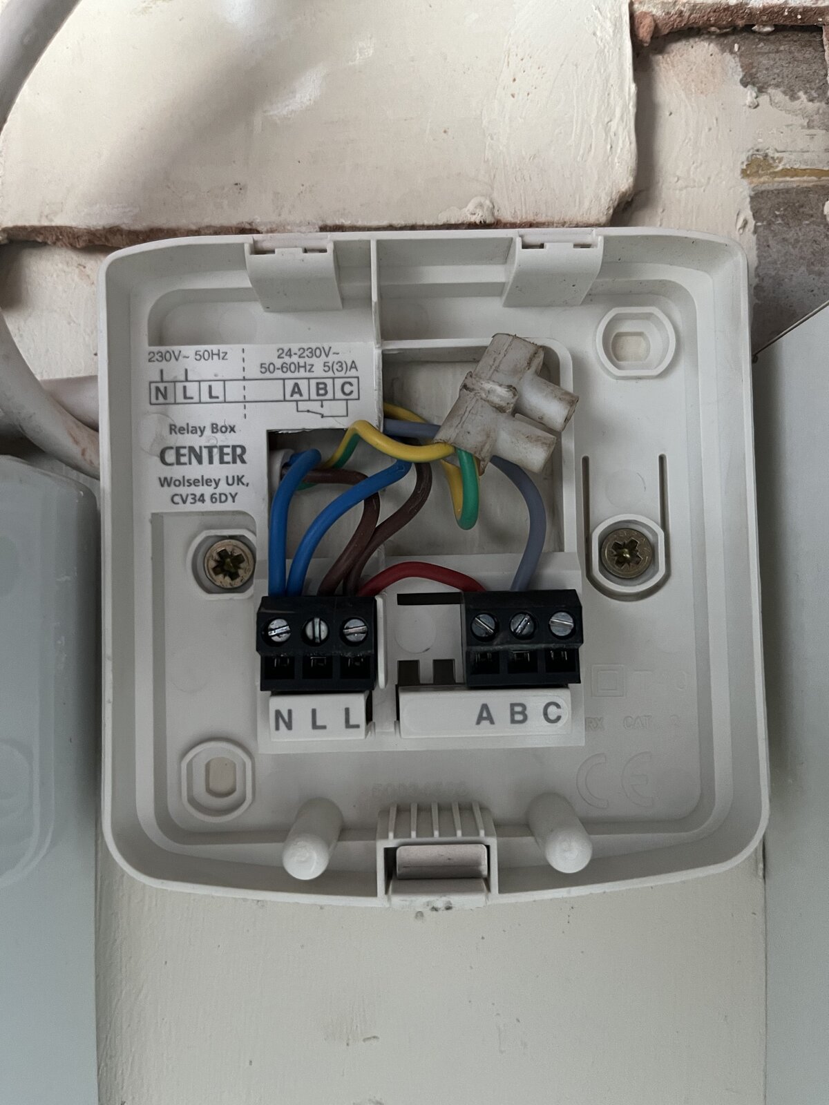

Hi
here is the picture of the wiring. I assume the live loop goes to one and the other to 3
Yup. The single channel Hive receiver can switch up to 240V, so the grey on the B terminal would be on 3 on the hive with a live link from the live terminal to the common (C) terminal.
On the connecter there was 2 L connections so would that also mean 3 wires into the 1 live?
No, just the 2 lives into Live on Hive, or if it’s 230v switching, then put the one from the boiler pcb into common (terminal 1), or else just link it.
Ermm .... Yes to keep the cabling the way it is .... 1 live in from the FCU, one out to the boiler and the link to the common terminal, the hive receiver terminals should be able to take that no bother.
