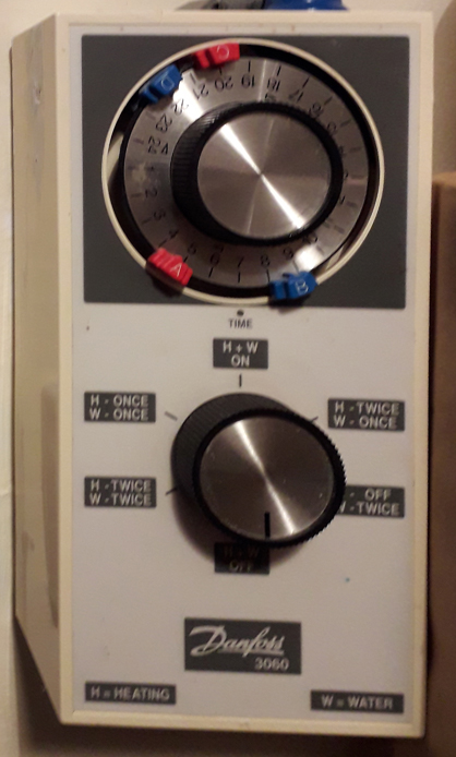

The central heating when I moved in needed you to turn it on at the programmer Danfoss3060programmer_small.jpg then walk down stairs and plug in the pump, the thermostat had the base Sunvic-wireless-thermostat-part.jpg but there was no sender so did nothing, how previous owners used it I really don't know, going outside and down a set of steps to the flat under main house not really a good option in the snow. I would assume they used wood and burnt it in the open fire. That is now boarded off and used as the exhaust for the AC saves opening a window.
