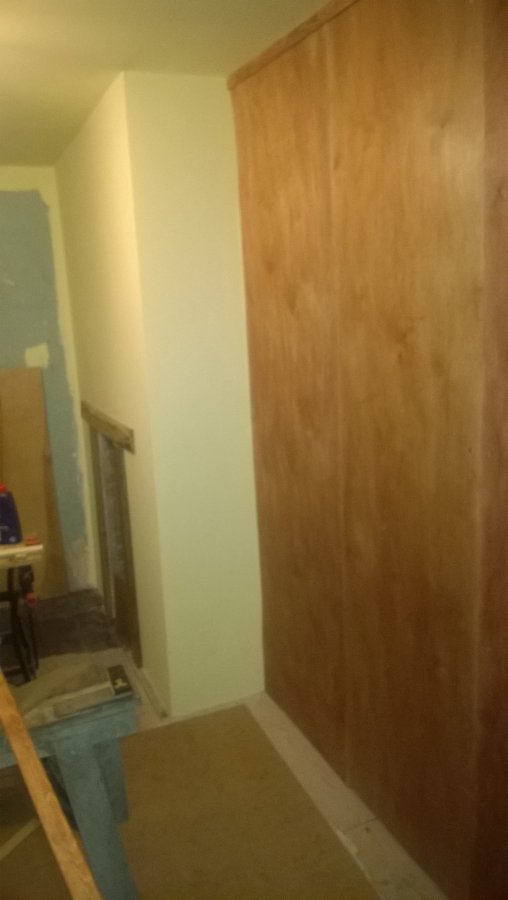

I am also staining the ply mahogany and they look quite good so far. I have one good chimney breast which I have painted a light yellow but the rest will all be wood. It will be lined with book cases of galvinised steel and reclaimed scaffold boards that I am making and another wall with 3 shelves of sliced bark from yew and other wood with great colour and grain.

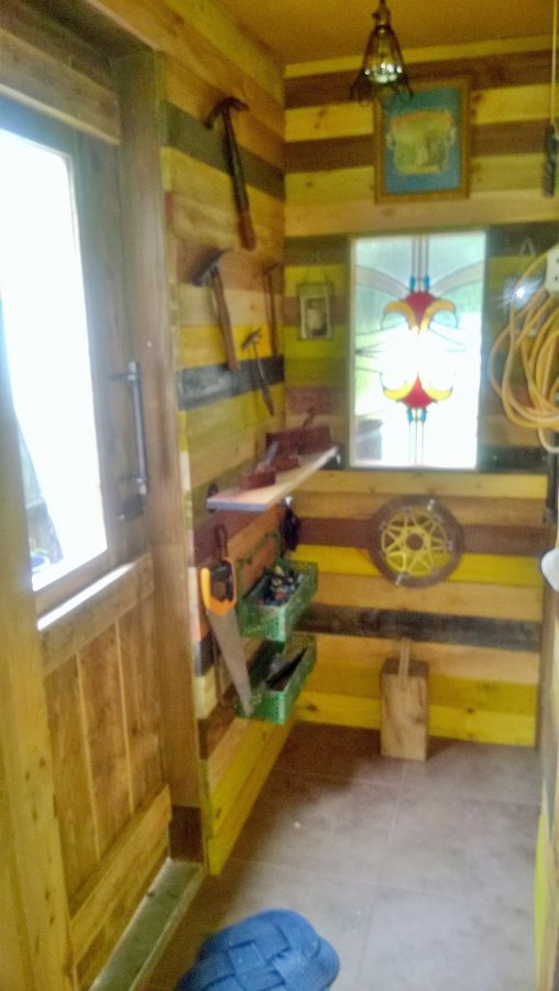

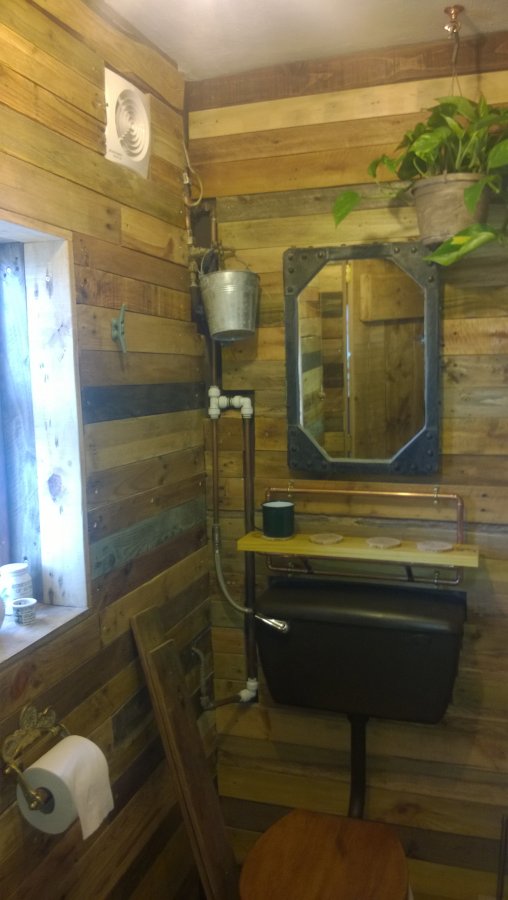

I have previously lined a small bathroom and lobby with stained wood from old pallets.Takes a lot of time staining the wood etc but I reckon it looks pretty good .
