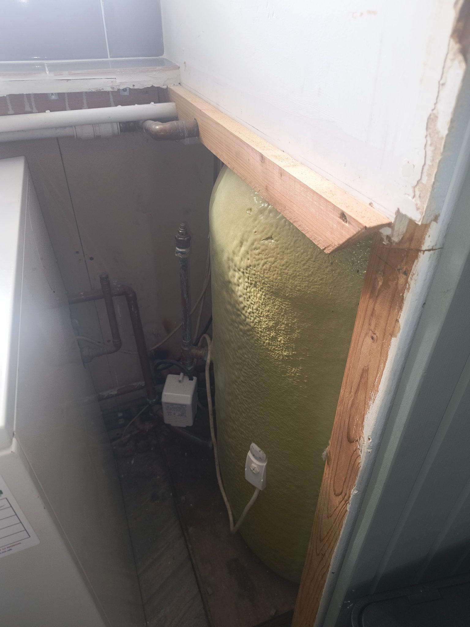

My brother lives in Scotland in a former farmhouse.
Old floor standing heat only boiler that appears to run well. There's a copper cylinder in a cupboard next to it, I think at about worktop height

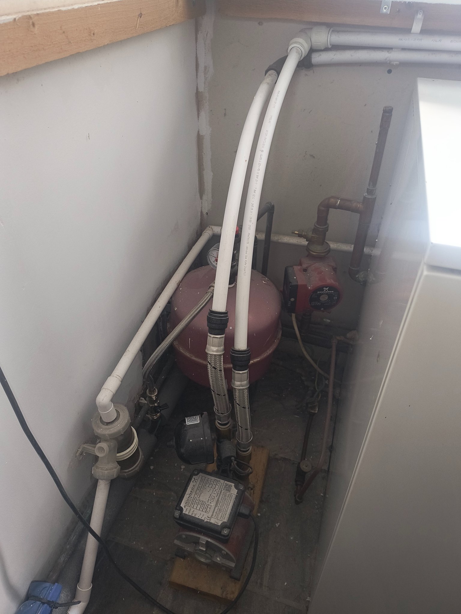

Two bathrooms, both with electric showers, downstairs has a bath. We used the first floor bathroom when we stayed and the shower wouldn't heat when the dishwasher was running so presumably poor pressure? The hot to the upstairs basin was (badly) pumped - would the rest of it be? I think they bought one of those Argos bath tap showers for downstairs but it didn't work so maybe the ground floor is just gravity?
Is there a cold water storage tank (CWST)? Most likely in the loft.
Is the system fully pumped on the primary side, or gravity to the HW cylinder? Are there any motorised valves?

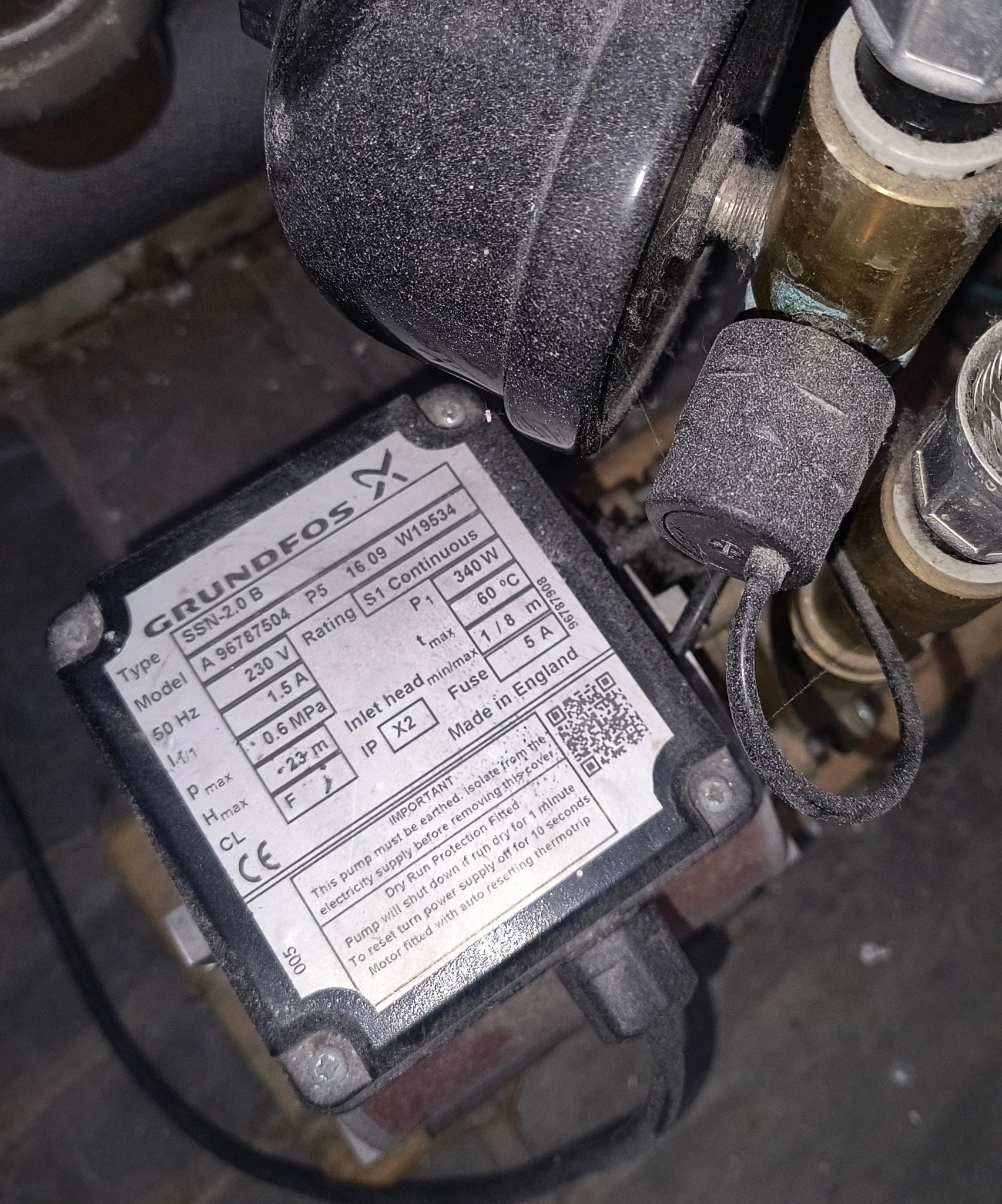

The pump would be on the secondary side. Whether the rest is pumped depends on where the pump is.
A sketch of the system would be useful
